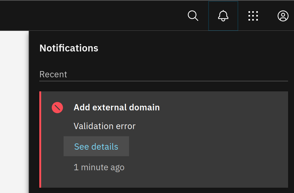

When trying to add the samba domain of a second NS8, i get the “invalid tls-certificate” error, even when i disabled verify tls. Dis someone experienced this too? Any ideas? Or is it a already known bug?
No, I can’t reproduce the issue. It’s working here, when TLS verify is disabled.
Please check the error notification or the logs for more details about the error:
