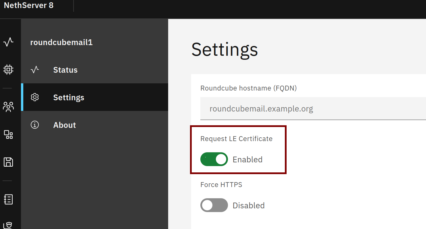

In the guide you sent me, it is not clear to me how to request a correct certificate from the app.
For example the mail app just obtains a certificate if possible, other apps provide a switch to enable Letsencrypt in the app settings.
