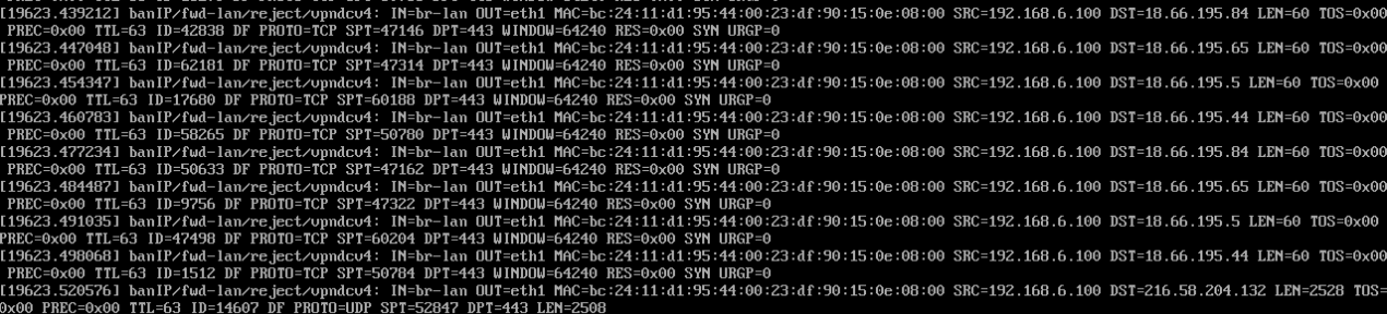

This is what i see on the console of the VM:

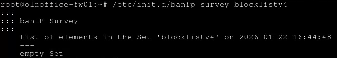

Is there a banned IP?
It seems that 192.168.6.100 is banned and therefore blocked from accessing the NethSec/web.

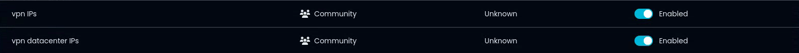

It seems you enabled the blocklist feed “vpn datacenter IPs”. (vpndcv4)
Please try to disable it and check if it works again.

I can reproduce the log entries on console when the feed “vpn datacenter IPs” is enabled.

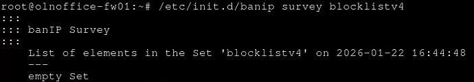

No there is not.
Yes i have enabled it:
But why still blocking the traffic to the lan host even if the ip is not banned?
If i disable the list “vpn datacenter IPs” host lan is able to ping google dns 8.8.8.8 if i enable it no.
The feeds are there to block traffic from/to known IPs.
See GitHub - X4BNet/lists_vpn: Lists of VPN providers (automatically updated) for more info about that feed.

It contains the networks that are in your screenshot, see lists_vpn/ipv4.txt at main · X4BNet/lists_vpn · GitHub
Traffic to those VPN networks is blocked.
It doesn’t need to match with your LAN network.
Ok i get it but how it is possible the both of the host lan has been blocked by the banip module with that blocklist “vpndcv4”? And as i said before one of them is a fresh arch linux installation without any program.
Anyway i think is not normal that the host is not showing in the Ban list.
AFAIK the ban list only shows hosts that are actively banned due to for example trying a brute force attack.
Ok but remain the fact that how both of the host has been blocked?Off course if i disable that list host can navigate to the internet.
The list could have wrong IPs.
You could check which processes on the devices want to reach that IPs:
ss -p | grep 18.66.195
