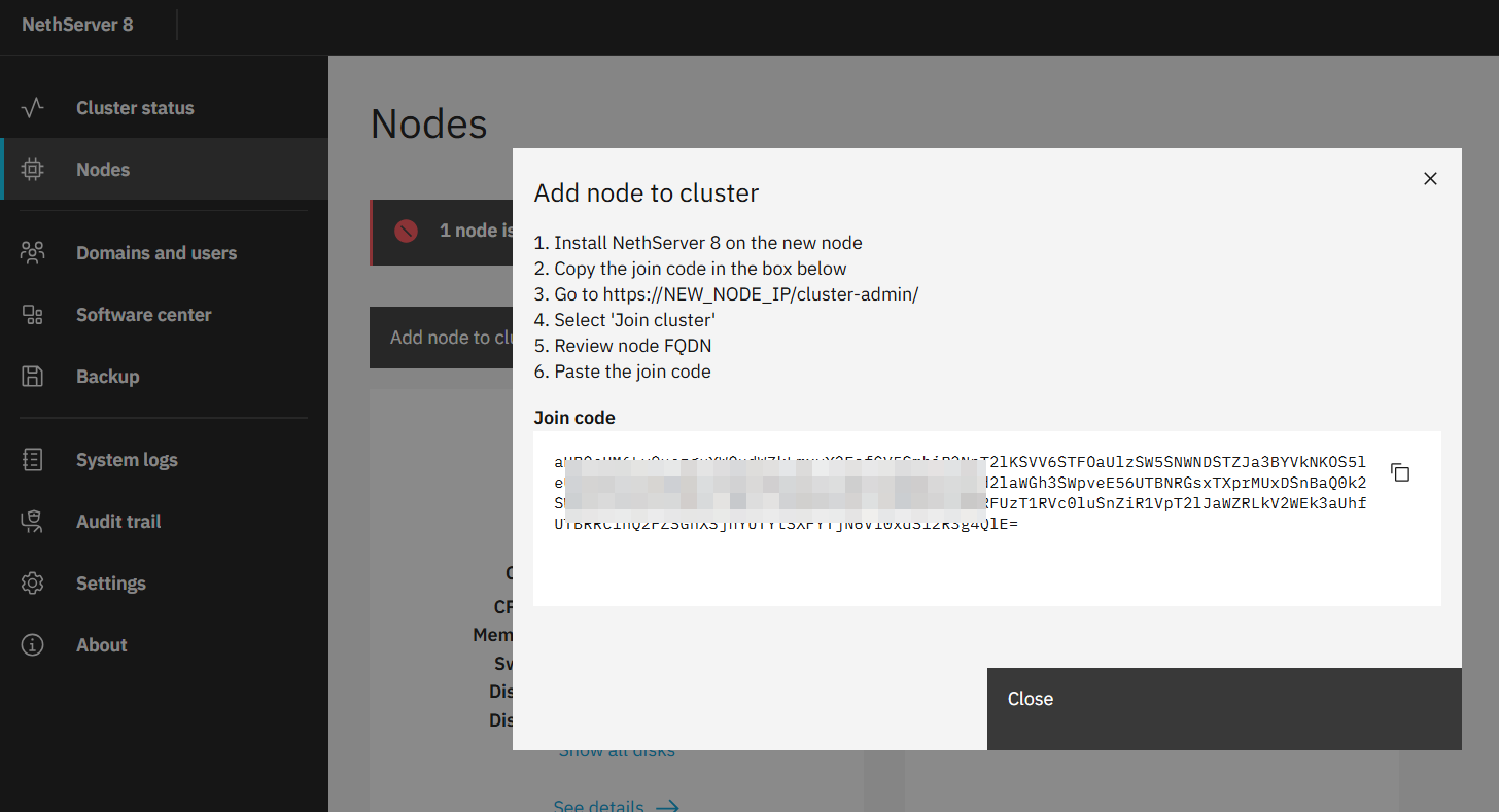

https://docs.nethserver.org/projects/ns8/en/latest/cluster.html#add-a-node

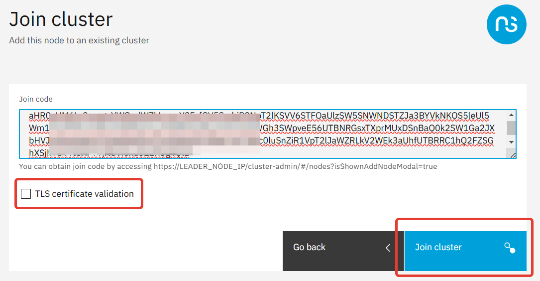

To disable the TLS certification validation option before clicking the join button.

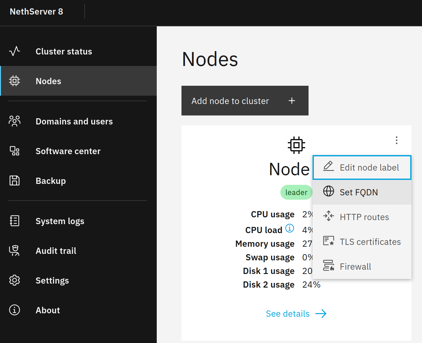

The name in /etc/hosts should match the result of hostname -f and the DNS entry on the DNS server.
Please try to set just one FQDN for the leader that can be resolved by DNS.

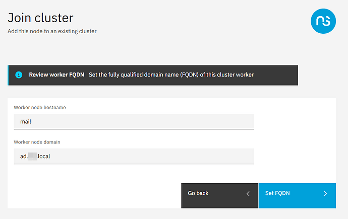

You can change the FQDN at the nodes page.

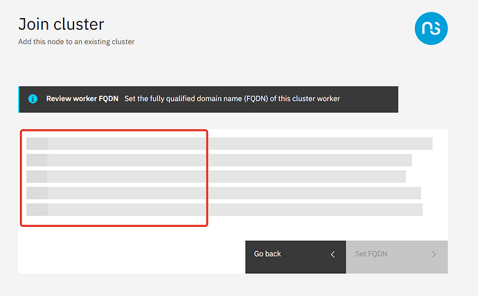

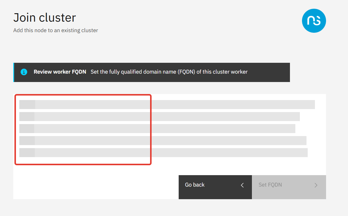

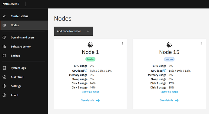

Made one FQDN for the leader and add MAIL to cluster:

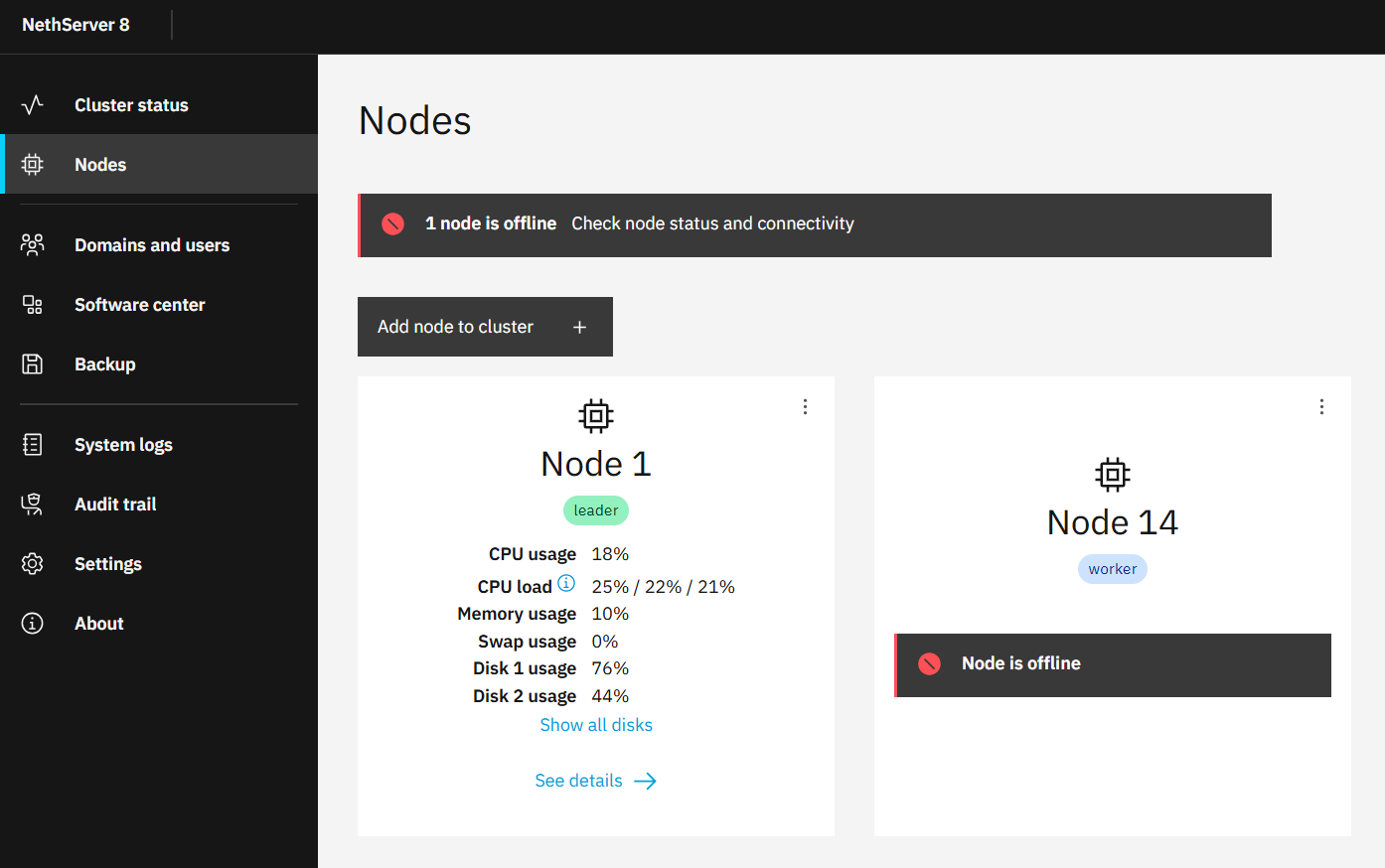

On the NS8 leader:
On the MAIL node, when entering the web user interface there is an endless refresh:
