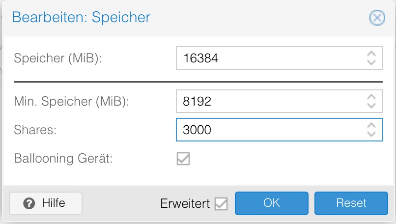

If not allocating all RAM (You’re allocating a min of 8 GB and a max of 16 GB RAM in the screenshot, that’s the same I use for a hotel in Zug BTW…) you can “weight” (prioritise) the allocation using said Shares setting in the RAM Config of Proxmox for each VM.
Default is 1000.
If you have 8 Machines running with the same settings, the server would need 128 GB RAM just for the VMs. If you have less, then Memory Balloning comes into play.
I allocate virtual servers generally 3000 shares, VM workstations stay at the default 1000.
ok, that was just for starter. I want to adjust, so thanks for info.

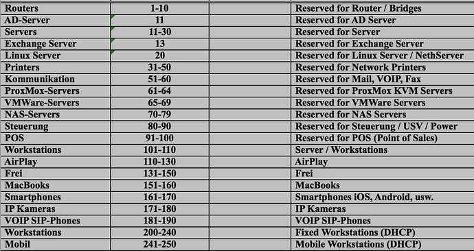

Normally, i plan networks using “Schema F”, and that looks like this:
Here, your NethServer is your Router / Gateway for other boxes/hosts, so it gets the IP 1.
I always use IP 1 as the “Default Gateway” in any networks i build / plan.
The “Default Gateway” is the next hop toward the internet (Nächste IP Sprung auf dem Weg zum Internet). This is defined by TCP/IP.
Normally, I’d have a dedicated Firewall (That would use IP 1), the NethServer as first UNIX/Linux Server would use IP 20. The AD would use IP 11 (As first Windows!), the windows box would then be 12 or 13…
