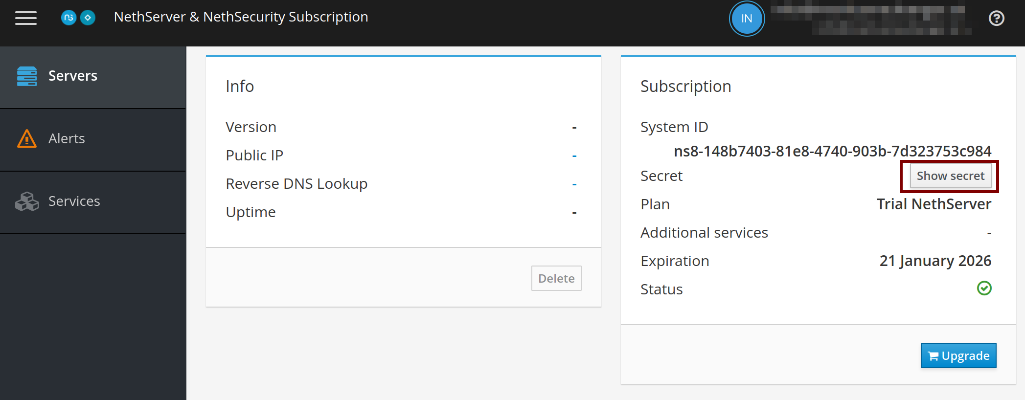

On my.nethserver.com/servers, my Trial NethServer is shown as expired, but on
Settings/Subscription on my cluster controller, the subscription is shown as active and expires next month.

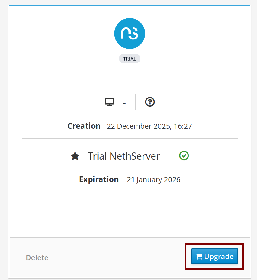

You can get a paid subscription by upgrading the trial subscription in the my.nethserver.com subscription portal via the “Upgrade button”
If something went wrong, you can ask the support, see also How to renew a subscription? - #5 by mrmarkuz

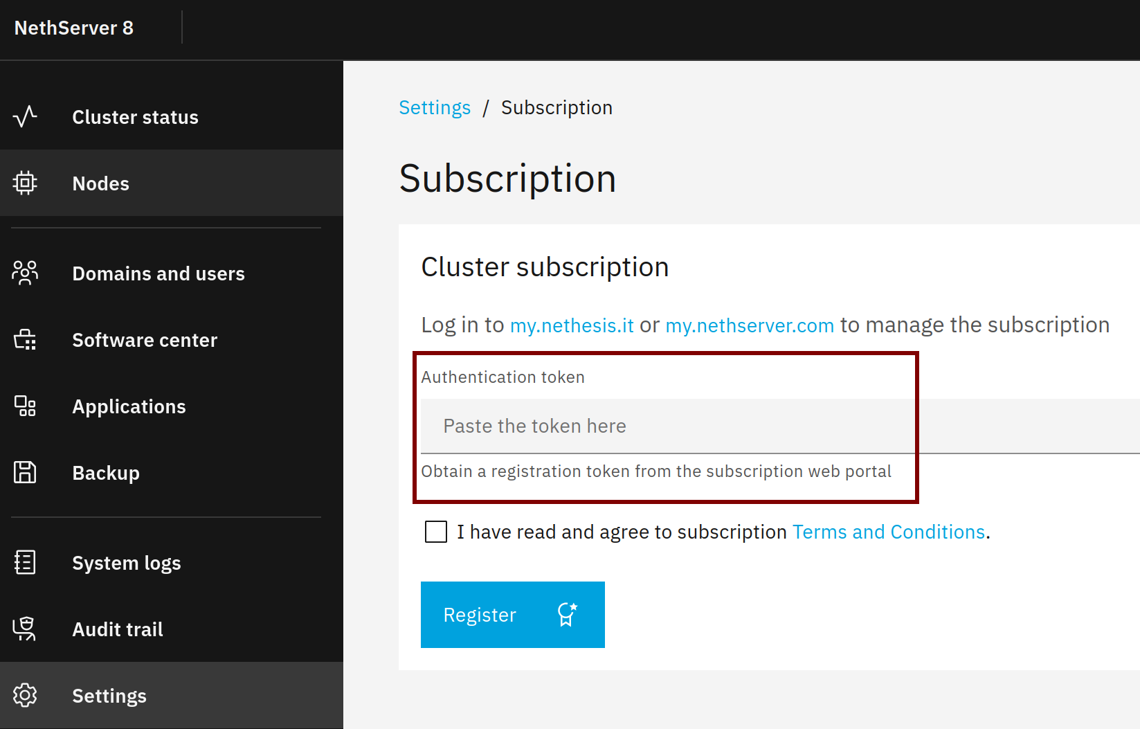

I don’t have the subscription on my.nethservers.com. Shall I remove the subscription from the cluster and start over?
Currently on the cluster controller, the subscription is:
Cluster subscription
Log in to my.nethesis.it or my.nethserver.com to manage the subscription
System IDns8-9d59fe1f-d531-409d-ae57-6248a1ed405e
PlanTrial NethServer (30 Day Trial)
Expiration2026-01-11
Status
Active
But it’s not online.
I forgot to mention that this is now an active, running email system, and I don’t want to take the system down, or lose any informaiton.
You can safely remove the subscription from an NS8 system without loosing any info or taking the system down.
Only if you’re using NethSec controller or NethVoice, some features won’t work anymore.
You can get the token/secret from my.nethserver.org
…and enter it on your NS8 to enable the subscription:
