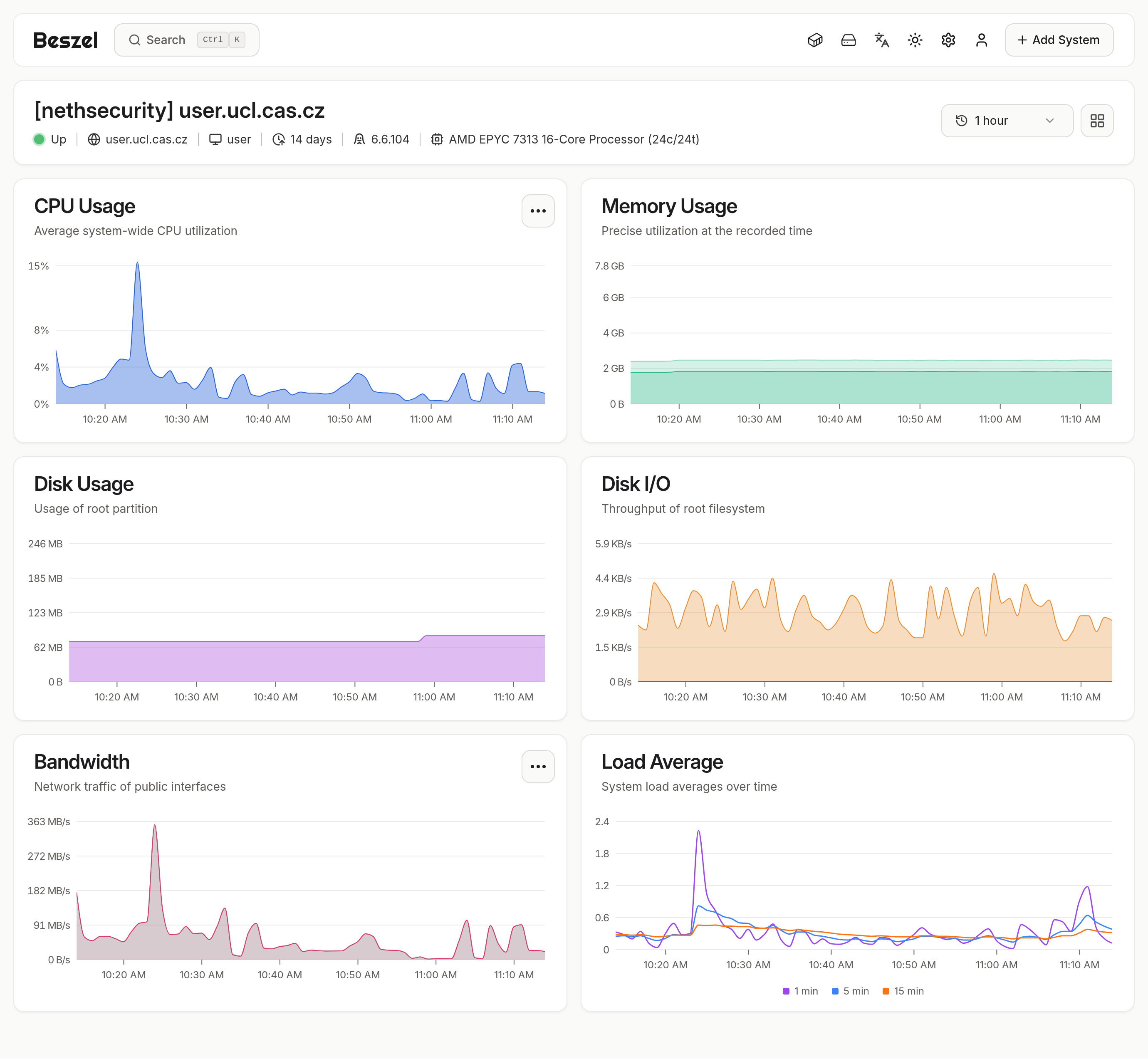

Beszel monitoring agent:
This is duplicitous to Netdata monitoring. We went from Zabbix to Netdata and now we are using Beszel for a time and we like it for the simplicity. We are using Beszel for firewalls, VM’s, containers, bare metal and hypervisors.
The installation is simple: In the BesZel UI - Add system → Binary → Copy Linux command and execute in the Nethsecurity terminal. After major upgrade you have to reinstall the agent (Edit system → and copy the relevant command for the system, and execute again…).
I think, there is no need for special support of Beszel agent. The need of reinstall after major upgrade is inconvenient, but this is the same for any extra packages…

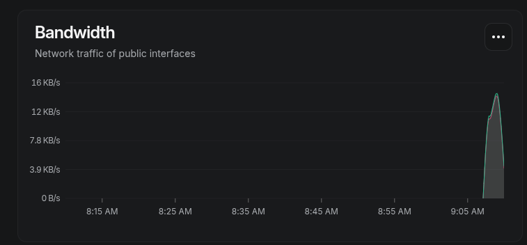

I see in the Bandwith Metrics that show me only one interfaces? Is not possibile tho have the bandwidth on all the available interfaces?
at this time it can show and monitor (send alerts) only for one public interface (WAN)
On most firewalls the LAN traffic is the same as WAN just with reverse TX and RX…
exceptions are a local server on the firewall or bridged interfaces serving as a switch…
(i don’t use any of the above)
You are right i agree with you.
