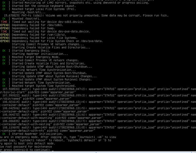

The server was crashed. It’s a proxmox server.
I rebooted, it started (still in degraded mode, expected), but minutes later crashed again.
Now it starts in maintenance mode only :frowning:
boot messages :
And a minute later :
Does it ring a bell ?
Thanks :grimacing:

Now why did md4 broke during the crash ? No idea. The config file was ok. All I had to do is
mdadm --start /dev/md4
 mdadm --readwrite /dev/md4
mdadm -A /dev/md4 /dev/sdb4
And then it started the recovery and that was all.
