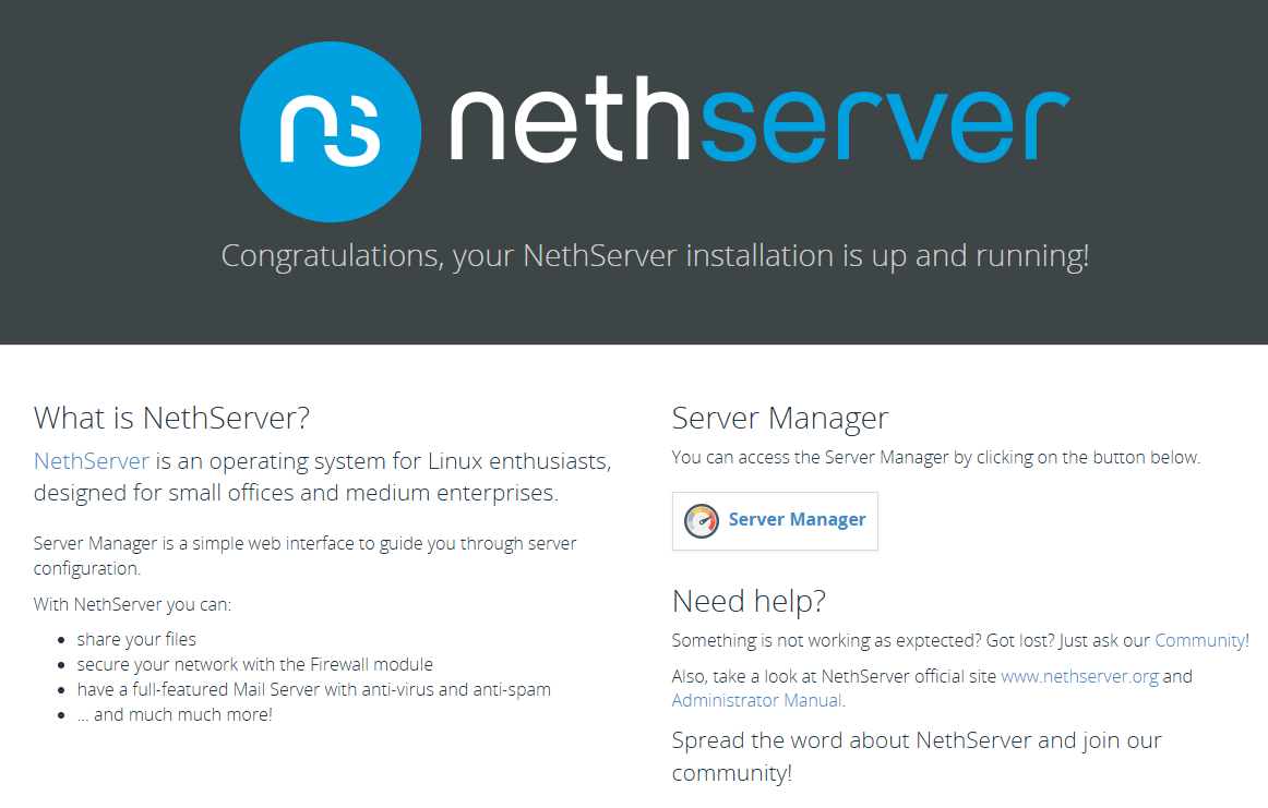

I am having trouble connecting to NethServer via VPN.
The client’s main LAN is 192.168.2.1/24.
The IP pool used by the VPN is 192.168.3.1/24.
I can access NethServer via the web interface (see photo) but not via SMB; why is that?
