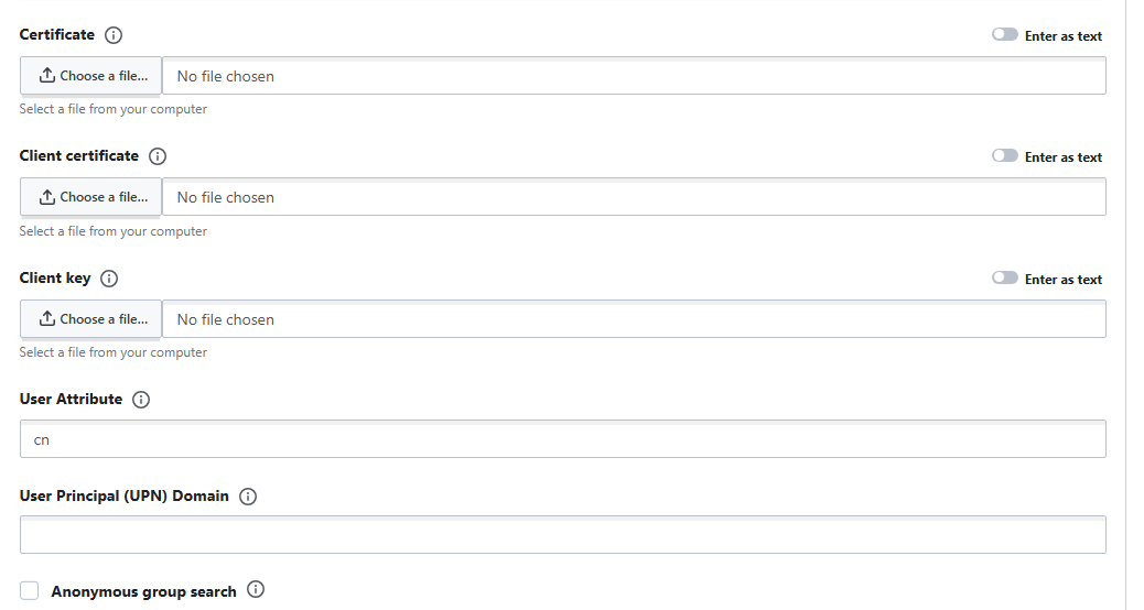

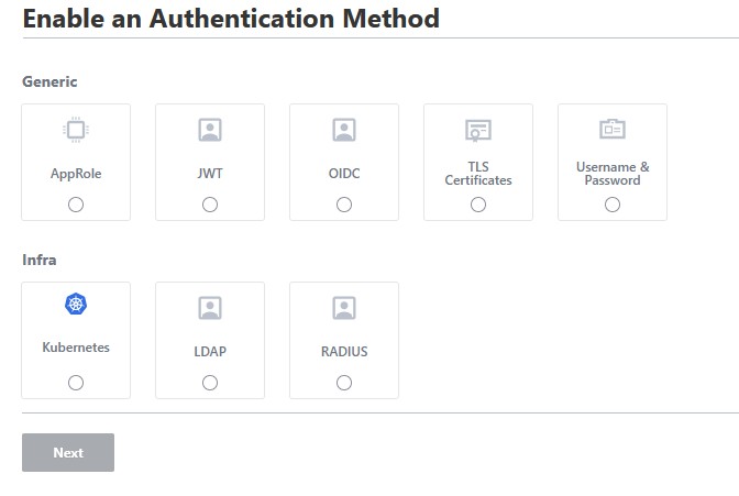

I can log in here right away with the root token. No need to go through unseal. However, I don’t think it’s not very secure that the root token and the Unseal key can be seen in the system log of the NS 8 application. I’ve got as far as the point where I find a selection menu under Authentication Method and can select LDAP there. However, I can’t get to grips with the multitude of possible settings.

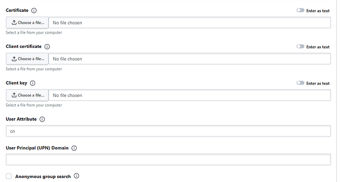

@transocean can you update the App, and try adding Ldap provider manually please, then let me know how it goes.
Whatever settings that work or fail, share here for reference…
@mrmarkuz do you think manual config wil work without these
I think it should work without certs but I don’t know.
Unfortunately, I can’t help at the moment. When I try to open the app, I only get a ‘Bad Gateway’ message.
