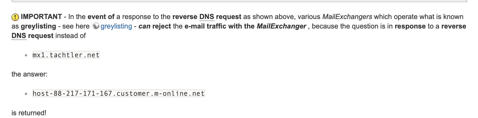

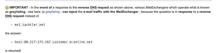

Now I read a postix documentation (Google translated) where it is recommended that PTR and MX record should be identical to prevent gray lisiting.
Do I need to change my configuration?
Or is the recommendation based on the fact that the doc refers to a local server?
