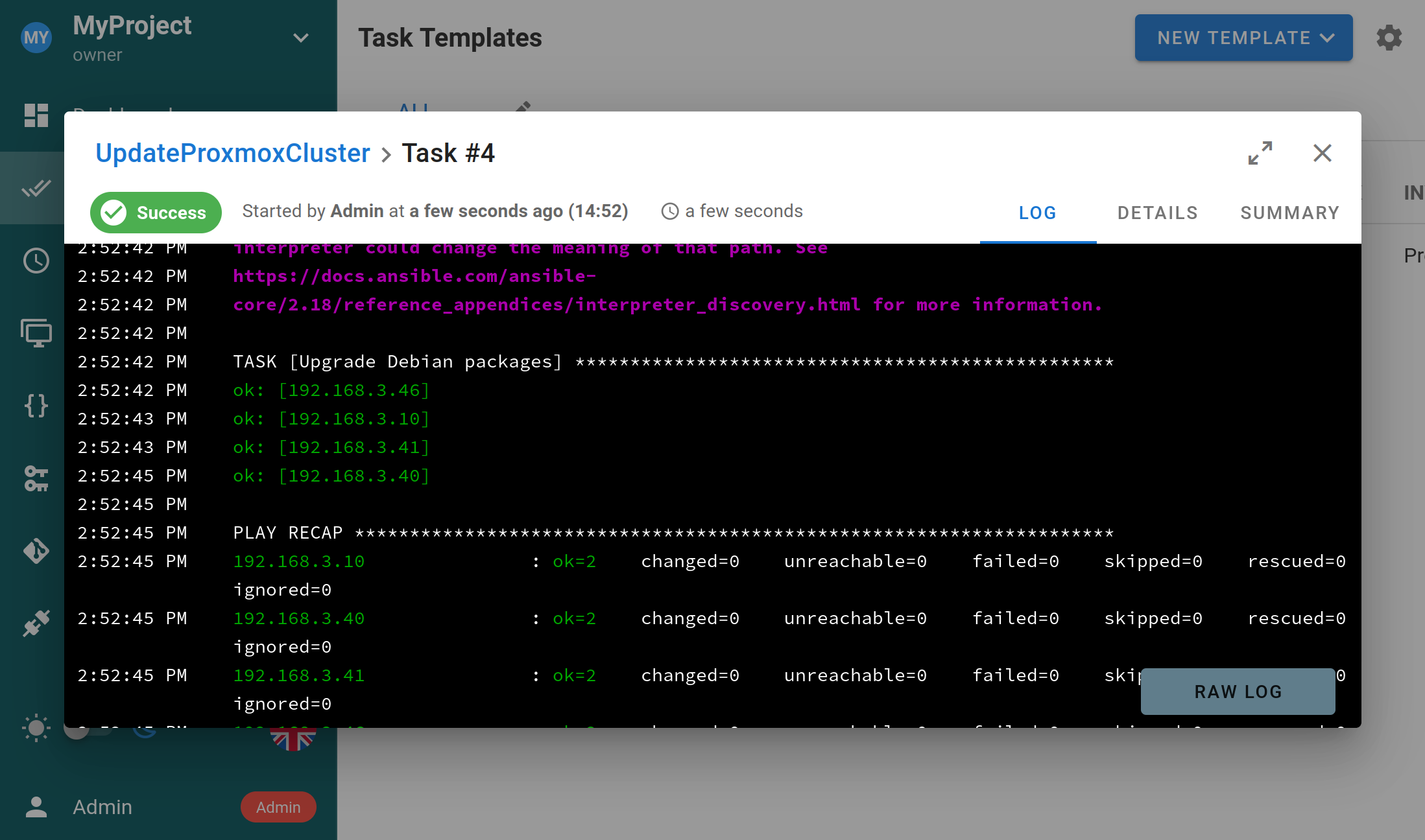

SemaphoreUI: Command Automation UI for Ansible, Terraform, OpenTofu, Bash,Pulumi
Alot of Members in this community as Server and System Administrators, Who spend large amount of time automating servers, and building Automation scripts for their Infrastructures.
For those of You Using Nethserver, as well as managing Ansible, Terraform and other scopes of Serves, am happy to Announce you can use SempahoreUI in your Nethserver to help you with that.

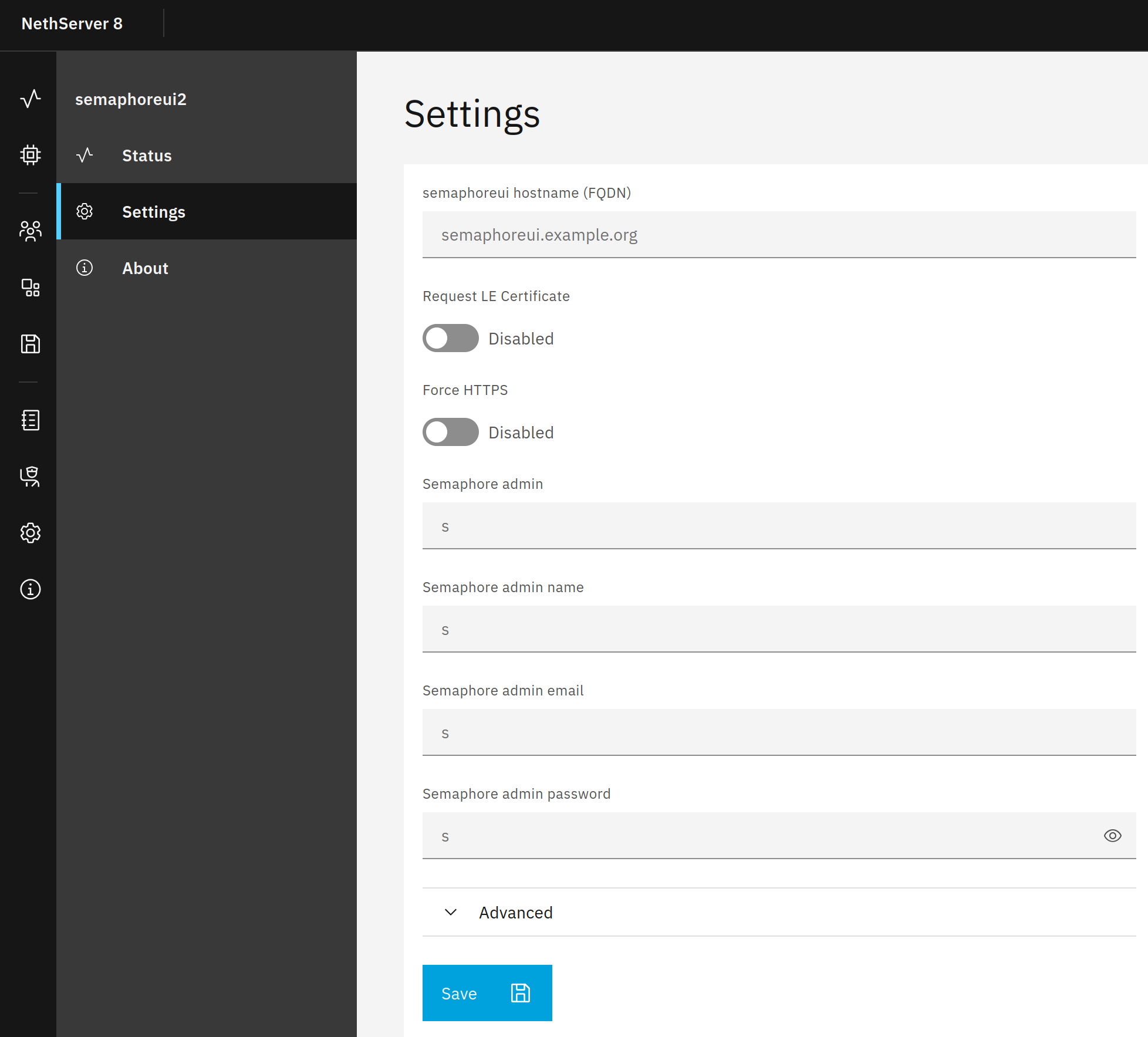

You could change the placeholders to show something helpful instead of “s”
The data isn’t shown correctly in the UI.
The variables in configure-module (ns8-semaphoreui/imageroot/actions/configure-module/10configure_environment_vars at main · geniusdynamics/ns8-semaphoreui · GitHub) need to be defined in get-configuration (ns8-semaphoreui/imageroot/actions/get-configuration/20read at main · geniusdynamics/ns8-semaphoreui · GitHub) too.

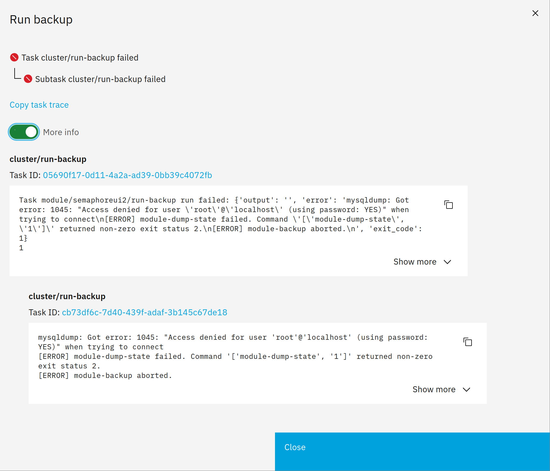

The backup didn’t work, maybe you need to add the right env file to ns8-semaphoreui/imageroot/bin/module-dump-state at main · geniusdynamics/ns8-semaphoreui · GitHub

Kindly help me test backup restore, i beleive its fully implemented, so that if it works, we release this fully for UI installs and Updates
I tested it, It didn’t work due to wrong mariadb credentials.
Seen the culprit, Kindly Update with the same commands above form dev branch

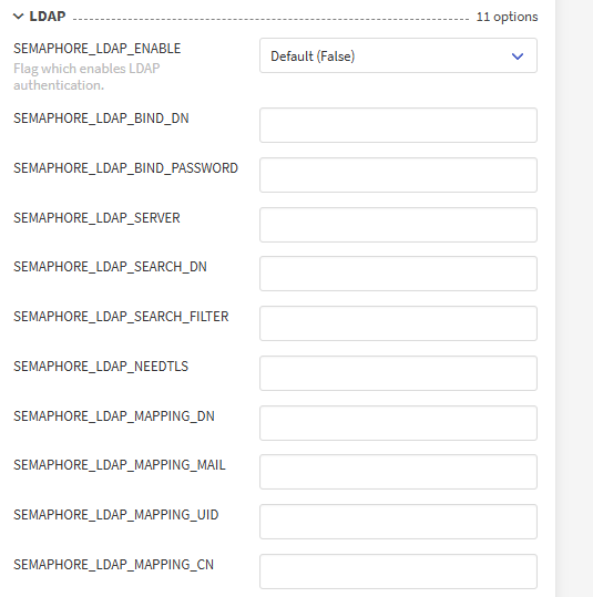

I have implemented Ldap however i a unable to login when connected, we get the error
2025-07-15T13:49:18+03:00 [1:semaphoreui5:semaphoreui-app] time="2025-07-15T10:49:18Z" level=warning msg="LDAP Result Code 200 \"Network Error\": dial tcp: missing address"
2025-07-15T13:49:28+03:00 [1:semaphoreui5:semaphoreui-app] time="2025-07-15T10:49:28Z" level=warning msg="LDAP Result Code 200 \"Network Error\": dial tcp: missing address"
Without Choosing Ldap, should Work as well, however for some reasons, unless cache issues, i am getting invalid password.

It’s now running here without ldap. The LDAP proxy is at 10.0.2.2 instead of
127.0.0.1.

MOst of the Issues, as well as volumes etc, have been resolved and fixed, the App should now be ain a stable State.
We have Implemented ldap, and hiddend it in the Advanced sections, however its its Functional yet, and choosing it might break, Unless you need to test and provide feedback.
We tried adding adn forcing 10.0.22 however for reasons best know to software, we still get 127.0.0 errors, and the login breaks when enabled…
Ill focus on the Other Apps and Tools, and get back to the ldap Issue on this One later…
