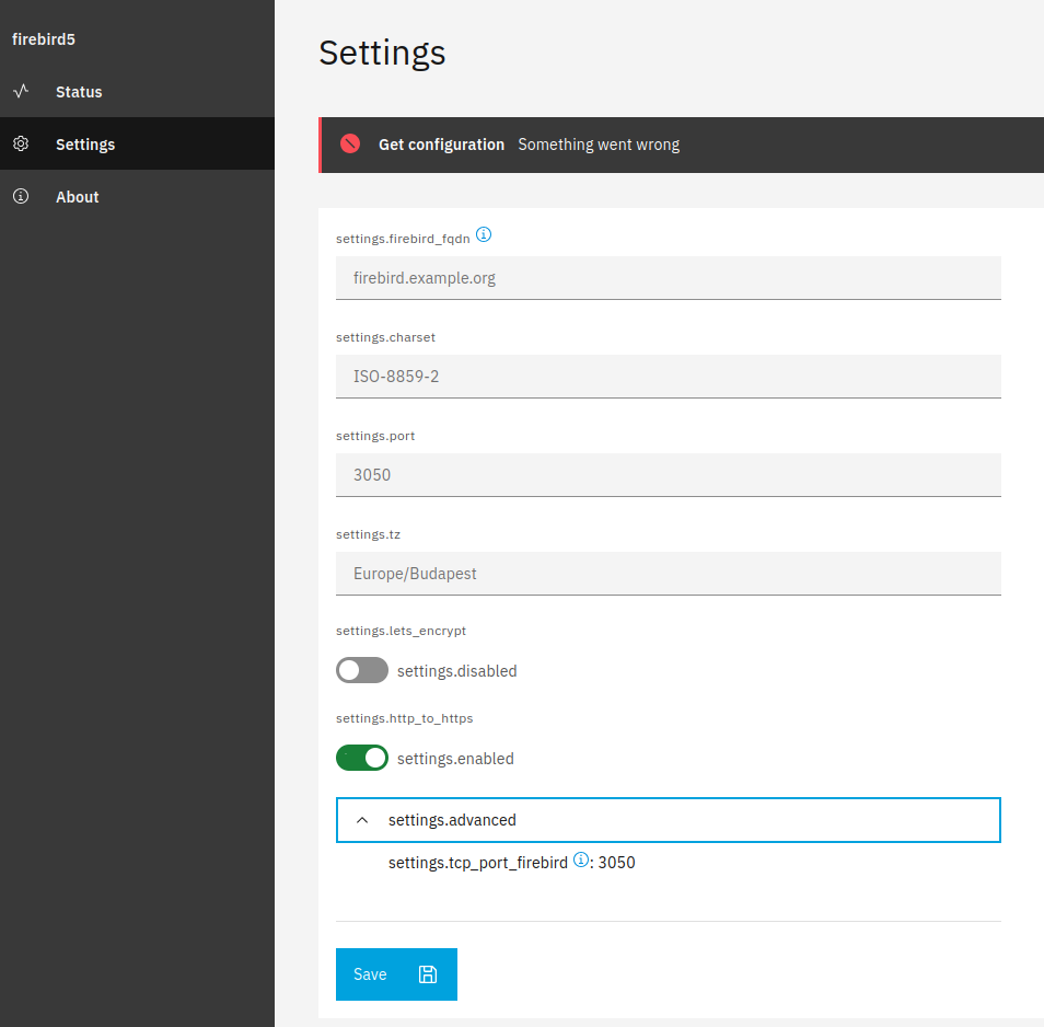

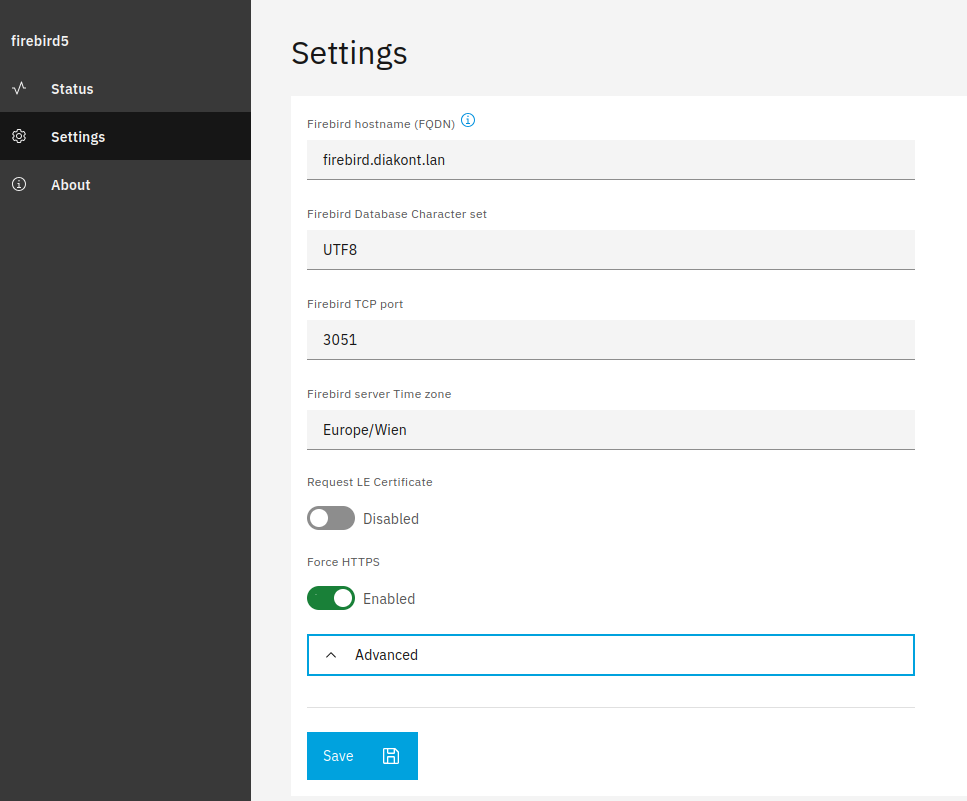

This is what Firebird Settings looks like now.
I need to test if the settings changes are reflected in the environment and work.
Can anyone help me with this?
I think you need to use True or False in Python instead uppercase as I found here, see Python Booleans
To test, click save in the settings and check if the variables are set correctly in the /home/firebird1/.config/state/environment file.
Open the settings and check if the fields are prefilled with what you entered before.

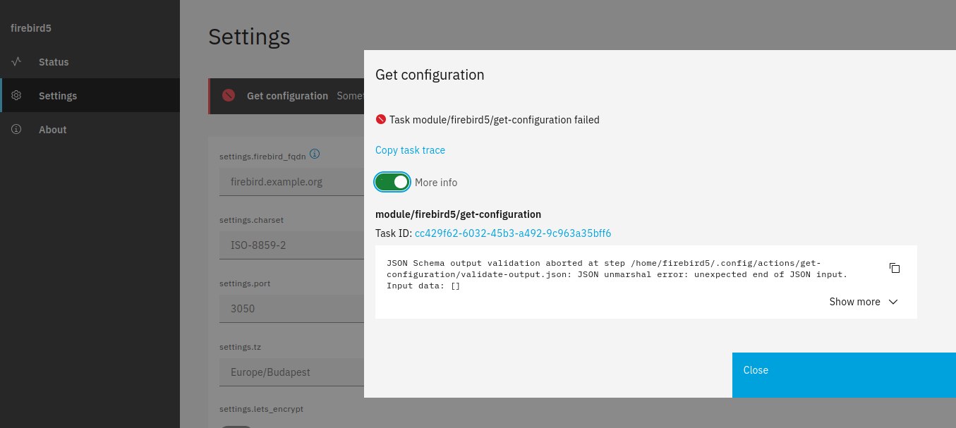

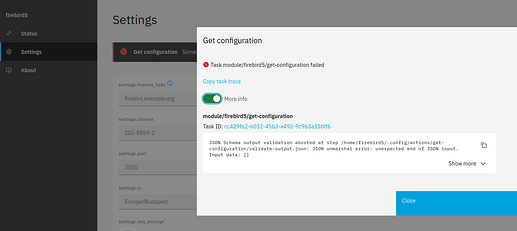

I made some changes to the validation-output files in the configure-module and get-configure directories.

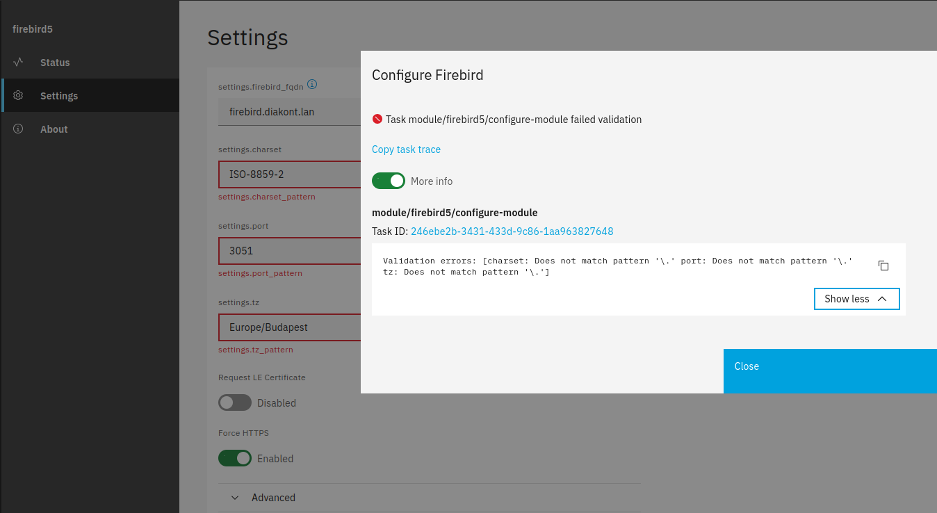

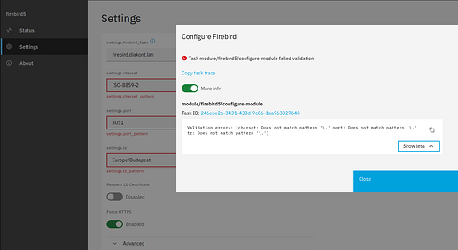

Unfortunately, it does not solve the problem, because after updating, the error shown in the image appears.
When I try to change the Settings I get a “Does not match pattern” error message for setting charset, port and tz, similar to the one below.
I’m working on it, looking for the cause of the problem, but I haven’t found it yet…
I also don’t understand why settings.firebird_fqdn, settings.charset, settings.port, settings.tz appear on the page in the settings.

Just remove the validate-input.json file in the meanwhile. You could setup the validation later. Every field needs a correct validation and the pattern \\. doesn’t work for all fields.
Because the translation is missing in ns8-firebird/ui/public/i18n/en/translation.json at main · sipi58/ns8-firebird · GitHub
I removed the validation-input and validation-output files for testing. I entered different data than what was in the environment file and saved it. The save was successful message appeared on the screen, but the environment file was not changed.
I modified the translation file but it has no effect on the display, the Setting page has not changed. Should I check the settings of some variable?
I found that your actions scripts are not executable and therefore don’t run.

I’m starting to understand the modifications and suggestions you made, and they work. The validity check has now been removed from the package, but it will need to be put back in at the end.

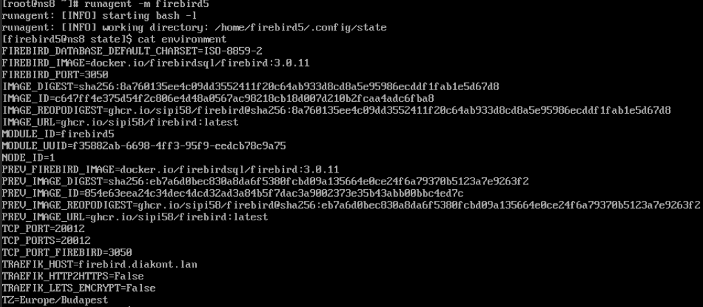

After the update, the values set on the Settings page will appear in the environment file. The image shows the settings, below is the content of the environment file:
[firebird5@ns8 state]$ cat environment
FIREBIRD_DATABASE_DEFAULT_CHARSET=UTF8
FIREBIRD_IMAGE=docker.io/firebirdsql/firebird:3.0.11
FIREBIRD_PORT=3050
IMAGE_DIGEST=sha256:c44ee1edc4d46512485393a9c562ee1ecfb0c9faefc00399a1ddc42fcf72ef64
IMAGE_ID=a1cd16757411f027ea2baf3dab41c1a426d9bca152a499b2b310b1c8b0921292
IMAGE_REOPODIGEST=ghcr.io/sipi58/firebird@sha256:c44ee1edc4d46512485393a9c562ee1ecfb0c9faefc00399a1ddc42fcf72ef64
IMAGE_URL=ghcr.io/sipi58/firebird:latest
MODULE_ID=firebird5
MODULE_UUID=f35882ab-6698-4ff3-95f9-eedcb78c9a75
NODE_ID=1
PREV_FIREBIRD_IMAGE=docker.io/firebirdsql/firebird:3.0.11
PREV_IMAGE_DIGEST=sha256:23d3caa4432932eb4b80100bc979c42601b8c8fda87852f50e568f16c1be6486
PREV_IMAGE_ID=de25acef91614fa1426b6ddc73f675642a148fa14d0118e091d0400666d30d45
PREV_IMAGE_REOPODIGEST=ghcr.io/sipi58/firebird@sha256:23d3caa4432932eb4b80100bc979c42601b8c8fda87852f50e568f16c1be6486
PREV_IMAGE_URL=ghcr.io/sipi58/firebird:latest
TCP_PORT=20012
TCP_PORTS=20012
TCP_PORT_FIREBIRD=3051
TRAEFIK_HOST=firebird.diakont.lan
TRAEFIK_HTTP2HTTPS=True
TRAEFIK_LETS_ENCRYPT=False
TZ=Europe/Wien
But I messed something up because there is a FIREBIRD_PORT=3050 and a TCP_PORT_FIREBIRD=3051 and TCP_PORT=20012 and TCP_PORTS=20012 are the same.

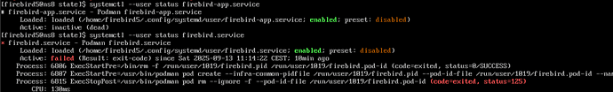

Firebird won’t start, when I check it the following appears:

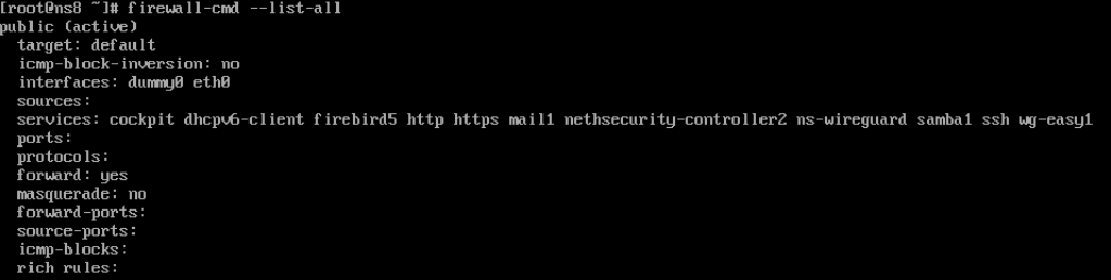

The following ports are open on the firewall:
I wonder why there are so many ports open on the firewall, but I think in the end I will have to set it so that only the WG VPN port is openfor security reasons…
It seems that the firebird5 port is open on the firewall, but in the Settings module the port field is empty, only the suggested 3050 is dimly visible. I type 3050 in the port field and save, but the error message below appears.

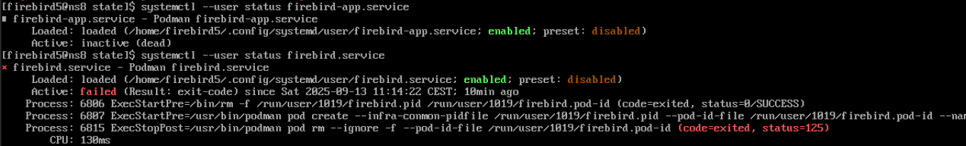

Firebird cannot start due to an error, this image appears after starting:

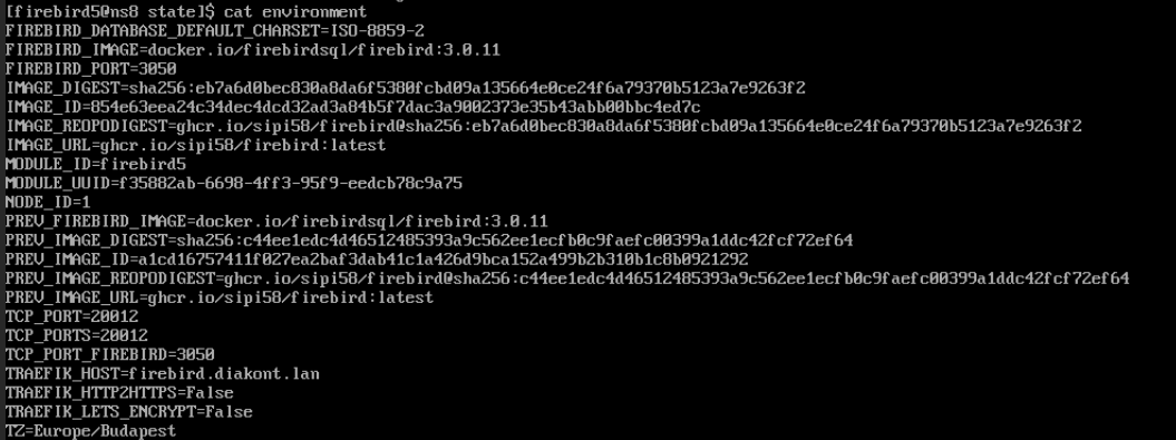

The environment file contains the following:
Interestingly, although it has been modified, the values ​​TCP_PORT, TCP_PORTS, TCP_PORT_FIREBIRD are still included in the environment.
I restarted NS8 but nothing changed, Firebird still won’t start.

Just the ports that are needed by the apps are open.
To get more information about a service and it’s port you could use
firewall-cmd --info-service=firebird5

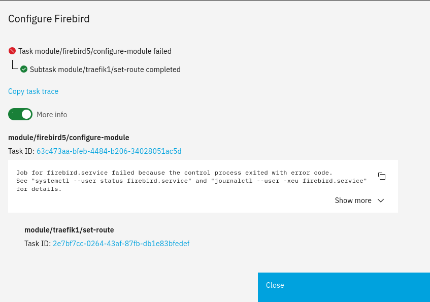

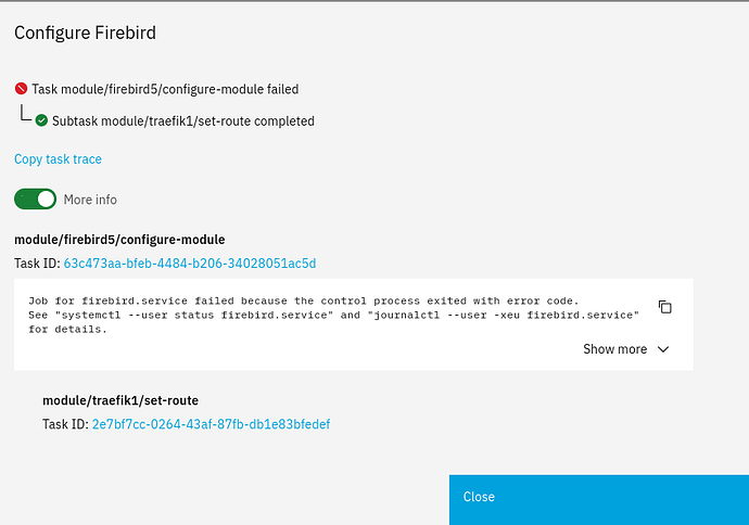

In the Firebird5 - Node 1 log I found the following:
2025-09-13T20:10:28+02:00 [1:firebird5:systemd] Starting Podman firebird.service...
2025-09-13T20:10:28+02:00 [1:firebird5:podman] Error: cannot parse "${FIREBIRD_PORT" as an IP address
2025-09-13T20:10:28+02:00 [1:firebird5:systemd] firebird.service: Control process exited, code=exited, status=125/n/a
2025-09-13T20:10:28+02:00 [1:firebird5:podman] Error: reading pod ID file: open /run/user/1019/firebird.pod-id: no such file or directory
2025-09-13T20:10:28+02:00 [1:firebird5:systemd] firebird.service: Failed with result 'exit-code'.
2025-09-13T20:10:28+02:00 [1:firebird5:systemd] Failed to start Podman firebird.service.
2025-09-13T20:10:28+02:00 [1:firebird5:systemd] Dependency failed for Podman firebird-app.service.
2025-09-13T20:10:28+02:00 [1:firebird5:systemd] firebird-app.service: Job firebird-app.service/start failed with result 'dependency'.
2025-09-13T20:10:28+02:00 [1:firebird5:systemd] firebird.service: Start request repeated too quickly.
2025-09-13T20:11:09+02:00 [1:firebird5:agent@firebird5] task/module/firebird5/d77e4ff0-a990-49eb-8cfd-cb54c72f90ee: get-status/20read is starting
2025-09-13T20:11:10+02:00 [1:firebird5:agent@firebird5] task/module/firebird5/d77e4ff0-a990-49eb-8cfd-cb54c72f90ee: action "get-status" status is "completed" (0) at step validate-output.json
There seems to be a problem with the ${FIREBIRD_PORT} variable.

There seems to be a missing } at the end.
Could you please share the output of following command: (content of the firebird service)
runagent -m firebird5 systemctl --user cat firebird --no-pager
Did you enable the TLS challenge on NS8 that’s needed for using port 443? Execute following command as is:
api-cli run module/traefik1/set-acme-server --data '{"challenge":"TLS-ALPN-01","url":"https://acme-v02.api.letsencrypt.org/directory"}'

[Unit]
Description=Podman firebird.service
Requires=firebird-app.service
Before=firebird-app.service
[Service]
Environment=PODMAN_SYSTEMD_UNIT=%n
EnvironmentFile=-%S/state/environment
Restart=always
TimeoutStopSec=70
ExecStartPre=/bin/rm -f %t/firebird.pid %t/firebird.pod-id
ExecStartPre=/usr/bin/podman pod create --infra-conmon-pidfile %t/firebird.pid \
--pod-id-file %t/firebird.pod-id \
--name firebird \
--publish ${FIREBIRD_PORT:-3050}:3050 \
--replace
ExecStart=/usr/bin/podman pod start --pod-id-file %t/firebird.pod-id
ExecStop=/usr/bin/podman pod stop --ignore --pod-id-file %t/firebird.pod-id -t 10
ExecStopPost=/usr/bin/podman pod rm --ignore -f --pod-id-file %t/firebird.pod-id
PIDFile=%t/firebird.pid
Type=forking
[Install]
WantedBy=default.target

Thank you for your help
This is wrong and I wonder why because it doesn’t exist in the code anymore, see ns8-firebird/imageroot/systemd/user/firebird.service at main · sipi58/ns8-firebird · GitHub
You could try to force the update once more: (just for development, don’t use it for usual app updates)
api-cli run update-module --data '{"module_url":"ghcr.io/sipi58/firebird:latest","instances":["firebird5"],"force":true}'
and if it doesn’t work, just change it in the service file:
runagent -m firebird5 systemctl --user edit --full firebird
It should be:
--publish ${FIREBIRD_PORT}:3050 \
Thank you very much, this manual editing helped, I didn’t have to reload the databases, edit security.fdb, etc. Firebird has started and I can connect to it from the local network and the databases are accessible with the client program.
Now comes the WG VPN, I don’t know how to set it up yet but I hope I can figure it out.
In the meantime, I make any settings on the Firebird module Setting page, it saves but the environment does not change. For example, I changed the port from 3050 to 3059 but it is still available on port 3050. I think the same is true with character encoding. Is this related to the previously disabled checks?
I don’t know why the update doesn’t work correctly.
I suspect that other files aren’t updated too.
Please post the output of following commands:
runagent -m firebird5 ls ../actions/configure-module
runagent -m firebird5 cat ../actions/configure-module/10configure_environment_vars
Please also share the output of the update command.
You could compare with Github and edit the files manually but usually the update should work.
