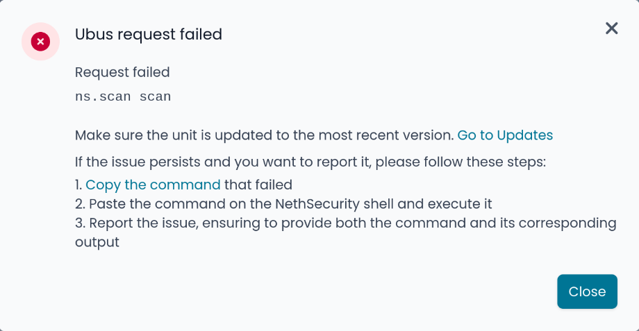

Hi, on a /16 subnet trying the UI feature Network → DNS and DHCP → Scan network
I get this error:
Cannot scan network
Something went wrong
AxiosError: Request failed with status code 504
command: echo ‘{“device”:“br-lan”}’ | /usr/libexec/rpcd/ns.scan call scan

Thank you for reporting!
Please follow the instructions on the dialog and past it here :wink:
