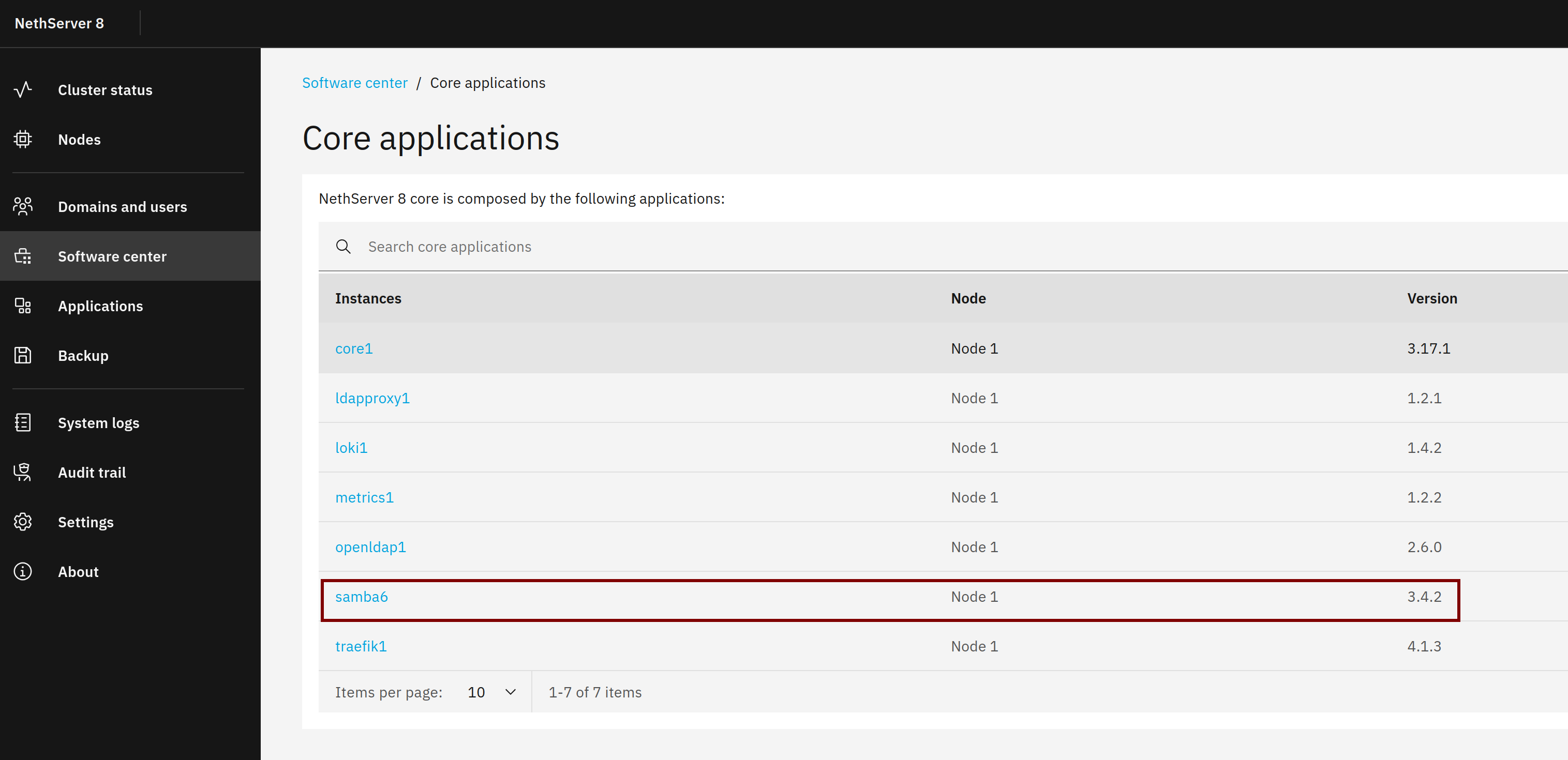

Which samba core app version is installed? You can check it in Software Center/Core applications.
With the upgrade to Samba 3.4.2 the certificate should be renewed automatically. Before the certificate was created on first start of samba and never renewed.
I couldn’t reproduce, even on a migrated system from NS7 the certificate was renewed.
Does it help to restart Samba?
runagent -m samba1 systemctl --user restart samba-dc
This error can be ignored and also occurs when the certficate is not expired.
I had still Samba 3.4.1, now upgraded to v3.4.2, and the certificate renewed automatically.
