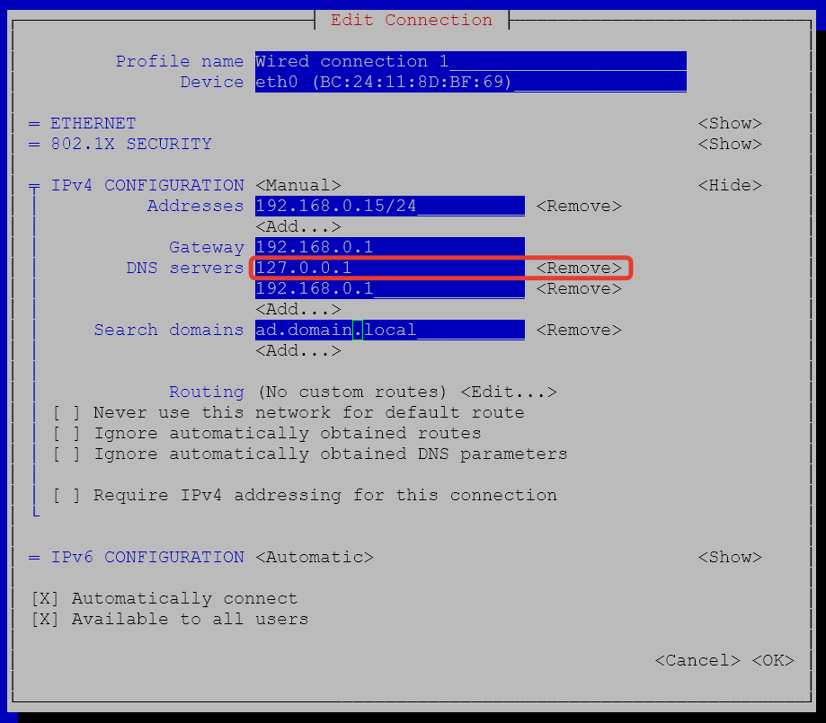

ansh
(ansh)
March 4, 2025, 5:09pm
8
Not resolved
The NS8 server reboot field shows the line
nameserver 127.0.0.1
in /etc/resolv.conf
On server
#cat /etc/resolv.conf
search domain.local
nameserver 192.168.0.1
After removing the line nameserver 127.0.0.1 and rebooting samba5
#runagent -m samba5 systemctl --user restart samba-dc
the processor load is normalized.

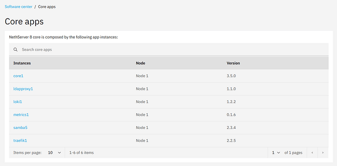

Updated Core apps, but the problem is still not solved. After rebooting NS8 Samba loads CPU at 100%.
search domain.local

mrmarkuz
(Markus Neuberger)
March 11, 2025, 9:40am
12
Please remove the nameserver 127.0.0.1 line and restart the samba-dc service.
Did you setup a static IP for the NS8?
ansh
(ansh)
March 11, 2025, 9:47am
13
mrmarkuz
(Markus Neuberger)
March 11, 2025, 9:49am
14
Please also remove 127.0.0.1 in nmtui, else it will reappear at next network restart.
