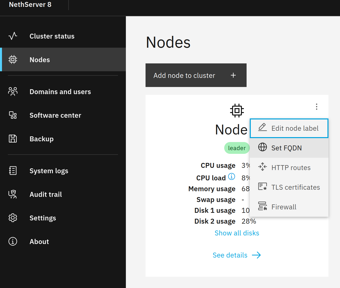

The rspamd http route just uses the path so I suspect that the node FQDN is wrong.
Please check your node FQDN:
hostname -f
You can change it on the nodes page:
