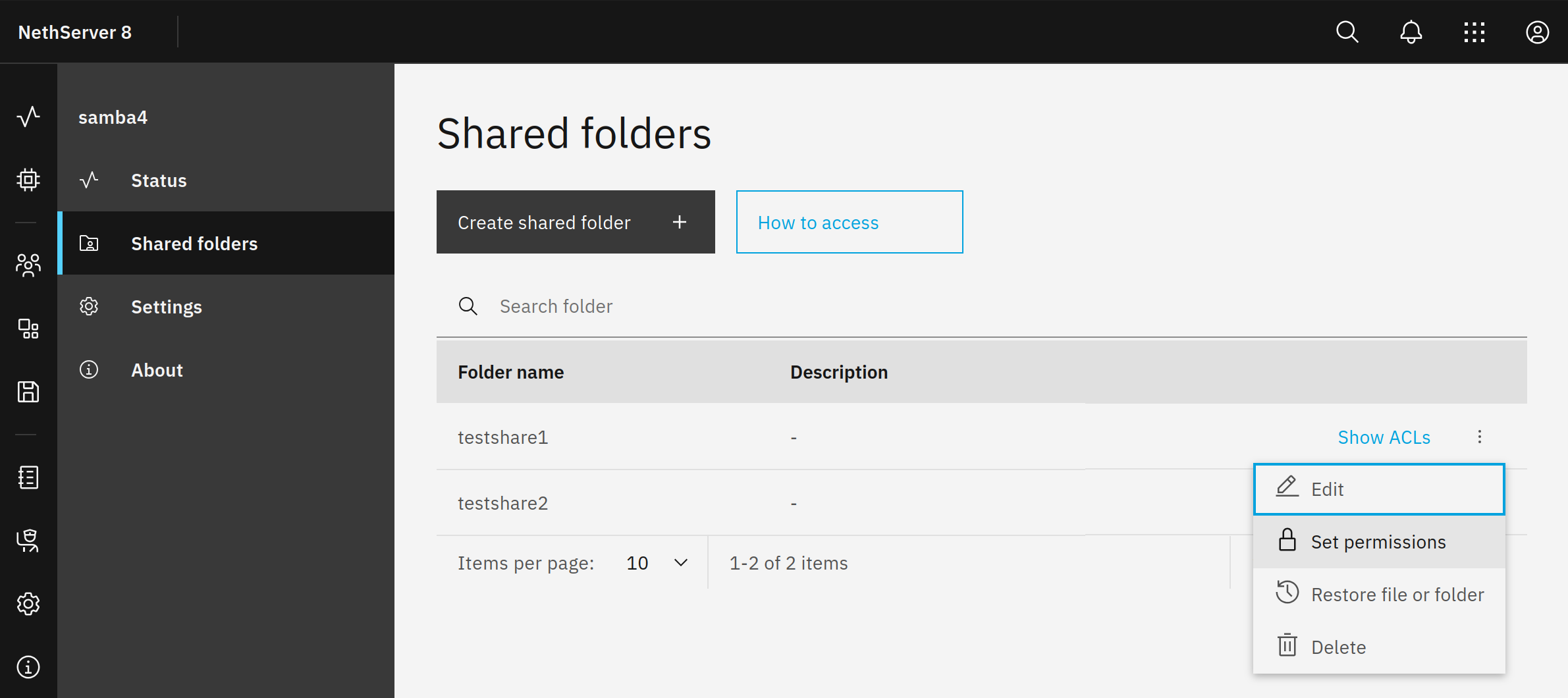

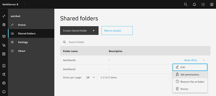

Maybe it’s enough to repair the permissions from the web UI:
