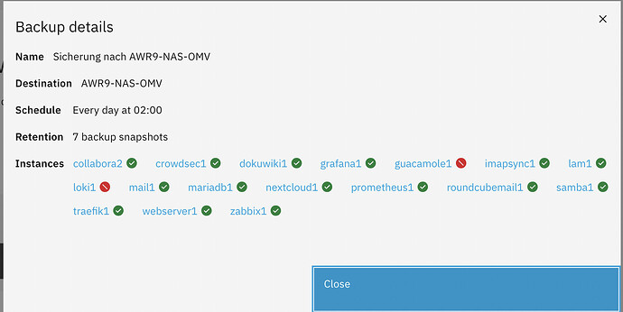

Restic Backup has been working for several months now, without any errors.
I now have an error with Restic Backup since 25.12.2024.
It seems that “loki1” has a lock set on that date which has never been removed.
This is extremly misleading especially considering no backup has actually been done since 5+ days…:
My System:
The error:
Log Details:
(AFAIK, this contains the exact error…)

Any ideas or suggestions to remove the lock file(s)?
@stephdl
I wanted a full backup before testing Webserver new installation…
