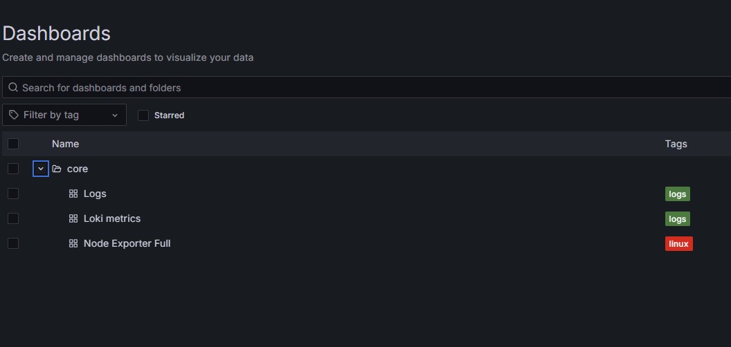

I have actived grafana but i don’t show “modules folder: it contains the default dashboards for the installed modules, like Samba Audit” ; i see only the core folder.

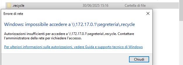

Furthermore the recycle bin folder is not accessible (i reset acl permission in shared folder).

As for the recycle bin I discovered that the folder is accessible only by the first person who deletes a file. After that only that user can access the folder and only the files deleted by him are put in the trash.
Thanks, you found a bug.
I could reproduce the recycle bin issue. Setting recycle:directory_mode = 0770 (the default is 0700) makes the recycle bin accessible for group users so they can also delete files and they’re sent to recycle bin.
But the deletion of the .recylce folder can still only be done from the initial creator of the recycle bin, which is the user that first deletes a file, even when we set directory_mode to 0777.
I need to check if there are better solutions.
I couldn’t reproduce the audit issue. After enabling Grafana I can see the Audit modules in the Dashboard.

Does it help to disable Grafana and enable it again?
Please check if the dashboard modules and datasources are there:
[root@node ~]# runagent -m metrics1 ls -l dashboards/modules/ datasources/

Please also check the (metrics) logs for errors.

When i set 0770 .recycle directory is all ok. All user view file and access to folder.
For grafana i disable and enable in dashbord but no solve problem.
The modules and datasources are missing:
[root@ns8 ~]# runagent -m metrics1 ls -l dashboards/modules/ datasources/

Try to re-run the dashboard setup command:
runagent -m samba1 ../actions/configure-module/80provision_metrics
Thanks for suggestion. it’s work.
the name of my samba is samba4
runagent -m samba4 ../actions/configure-module/80provision_metrics
