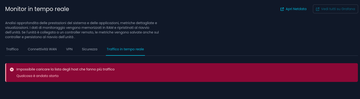

Hello NethSecurity Team,
I am writing to report a sudden issue with our unit that started approximately two hours ago. Specifically:
  1. The DPI-core module is showing an “Unknown” (Sconosciuto) status.
  2. In the “Real-time Monitor” section, I get the following error: “Unable to load the list of top traffic hosts. Something went wrong”.
I have already attempted to restore the system from a known working backup from a few days ago, but the issue persists. This leads me to believe the problem is not related to the local configuration (perhaps a signature update or a cloud sync issue).
Could you please investigate the cause and advise on how to resolve this?
I look forward to hearing from you. Best regards,

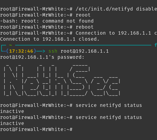

Understood. I have performed the test as requested following these steps:
  1. I disabled the service again using /etc/init.d/netifyd disable.
  2. I rebooted the firewall.
  3. After the reboot, I checked the status.
After the reboot, the service is back to “Unknown” status and is not running. It seems that on my unit, the “enabled” setting is still required for it to start.
Yes, you’re right. Sorry, it seems I didn’t really disable it in my test before.
It appears that on this specific build/configuration, the service does not start unless it is manually enabled. For now, I will run enable again to keep the monitoring active, but I look forward to your feedback on whether this behavior is expected.
I retested and the netifyd service stays enabled after the last netifyd update, just service netifyd enabled gives back another value but this can be ignored I guess.
When I disable the service manually, I can reproduce your issue.
