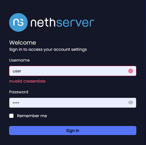

Update: I blame Safari. I opened up cluster-admin in Chrome, and I can access the config details…
I think so too. I will definitely set up a completely new VM after the release of the final version. Thanks to Proxmox, this can be done very quickly
Nevertheless, it is helpful to know why it doesn’t work for you. Unfortunately, I am not a Linux guru. Maybe @davidep would like to write a few words about it.
Unfortunately, Cupertino do not polish that much its own browser. More unfortunately, most of webapps works better with most diffused webrowser (unfortunately at cube)

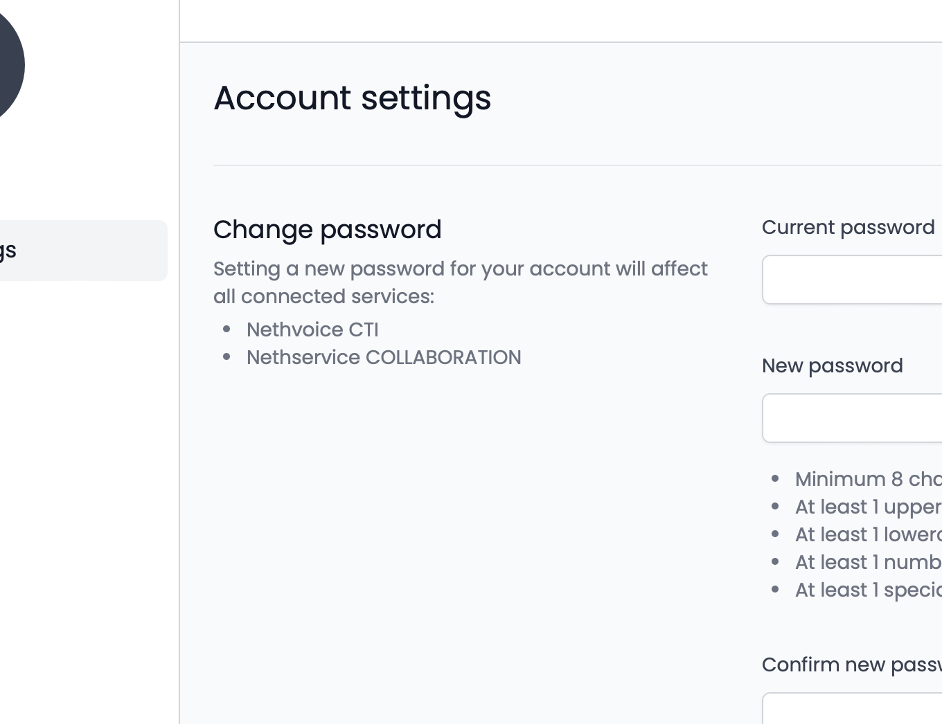

@LayLow where are you getting the Nethvoice CTI i dont seem to see it from my dashboard

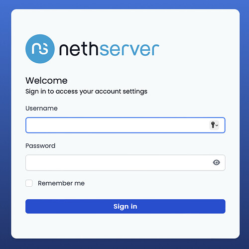

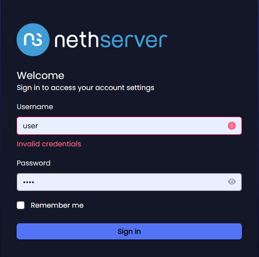

When I enter the user portal where a user can actually change their password

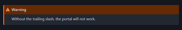

mine refused to work, and i was getting a blank page, untill i read

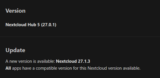

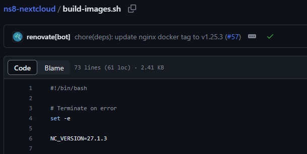

I am Curious About SOmething,
Digging into NExtcloud NS8 Github FIles, i discovered that the Available version is 27.1.3 but
when I check my installed version on RC1 of NS8 i see the version listed is 27.01
WHy is there this descrepancy, is it on purpose? IF it is on Purpose, is there any way i can pull that latest version on my NS8 for testing?
Yes it’s on purpose: 27.1.3 is on development (main branch) whilst tagged commits become testing/stable releases available from Software Center.
If you’re eager to test 27.1, just wait a bit!
