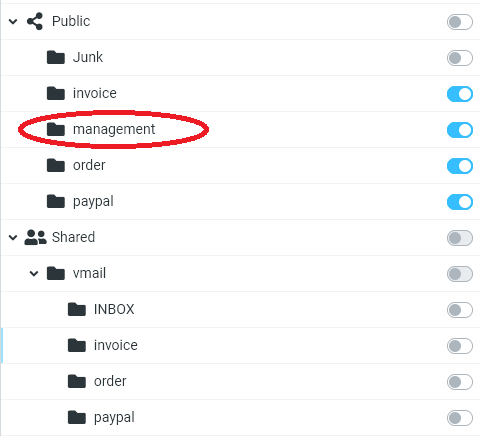

Additionally a little strange thing I have found in Roundcube settings:
There are Public and Shared mailbox groups in the list (in Roundcube settings). Earlier in NS7 there were only Public mailboxes I believe.
Now here the mailboxes always appear in the Public group even if I don’t have permission as user (only as group), while in the Shared group it appears only if I have the permission (as user).
It feels like Shared would be the one that we would need to use by default. I am not sure if there is any way to hide the Public group. Or even, I am not sure if everything is works as intended.

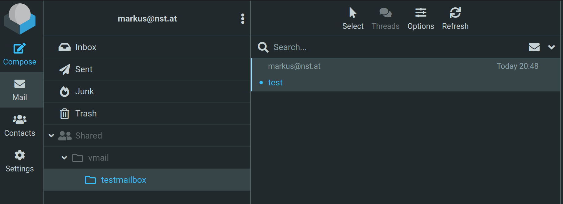

I tested with Win Server 2022 external user domain and when I assign a group to a public mailbox…
…I can put a mail into the public mailbox and set it read/unread.

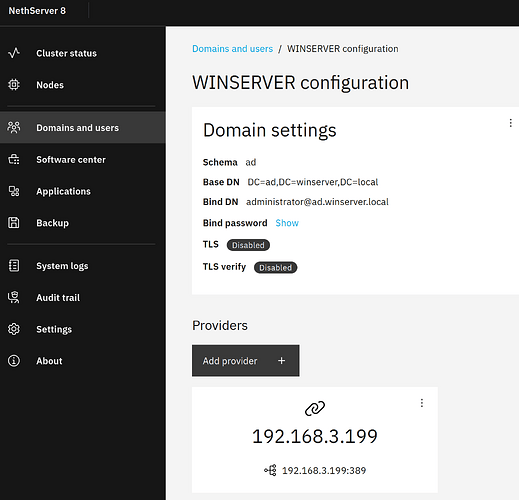

Which Windows Server version or AD version are you using?
Did you setup the external AD domain using “ad.domain.tld” or “DOMAIN” (netbios name) ? Which port did you use?

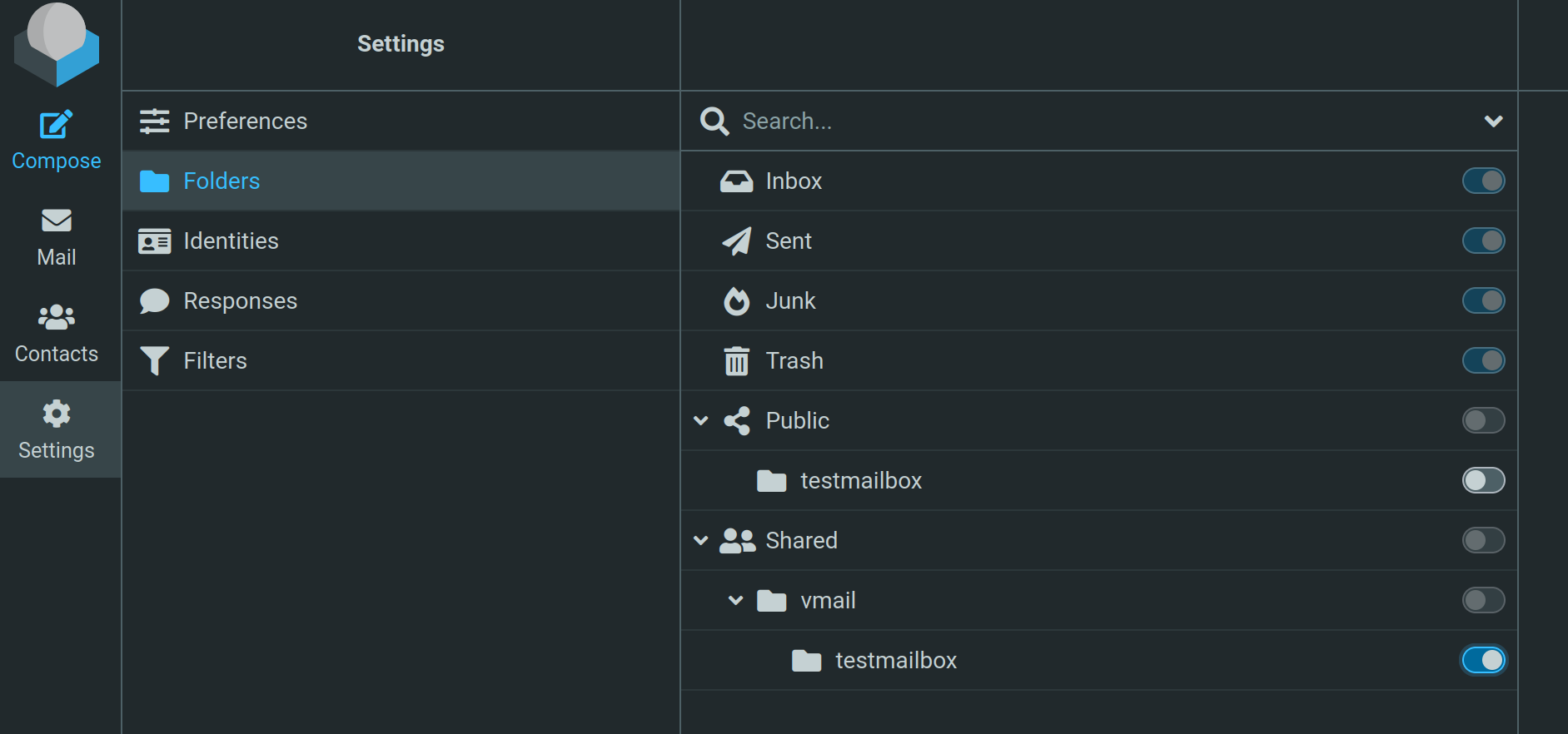

Here’s my test setup to compare:
You could disable the public mailbox under “Public” and just leave it enabled in “Shared”:

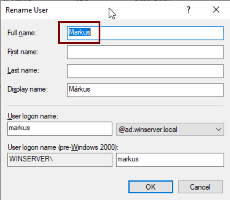

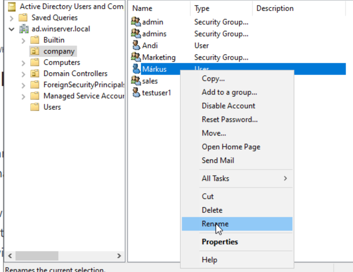

It seems the full name is used and it can be changed by renaming the user. This doesn’t change the user logon name so it shouldn’t be an issue.
Rename the users full name in a way to not use special chars anymore:
@mrmarkuz you are a genius you know, Nethesis is lucky with you!
Indeed, this way it can be renamed and seemingly everything works well!
Thank you very much!
