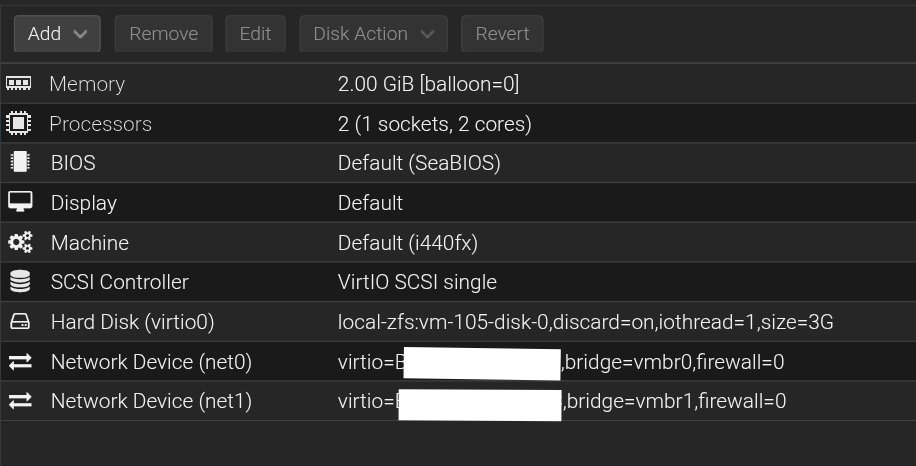

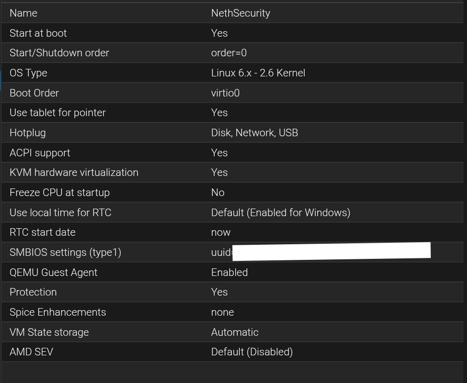

sarz4fun
(Andrea)
7
Hello.
This Is my setup.
If i send reboot signal to VM, i have this message on console
[1533911.761784] traps: qemu-ga[61921 general protection fault ip:563885c533e7 sp:7ffd8307f790 error:0 in qemu-ga[563885c3…
If i reboot or shutdown from Nethsecurity, vm reboot/shutdown correctly.
