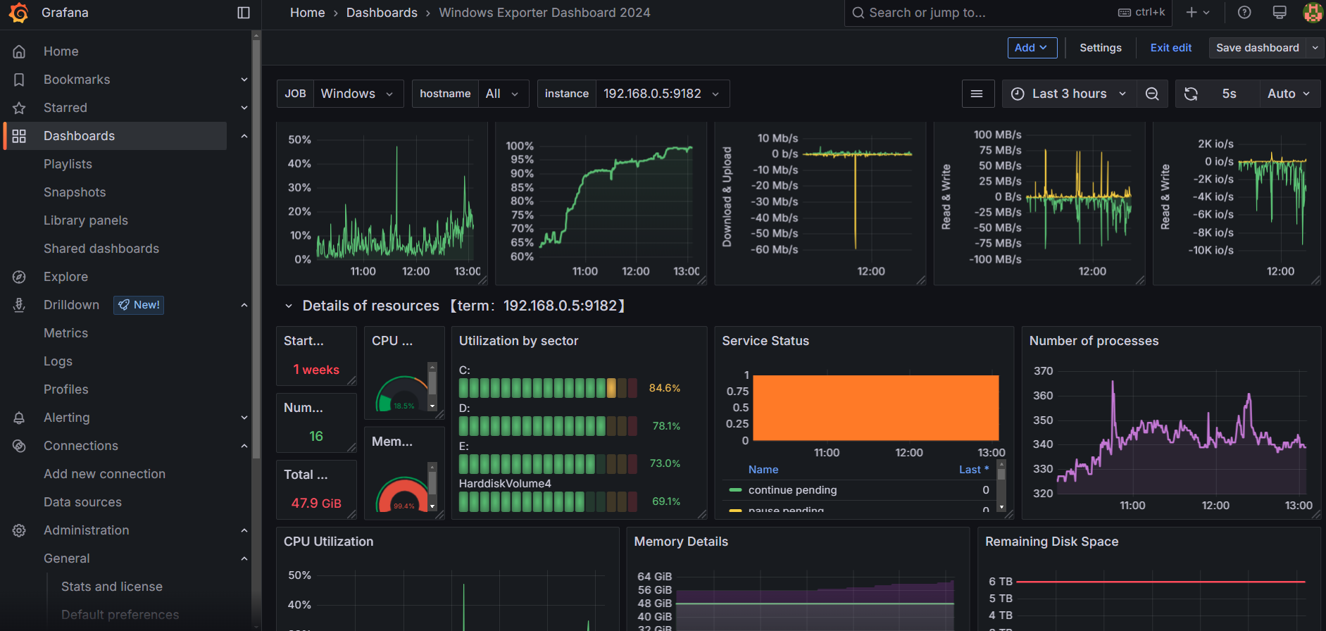

There’s a windows exporter:

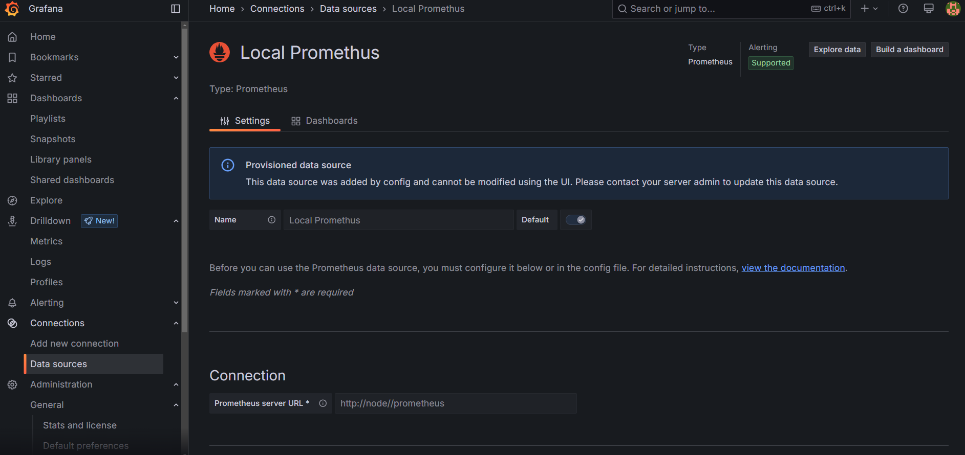

Grafana can be installed only on the leader node.
I can’t add “targets” to the file /home/prometheus3/.config/state/prometheus.yml
After reboot the entry disappears.

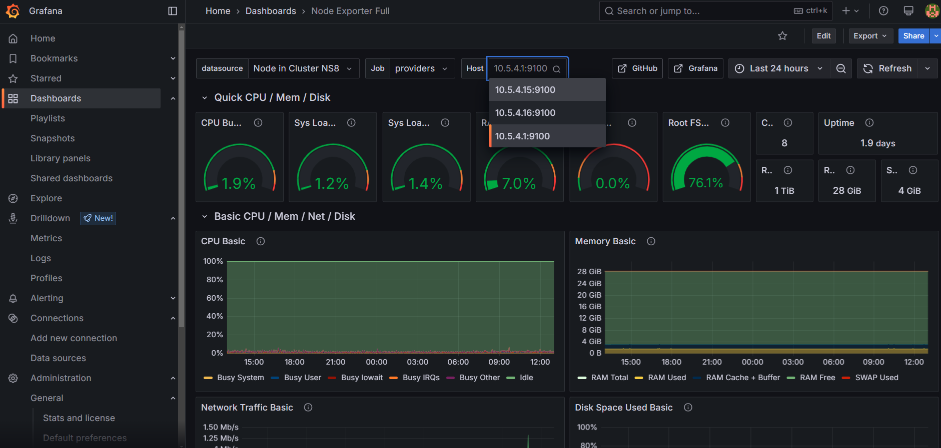

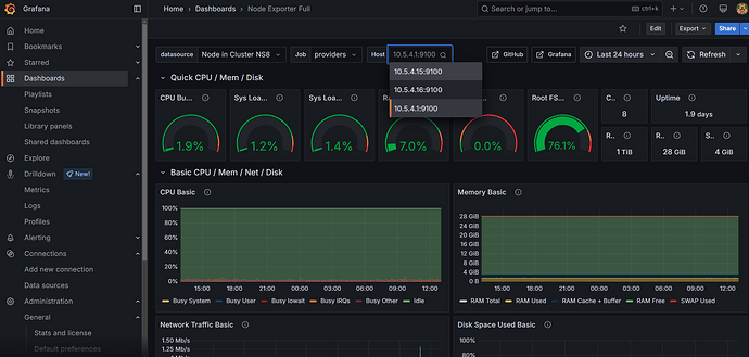

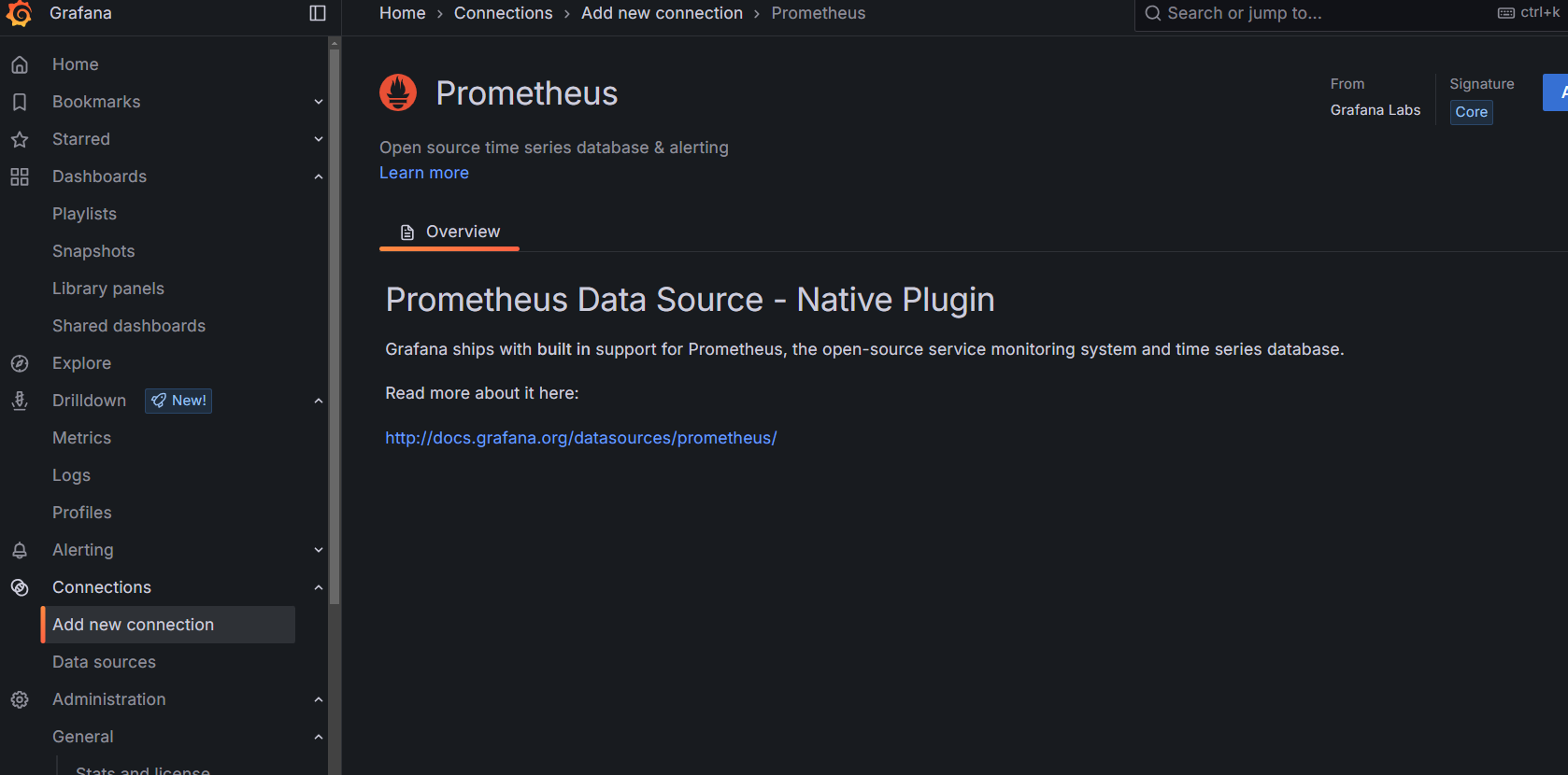

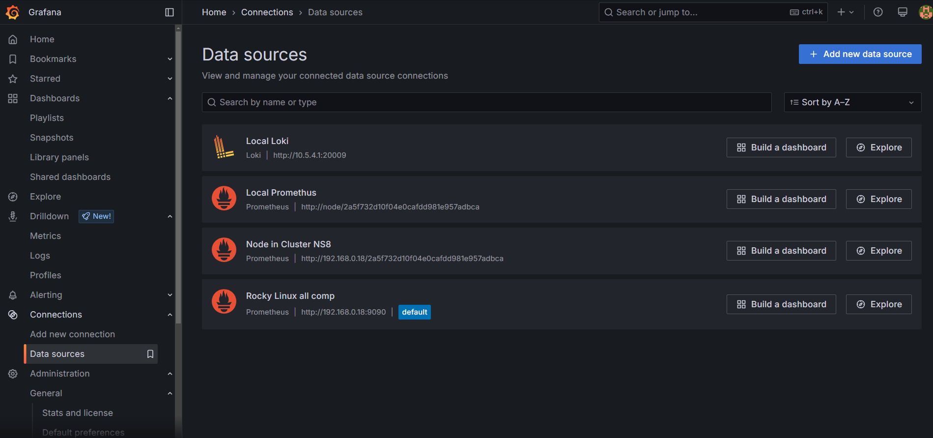

I installed prometheus locally on Rocky Linux (Node2) and connected it to Grafana. Is it possible to add a target with other computers in the network, so as not to use two prometheuses?
Grafana is currently installed on Node3 (192.168.0.18) and works fine.
