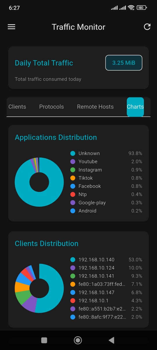

Brothers working on the Traffic Monitor module

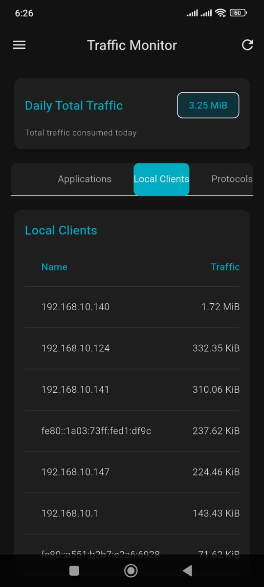

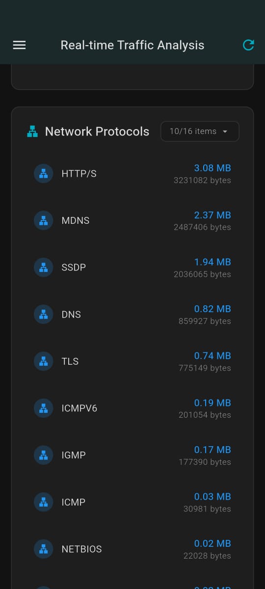

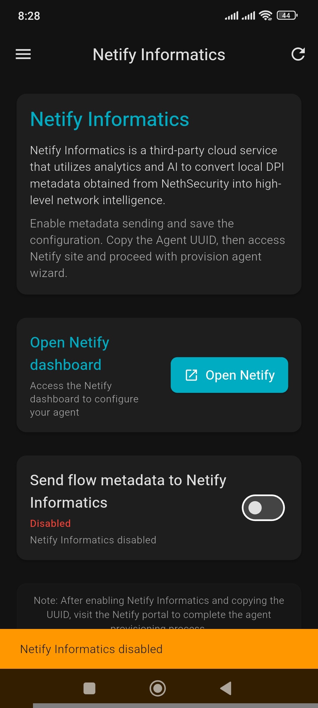

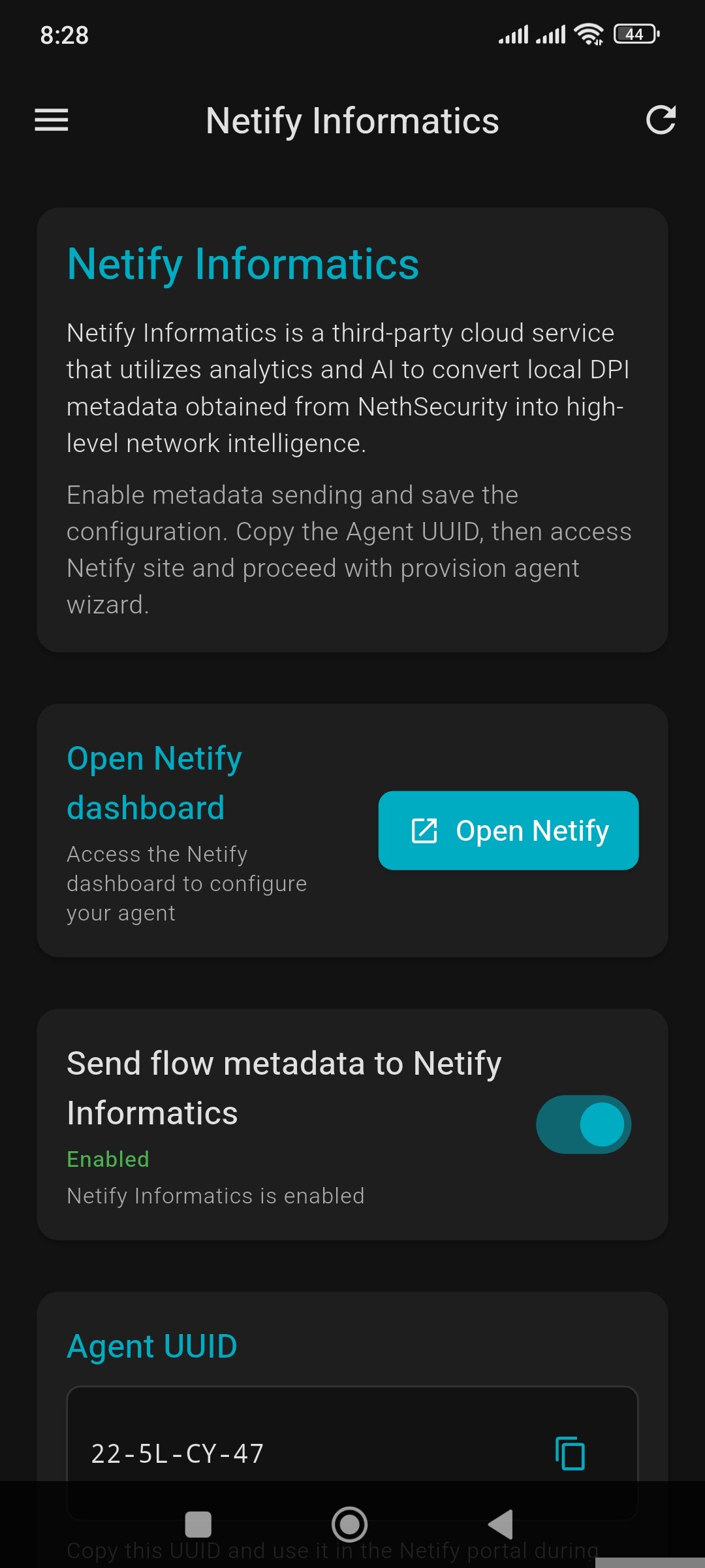

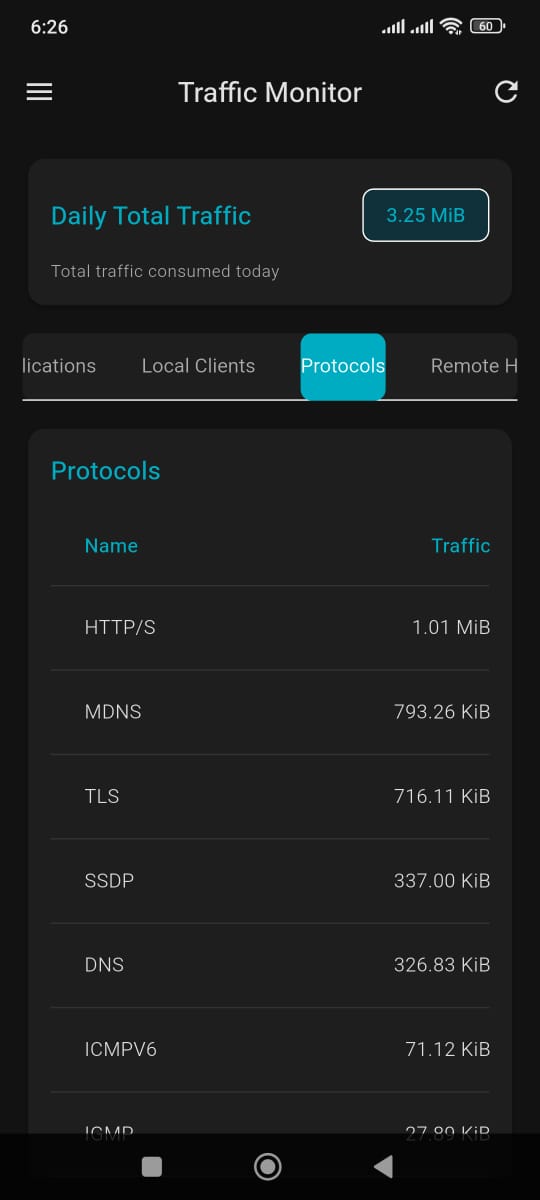

Added:

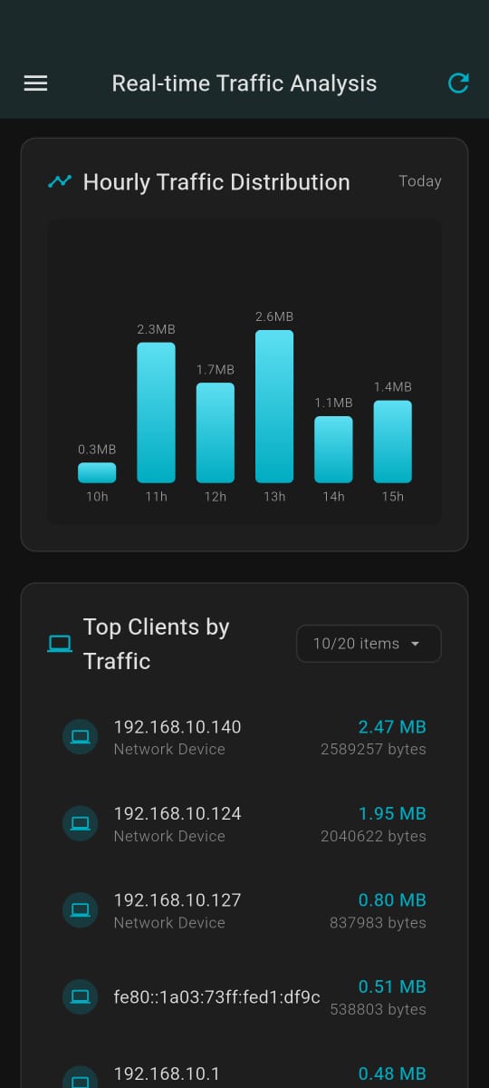

Monitoring → Real-Time Monitor → Traffic

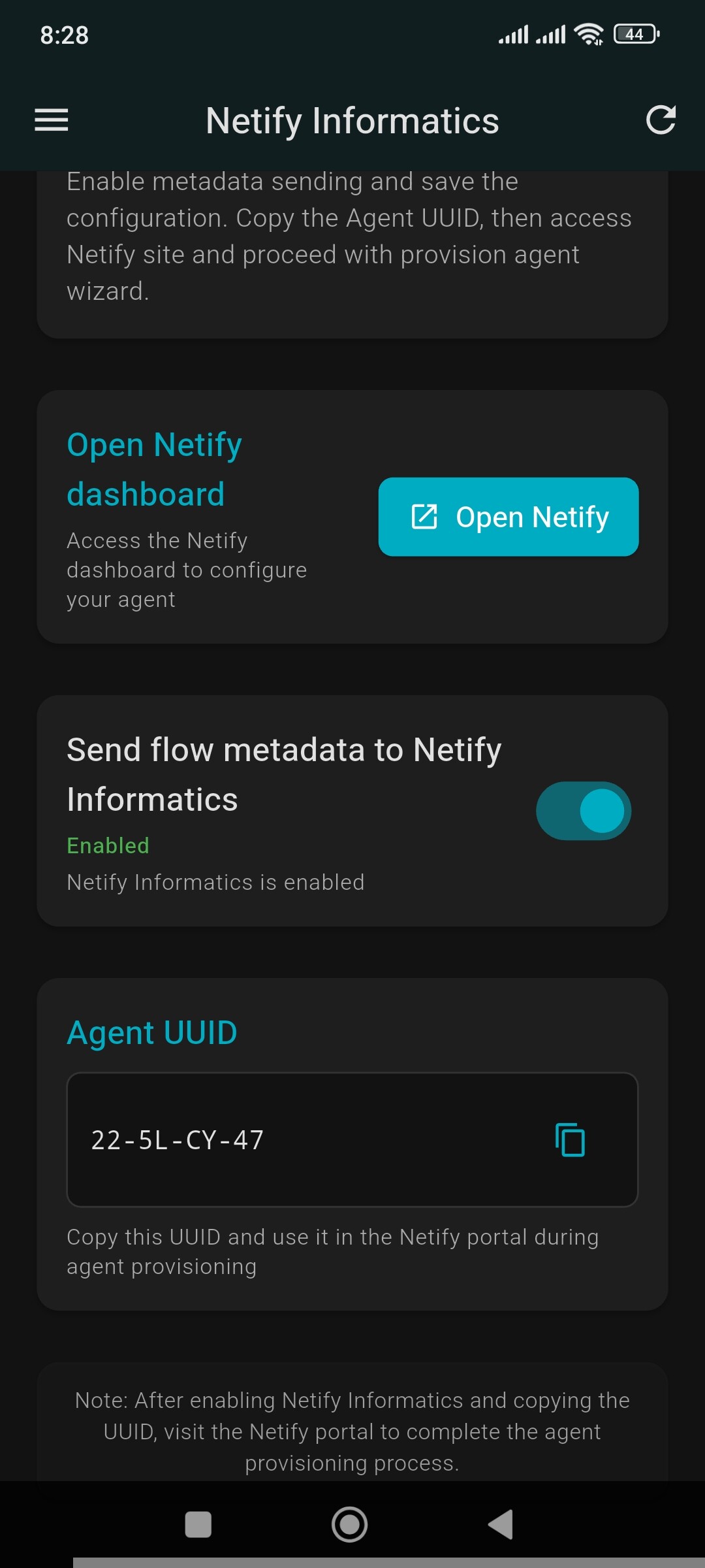

Monitoring → Netify Informatics
Monitoring → Ping Latency Monitor
https://transfer.it/t/Yr1OpQ4lRJTL
Try it and let me know

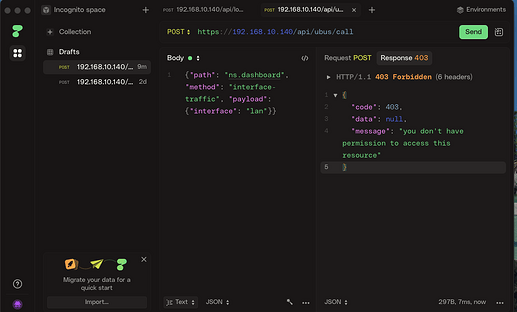

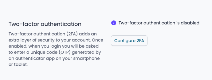

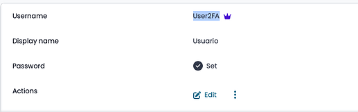

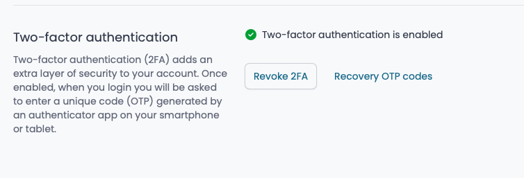

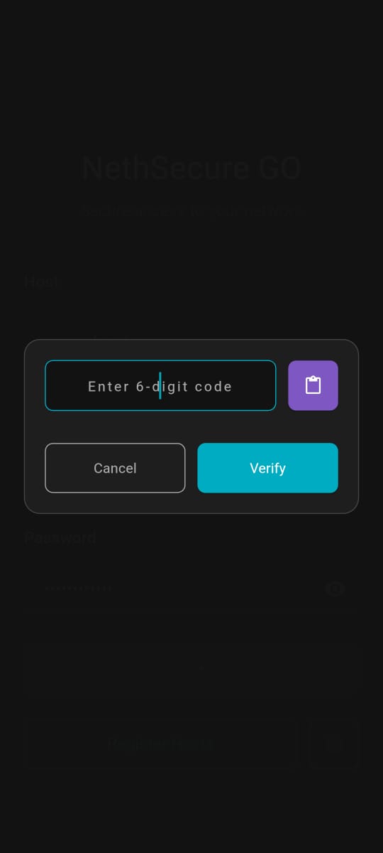

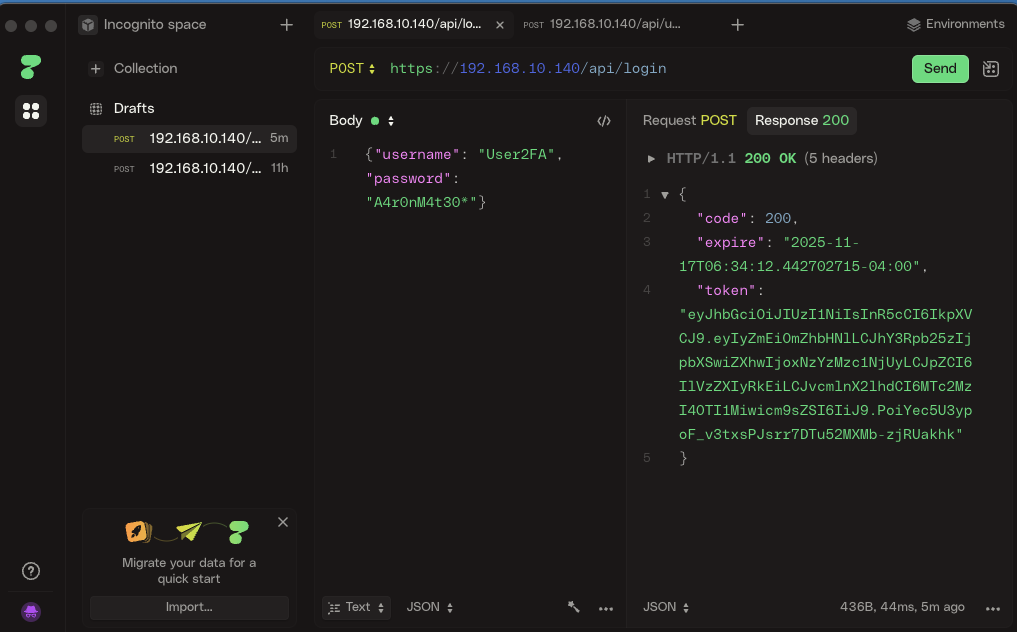

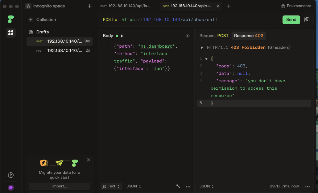

I was documenting myself about 2FA I can only activate it from the web interface, not by api-cli, or curl, only openvpn. if I activate 2FA when using the app you will not have permission to access due to the use of 2FA, I can’t find if I enable 2FA to send the code along with the password (I’m investigating and thinking about how to do it)
In the next update login redirection when logging out, user module change password, 2FA waiting for documentation

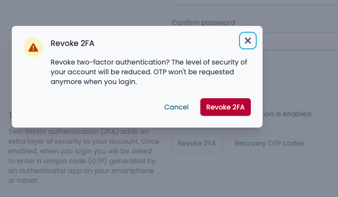

If I deactivate 2FA
I delete the previous token by logging in again by api
I could try to create an api that asks me or validates the otp 2fa code after the

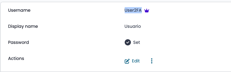

Or have one user with 2FA for web use and another user for the app; I’ll do the tests tomorrow.
Good morning, I’ve been awake since 5 am that they have started to supply drinking water to our town and we have to wash clothes, supply water tanks for the days without water.
Test carried out by creating an administrator user in the local database, which we can also access from the application, but this is possible to use it with 2FA while the root would be used by IT only with our robust keys and arrangements in the firewall redirecting access ports.

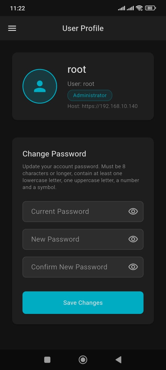

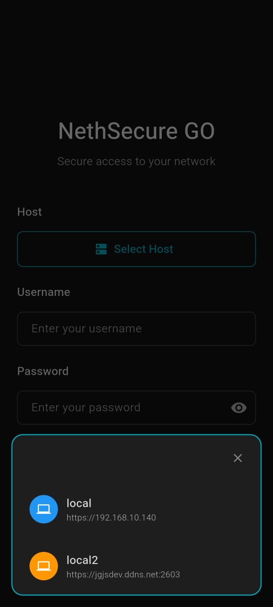

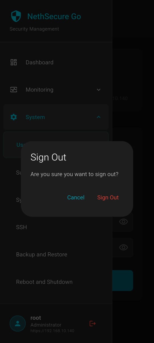

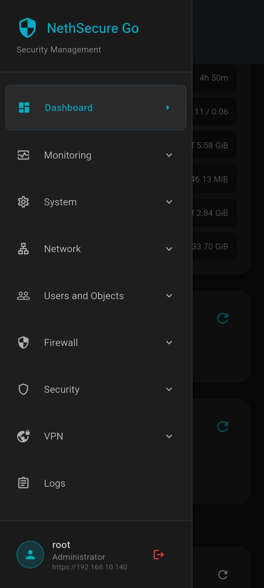

I will develop the module for the logged in user, password changes. Logout redirection to login and close the app completely, disable close app with the device buttons by pressing back.
Add User Profile, Change Password
The close session button has been added to the menu and will be redirected to the login
When changing password for silent login and refresh new token.

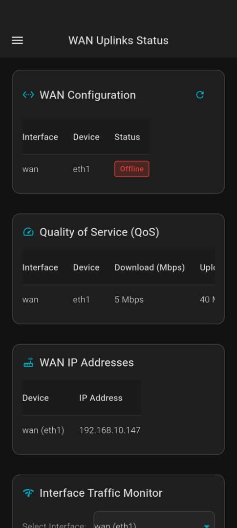

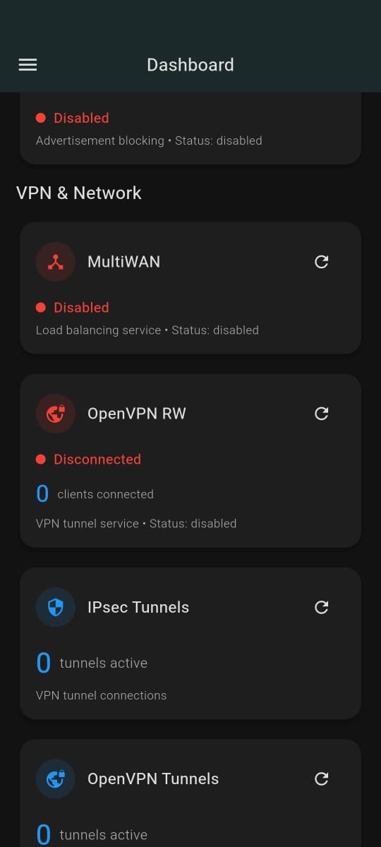

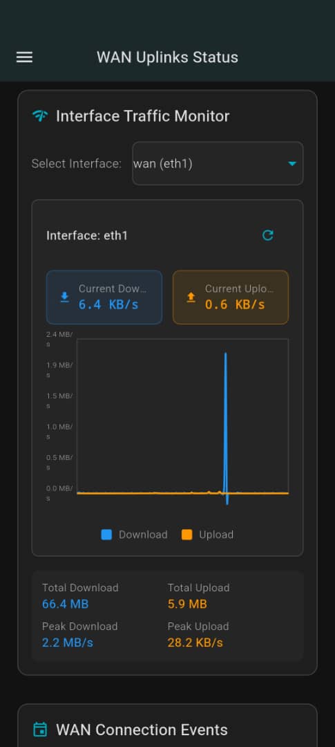

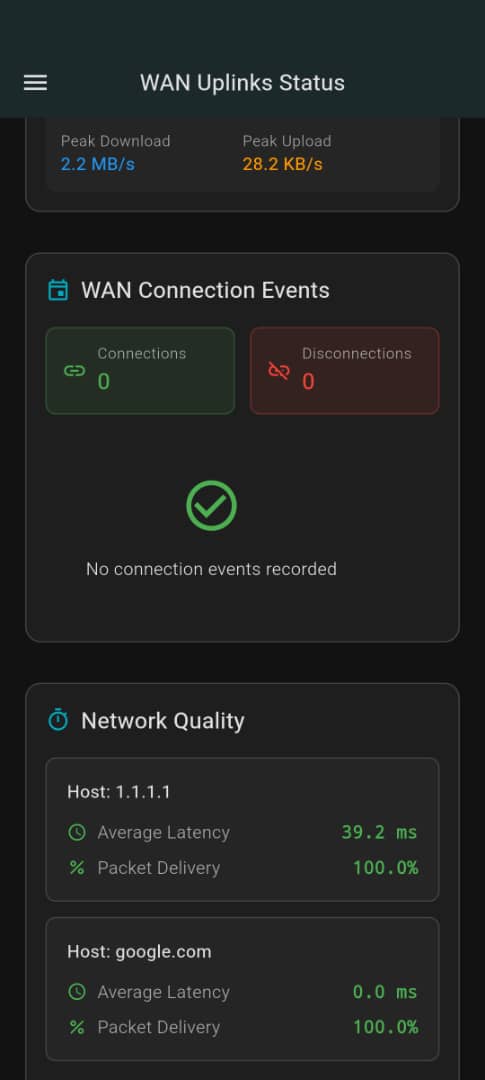

add Monitoring → Real-Time Monitor ->Wan Uplinks → Wan Uplinks Status

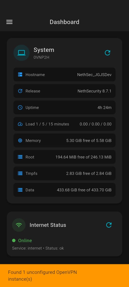

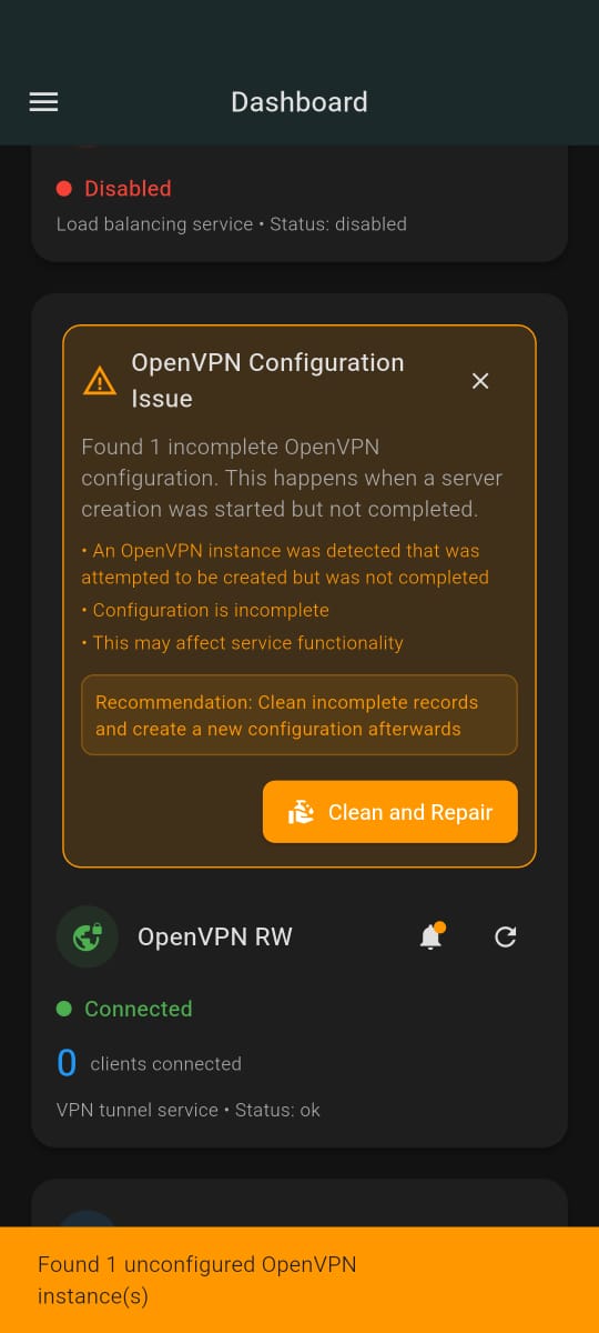

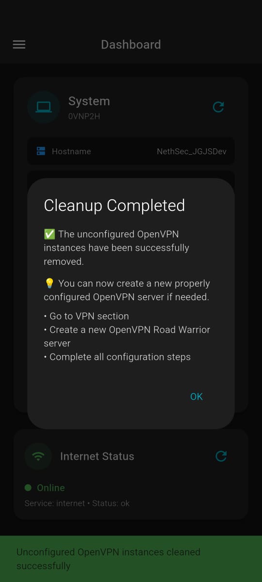

I found a bug, well it happened to me, since I was going to create a vpn to develop the VPN monitoring module and canceled it, I did that on the web. But in the app it appeared as if it was active or created a vpn instance, but investigating part of the vpn configuration was created with missing data. That would generate a false positive and that record must be cleaned and then a new one should be generated.

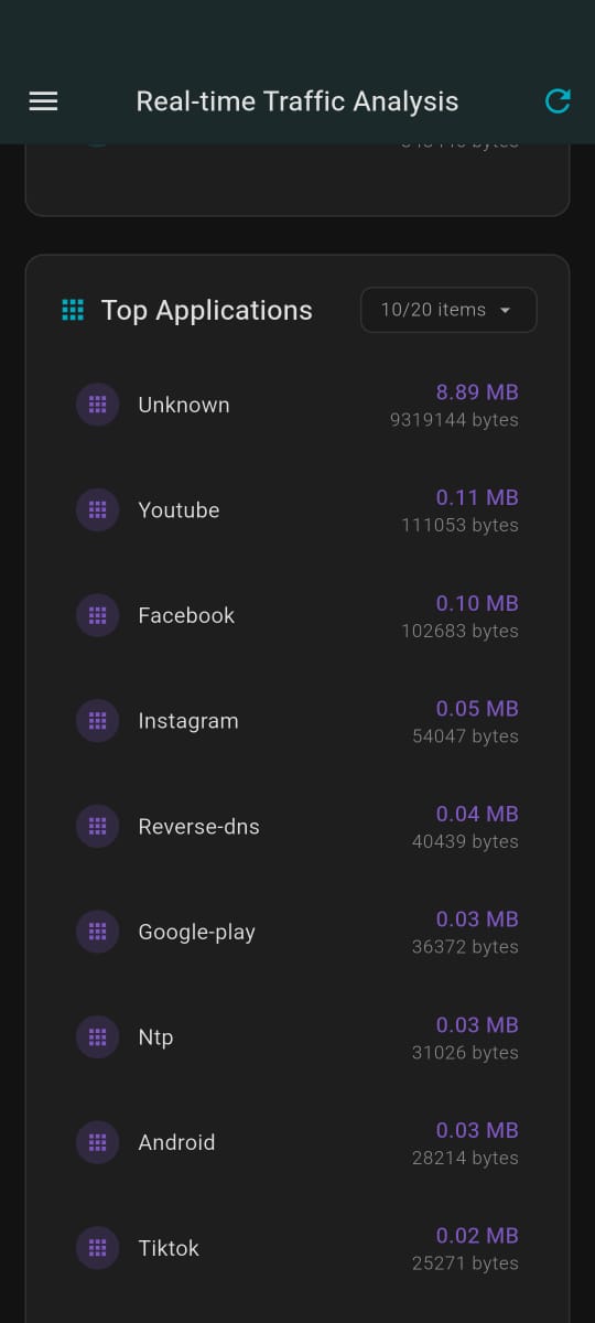

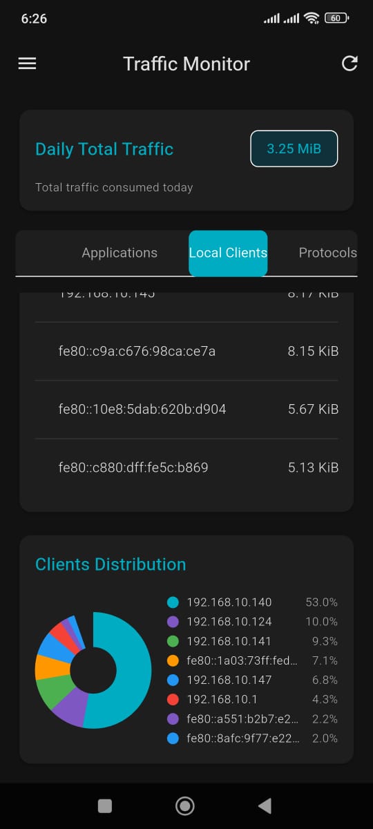

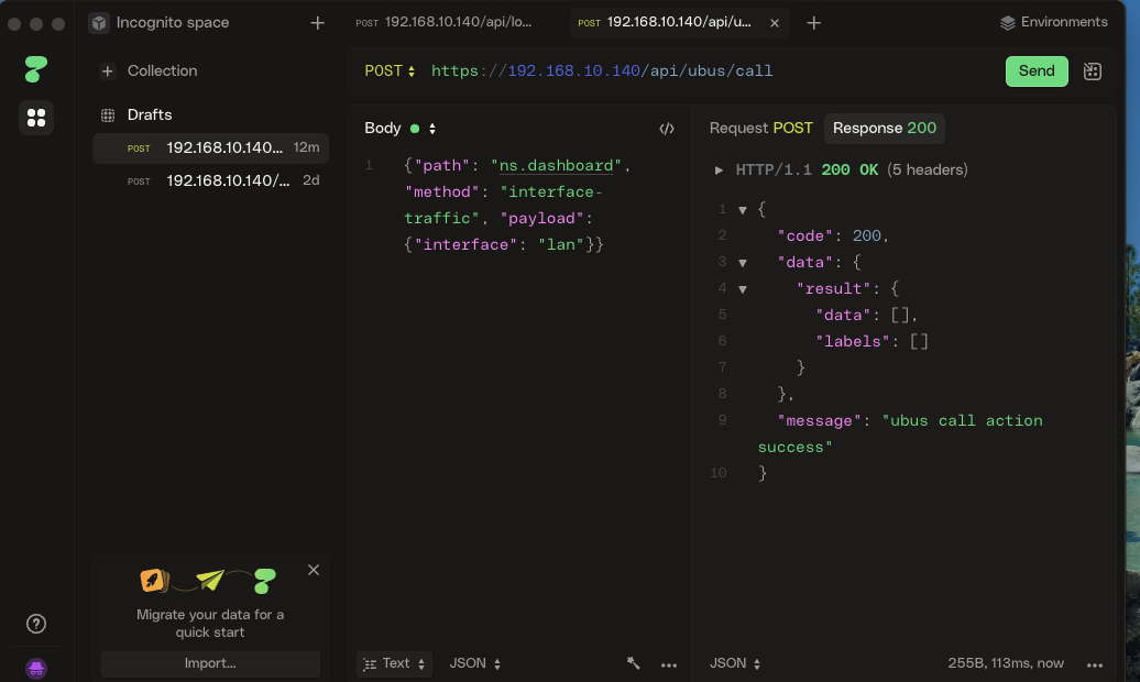

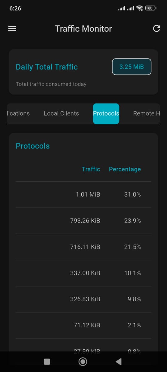

Aggregate Real-Time Traffic Monitor Module
https://transfer.it/t/iT7fldgFHTib
I will be looking for a borrowed monitor and mine broke down, sometimes you can see half and then it normalizes, the electricity ups and downs broke it even more. Here the monitors are expensive, that’s why I used my TV that was years old but it was flat with HDMI until the blackout festival began in my town.
Try the app and tell me

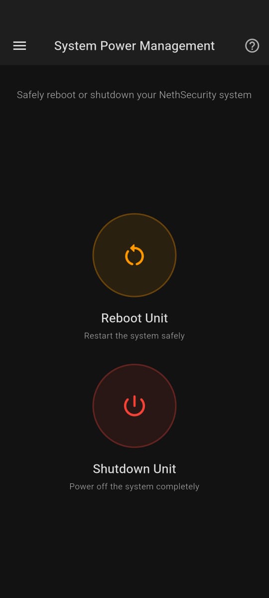

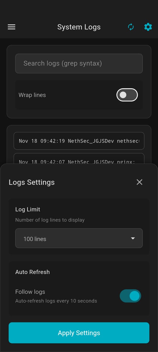

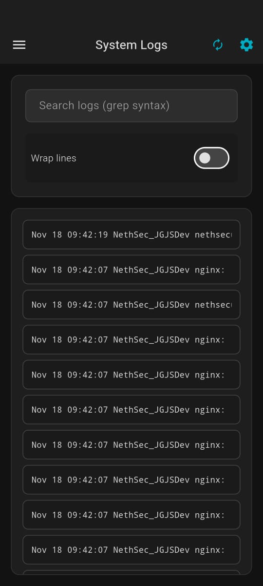

Good morning, it has been added in System → Logs and Reboot and Shutdown

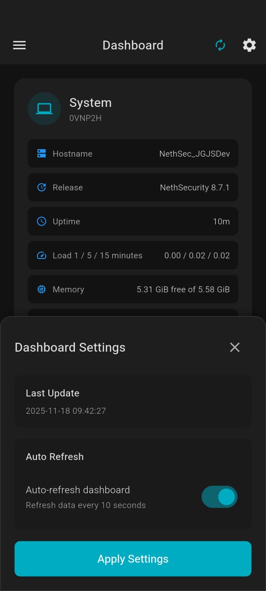

Image Makeover

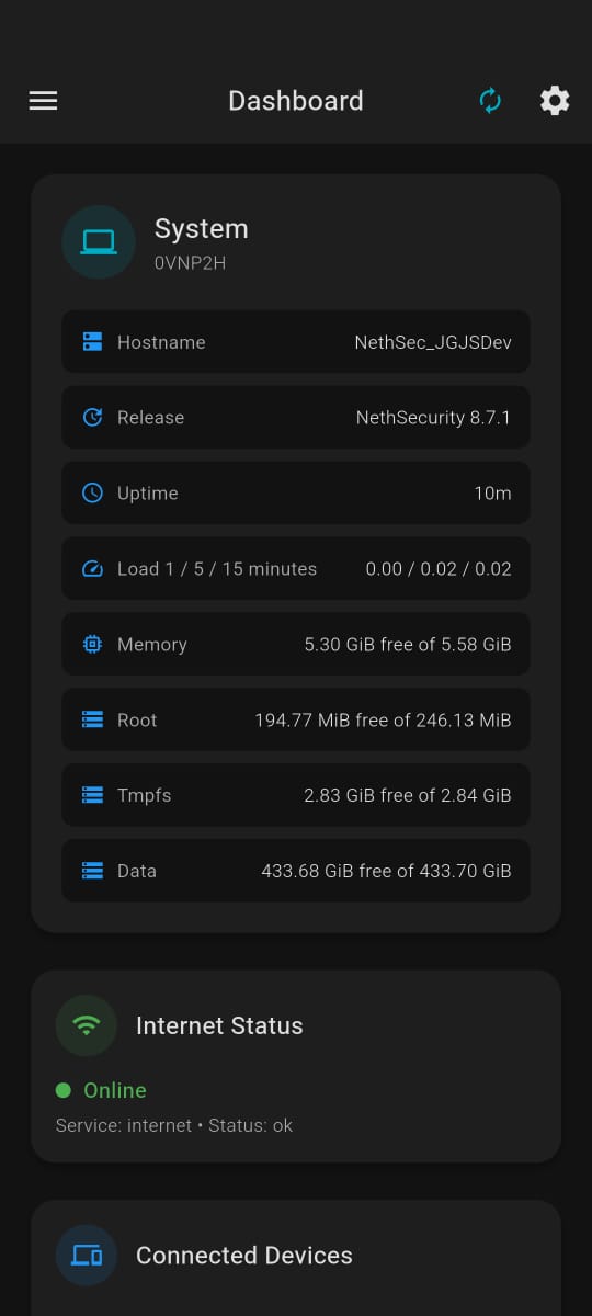

Refreshing Dashboard and Logs screens (the other screens that require it will be updated)

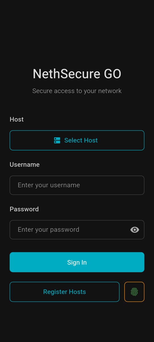

In login soon use fingerprint as an additional security factor of the user and password

Good morning, app updated with 2FA - OTP support without creating new APIs. Check its operation
https://transfer.it/t/KEVQdBhlhZRQ
