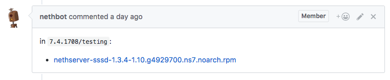

Testing package online:
yum install --enablerepo=nethserver-testing nethserver-sssd
Great team! @mrmarkuz + @davidep + @nethbot
