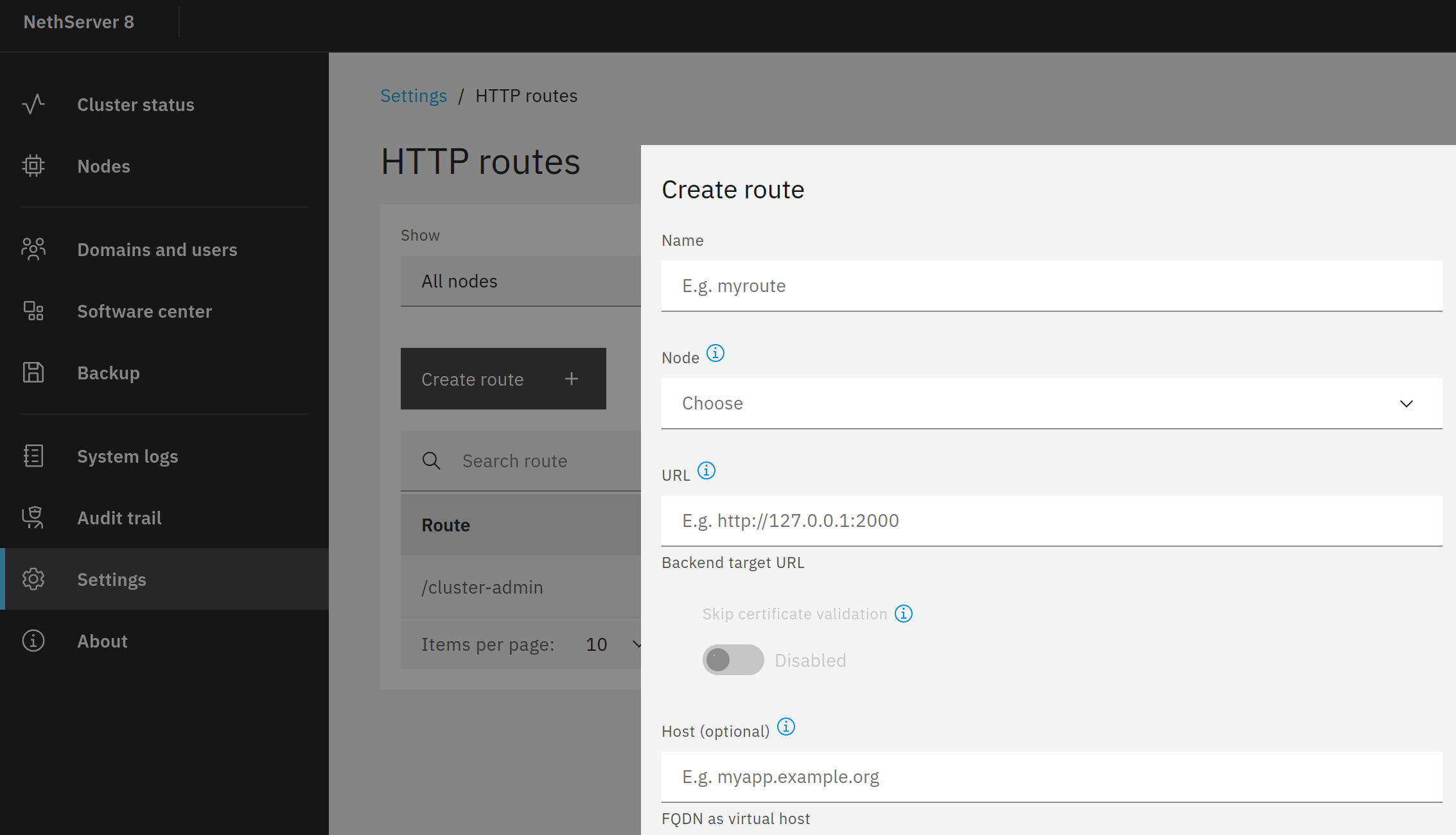

ok this sounds cool to me, just a maybe dumb question but… how do i install traefik in my NS8?
Traefik is a preinstalled core app so it’s already there in “Settings/HTTP routes”, see Proxy — NS8 documentation
ok so i need to install the NethSERVER, i can’t use it in nethsecurity got it
