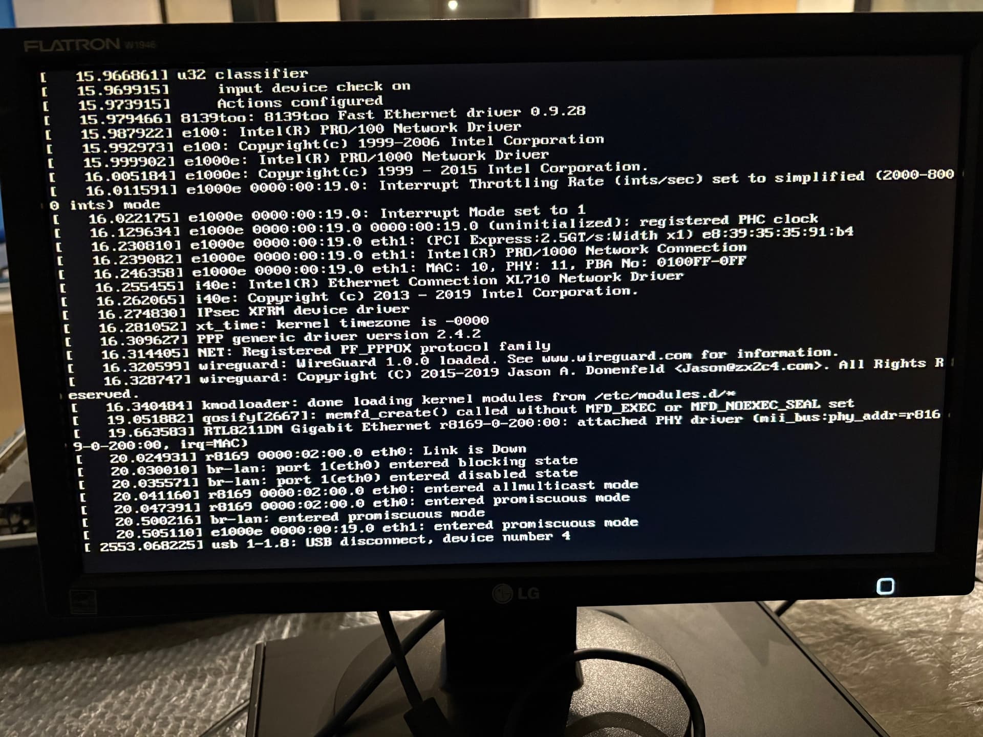

There is a place where i could download a previous version? Because i tried again the installation from ZERO, and it stoped again.
i attach the pic of the “stopping” screenshot

Hi Roberto,
If I’m not mistaken, there are reports that the update to 8.7.1 encounters an anomaly in the case of boxes/PCs with mixed Realtek and Intel network cards (as I understand is your case in the screenshot you posted).
Specifically, the network cards are remapped differently than in previous versions, so you may find that the configurations have been moved to other network cards.
Try moving the LAN cable to the other ports and see if you can access it.
I have also personally encountered an anomaly several times when attempting to reinstall Nethsecurity 8 from a USB stick on a box/PC where the product is already installed.
Even if you boot from a USB stick, the configuration on the hard disk is still launched, so you cannot reinstall.
I usually solve this by starting from a USB stick with a Rocky Linux ISO and reformatting the hard disk.

i replaced the network cards, now i installed onlu Intel card, it’s working
WOOOW
i disabled the on board network Realteck and removed the other one.
