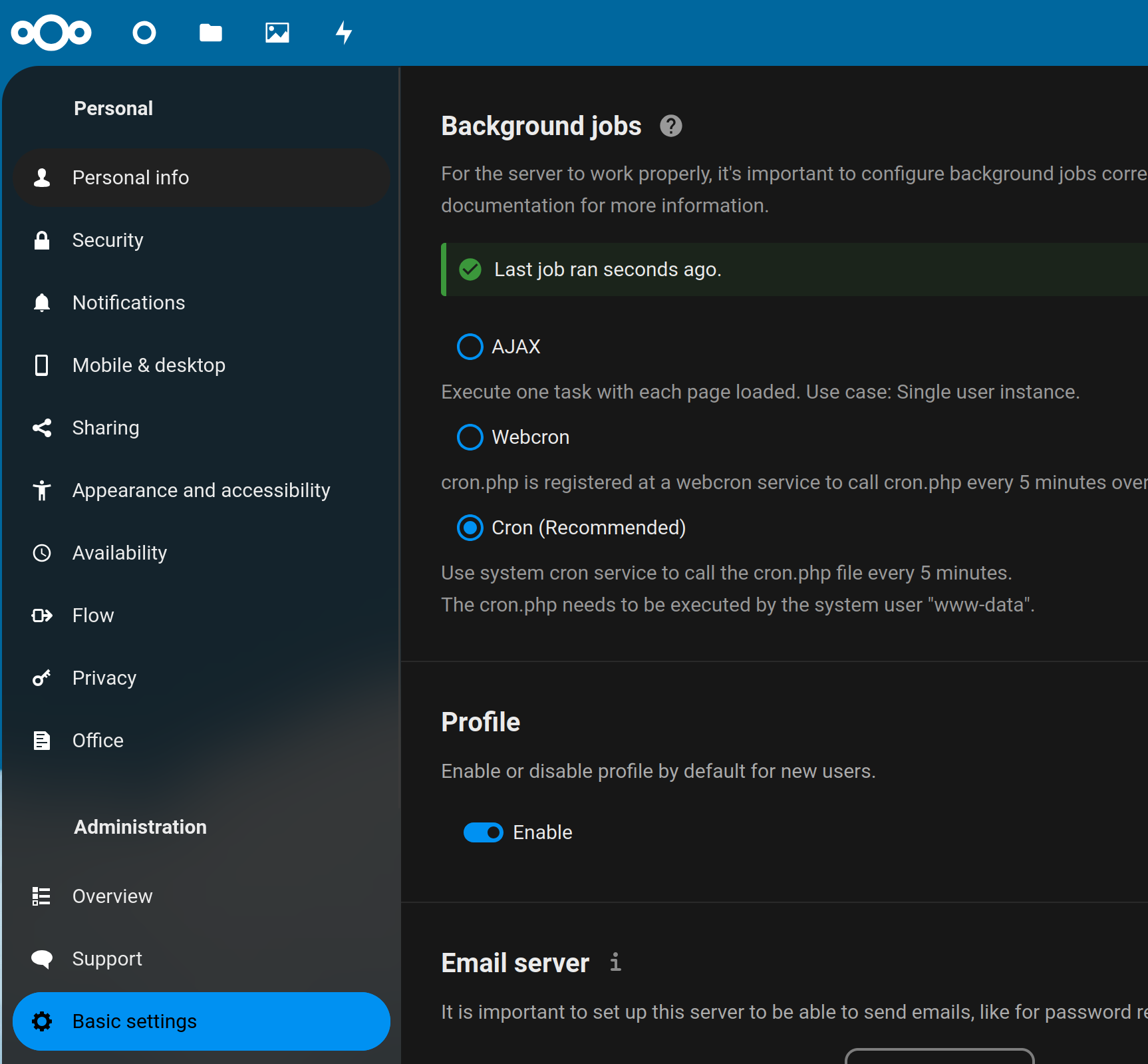

I have installed my NS 8 on a Proxmox server and since a few hours I have the problem that the error message on the picture is displayed. Apparently the system cron service is not working properly or not at all. The problem is not solved by restoring the existing backup. Does anyone know the problem and might have a solution for me?

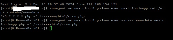

Please check if the cronjob is configured correctly:
runagent -m nextcloud1 podman exec nextcloud-app cat /etc/crontabs/www-data
Expected result:
*/5 * * * * php -f /var/www/html/cron.php
Let’s try to run the cronjob manually:
runagent -m nextcloud1 podman exec --user www-data nextcloud-app php -f /var/www/html/cron.php
If there’s no output it should have ran through without error.
In the Nextcloud administration “basic settings” you should get a result like this:
Thanks for the answer @mrmarkuz. I have done this, but but the error message remains.
