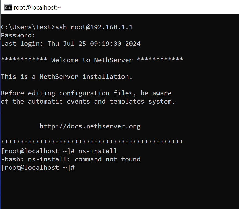

Im trying to install NethSecurity 8 on Z1 box, when i run the ns-install command it gives me the following error:
NethSecurity Version: 8-23.05.3-ns.1.1.0
You have to boot the box with the Nethsecurity 8 usb stick and not give the command from the Nethserver 7.9 console.
