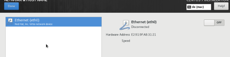

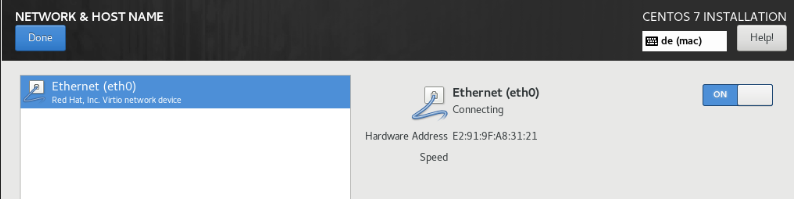

yes, I did
If I do that… no interface recognised during install script
enabling doesn’t help

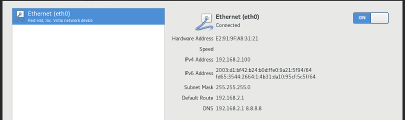

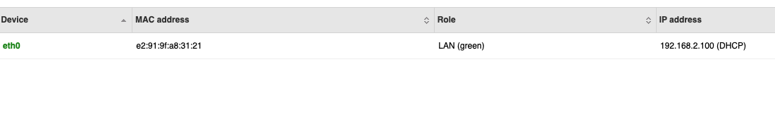

inside the new nethserver:
[root@v-nethserver2 ~]# ifconfig
eth0: flags=4163<UP,BROADCAST,RUNNING,MULTICAST> mtu 1500
inet 192.168.2.100 netmask 255.255.255.0 broadcast 192.168.2.255
inet6 fe80::e091:9fff:fea8:3121 prefixlen 64 scopeid 0x20
inet6 fd65:3544:2664:1:e091:9fff:fea8:3121 prefixlen 64 scopeid 0x0
inet6 xxxx:xx:xxxx:xxxx:e091:9fff:fea8:3121 prefixlen 64 scopeid 0x0
ether e2:91:9f:a8:31:21 txqueuelen 1000 (Ethernet)
RX packets 65761 bytes 187650469 (178.9 MiB)
RX errors 0 dropped 0 overruns 0 frame 0
TX packets 48243 bytes 7118254 (6.7 MiB)
TX errors 0 dropped 0 overruns 0 carrier 0 collisions 0
lo: flags=73<UP,LOOPBACK,RUNNING> mtu 65536
inet 127.0.0.1 netmask 255.0.0.0
inet6 ::1 prefixlen 128 scopeid 0x10
loop txqueuelen 1000 (Lokale Schleife)
RX packets 1260 bytes 1845727 (1.7 MiB)
TX packets 1260 bytes 1845727 (1.7 MiB)

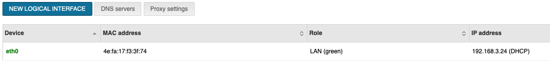

(Is nano /etc/pve/qemu-server/100.conf the correct VM?)
lost the entry for vmbr1…
agent: 1
bootdisk: scsi0
cores: 2
ide2: local:iso/nethserver-7.7.1908-x86_64.iso,media=cdrom
memory: 2048
net0: virtio=4E:FA:17:F3:3F:74,bridge=vmbr1
numa: 0
ostype: l26
scsi0: local-lvm:vm-100-disk-0,size=35G
scsihw: virtio-scsi-pci
smbios1: uuid=3d6c4331-3b5d-4a7b-83f3-4ab5baaaf0dc
sockets: 1
vmgenid: 0136bb30-ef92-4449-aaad-9525a3949974
Doesn’t look like 2 NICs to me…
What does the GUI show for that VM?
Also here, there is only NIC allocated.
Maybe one allocation got lost…
