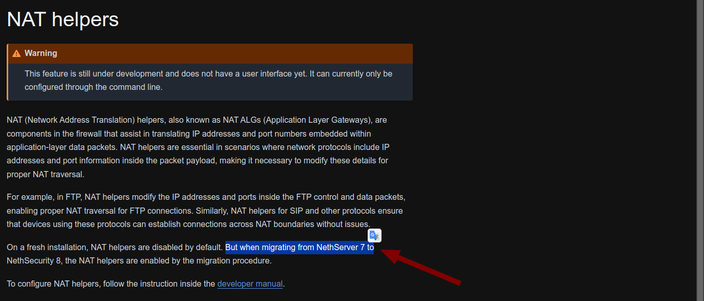

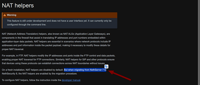

It meens that nat helpers becomes enabled only if i do migration in place, in my case with export configuration and upload to nethsecurity is still disabled? how can i check that from CLI?
No, it does not matter how you migrated.
You just need to make sure to have both the package on NS7 and the image of NethSecurity 8 at the latest release.
Did you follow the link to dev manual?
It’s explained there:
Depending on what you’re testing, the command should be something like:
It’s clearly stated that SIP helpers should be disabled.
So disable them inside the firewall config, than check if all other documented configurations are in place.

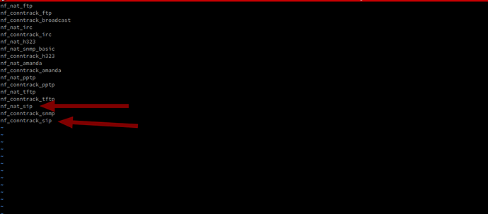

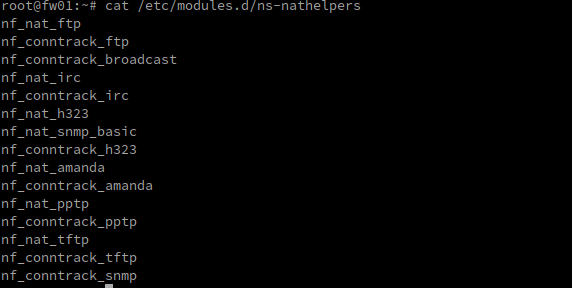

The content of the file now is these one:

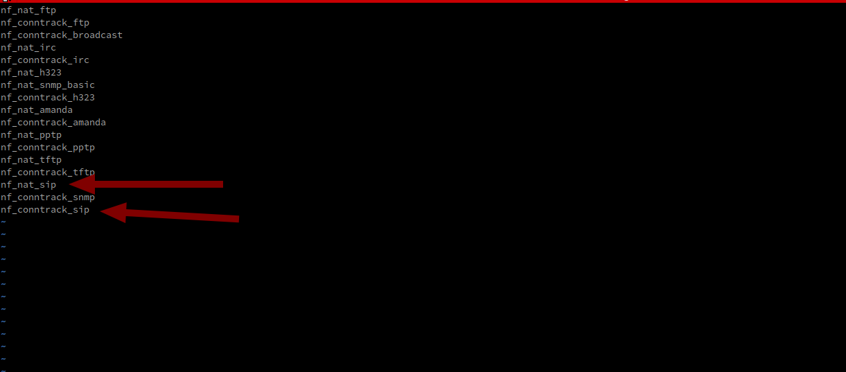

but if i do this command seems the module still load:
But now the sip trunk not registered anymore by removing these two modules.

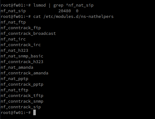

I try to remove only nf_nat_sip as you can see and reboot but the module is still loaded:
UPDATE:
As a workaround now i disable the module manually by doing these command:
rmmod nf_nat_sip
load-kernel-modules
service firewall restart
