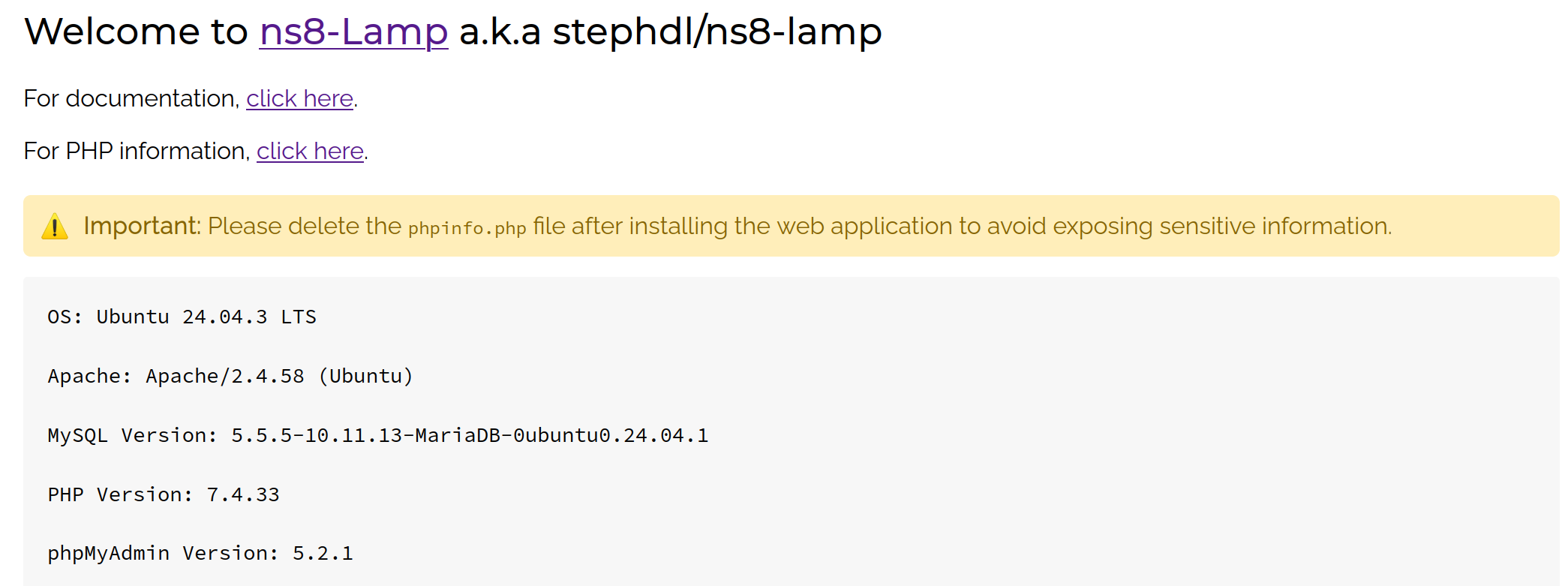

I tested the direct install, does it works on you side ?
Yes, direct install is working, phpinfo shows correctly the configured php version 7.4.

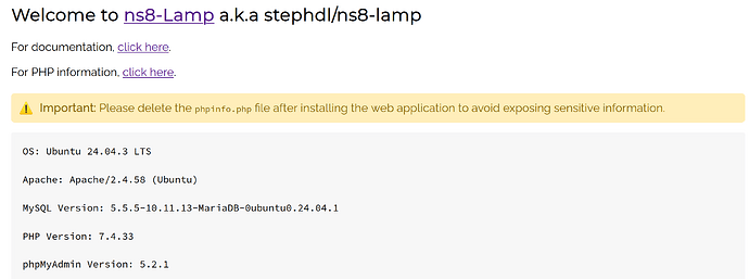

Upgrade from 1.0.15 is working here.
released with 1.1.0
Updated, was able to set the vhost to PHP 7.4, and that solved the problem I was having with Meteotemplate. Thanks.
