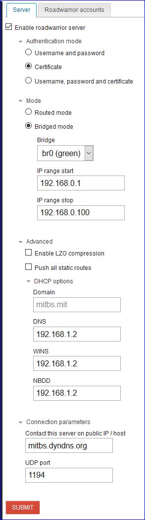

I have a problem with my bridged VPN.
I have two VPN servers that can be reached via two different gateways.
A VPN server with OpenVPN on Ubuntu - Routet mode VPN (NAT).
And a VPN server with Nethserver - Bridged mode VPN.
The bridged VPN on the Nethserver no longer works properly.
But it worked in the same configuration for months without problems.
Maybe a Nethserver update triggered the behavior?
I can still successfully connect all clients to the VPN.
However, these cannot achieve anything in the LAN.
However, the VPN clients can be pinged from the LAN.
I have tried other configurations (e.g. changing the zone) but nothing worked.
Does anyone have any idea what else could be tested?

The pictures with:
==> a Linux is connected with Linux-VPN-Client (same problem as Smartphones)
==> MITSRV055 - Fritzbox forwarding to Nethserver
==> Ping from PC in LAN to connected VPN-Client
==> Nethserver Net-Config
==> OpenVPN-Client (Smartphone APP)

It’s difficult to enumerate your network from the snippets posted. Can you provide some form of network diagram.
It appears you have 2 green interfaces in the same 192.168.1.0 subnet. How does this work.
Cheers.

It is only a bridge, it is not routed.
So the same subnet shouldn’t be an issue, should it?
It worked for a very long time in exactly the configuration.
I suspect an update or something similar that may have caused the problem.
This is a stand-alone server as a VM under an ESXi.
The network into a 192.168.0.1/20
192.168.0.1 to 192.168.15.254
The Fitzbox forwards VPN connections to this server.
All clients can dial in, but they can no longer access the network. As already written, you can reach the VPN from the outside (LAN).
192.168.0.1 to 192.168.0.100 is reserved for the VPN.
LAN DHCP is from 192.168.2.1 to 192.168.15.254
All static servers are in 192.168.1.1 to 192.168.1.254
But I have already tried two different subnets, so the clients can no longer dial in.

The only strange thing I see is that you are using the same 192.168.0.0 subnet for both your VPN and also your Modem/Router subnet, which (I think) is going to cause routing issues.
Cheers.
Ok, you can see another subnet on the picture, it is done as you describe it.
But the bridge mode does not route, it is as if the network cable was plugged directly into a local switch (?).
And even if it had to be routed between two subnets, the VPN server should do it internally. With the TAPI interface, for example.
The OpenVPN from “https://openvpn.net” does NAT or routing internally, even with a single interface, and it works.
The problem is, if it is, it would be a “nogo” for me.
Because the DSL router must remain in its own subnet, otherwise clients in its own network can no longer reach it as an Internet gateway.
The DSL router would then only be available for the VPN, and that would make no sense.
Or am I misunderstanding something right now?
Does the OpenVPN roadwarrior with bridge work for everyone else?
Ooops, I missed the bridged mode. :grimacing:
But in that mode doesn’t the address range used by the VPN have to be separate from your range used by your router. The VPN is configured for 1 -> 100 but you already have at least 1 and 10 in use.
