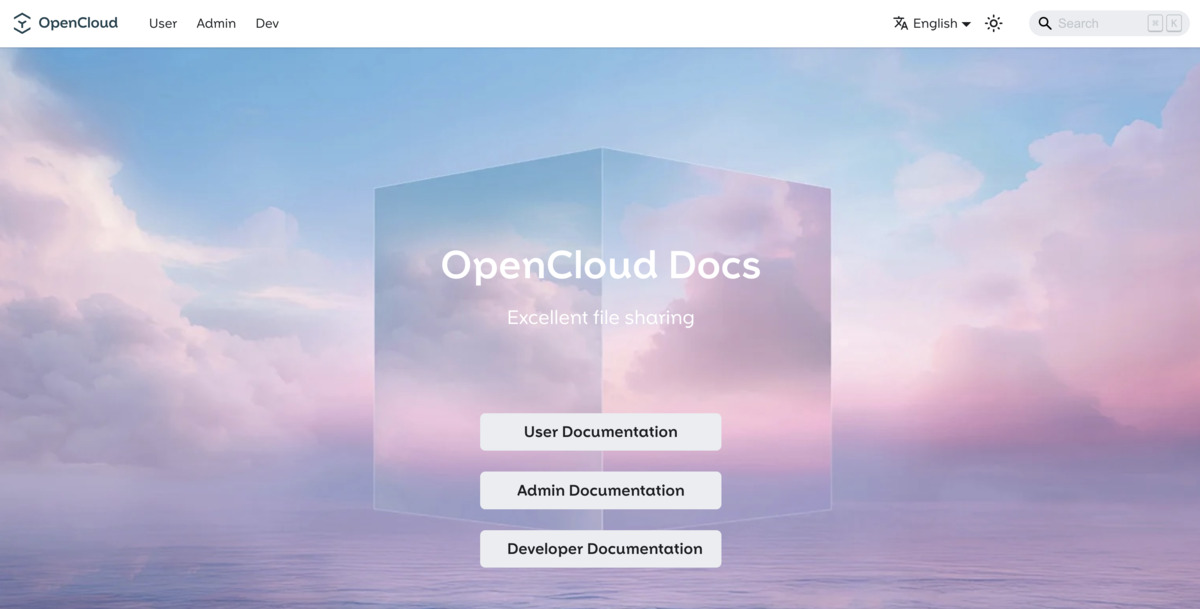

OpenCloud Documentation: https://docs.opencloud.eu/
