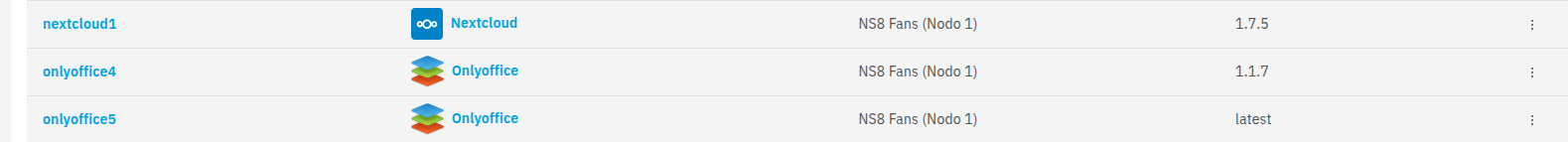

Yes, when you install an app, a new instance is installed and the old one remains.
It seems you installed an instance from command line using the latest tag. This should be avoided as latest may be not be ready for production and updates won’t work.
Onlyoffice should be installed from Software Center to install the right version tag.
I recommend to remove all onlyoffice instances and start over with a fresh installation via Software Center.
