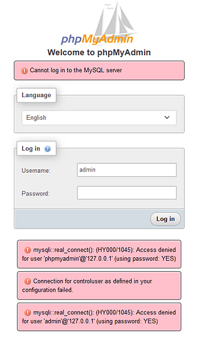

Here’s what I see in my browser when trying to access phpmyadmin.

2025-01-07T09:49:54-05:00 [1:mariadb1:mariadb-app] 2025-01-07 14:49:54 26 [Warning] Access denied for user 'phpmyadmin'@'127.0.0.1' (using password: YES)
2025-01-07T09:49:54-05:00 [1:mariadb1:mariadb-app] 2025-01-07 14:49:54 27 [Warning] Access denied for user 'admin'@'127.0.0.1' (using password: YES)

Logged in as root on the Debian 12 VM that NS8 resides on, then using your runagent command and then podman command, gives me an error saying, access denied for user 'root'@'localhost'(using password YES).
Almost like I need to be logged in as ‘admin’ in the mariadb environment to be able to reset admin’s password.
It should be possible to login as root without password as the mysql root password is stored in the .my.cnf file in the container.
podman exec mariadb-app cat /root/.my.cnf
Maybe it helps to click save in the NS8 app settings to start reconfiguration.
But I guess something went wrong at installation (like database init) so I think in this case it’s the easiest way to just remove mariadb and reinstall it.
If there are still issues please share the logs after installation and first configuration.
Thanks Markus. I did a number of steps after uninstalling Mariadb. I created a new subdomain in the DNS of my domain host. I did this to differentiate between the Nethsecurity and Nethserver VMs (mentioned in my original post above). Then I used this when creating a domain and user in cluster-admin (I hadn’t done this combination yet). I used the newsubdomain.domain.com as the domain when configuring. I then installed Mariadb and configured it. Now https://newsubdomain.domain.com/phpmyadmin got me in using admin:admin. I was then able to assign a new password to phpmyadmin. Thanks for your input. It’s a great forum when even the gurus help you out with problems. Going through all these cumbersome steps and then R&D’ing will lead me to a decision if I want to keep a proxmox pc and its VMs to replace dedicated equipment we’re currently using. One of them is NS7. I’ll purchase NS8 subscriptions if and when it makes sense to make the leap to Nethsecurity 8 and Nethserver 8.
