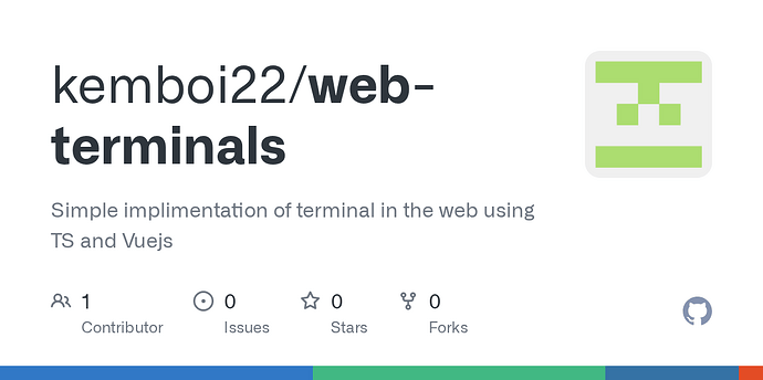

Reason i want to migrate to vue3 is i am currently testing web terminals and i would like to impliment the web terminal in ns8-modules
Here is the example implimentation
https://web-terminals.vercel.app/

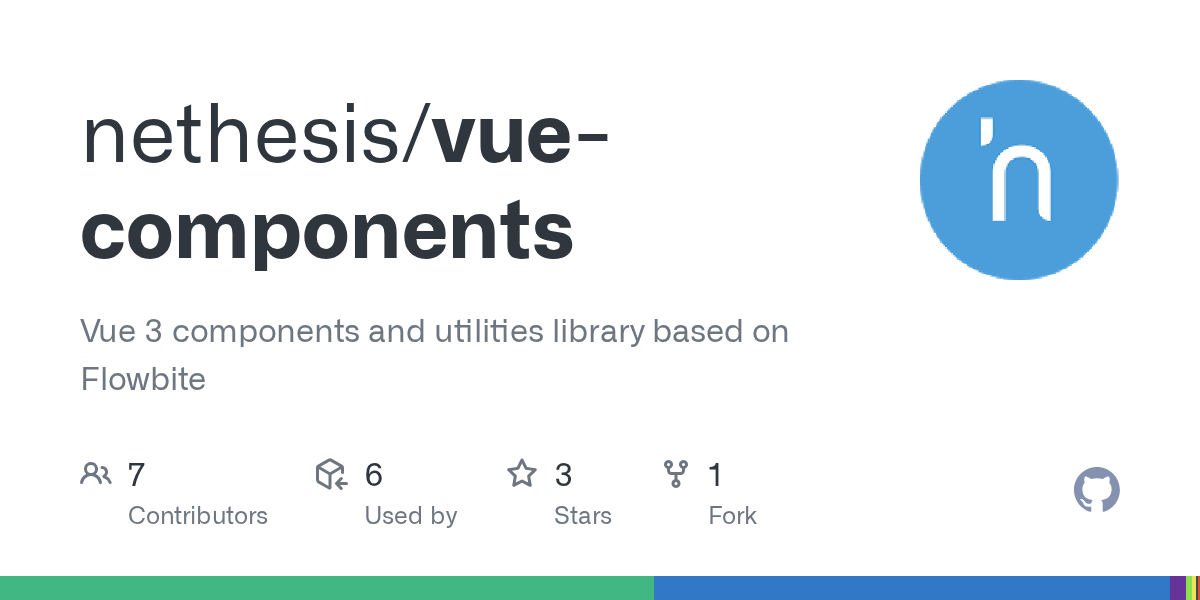

GitHub - nethesis/vue-components: Vue 3 components and utilities library based on Flowbite is the library we developed for our vue 3 applications. I don’t understand what you mean by “it appears to have the same api as carbon 11” but I don’t think this is a viable solution.

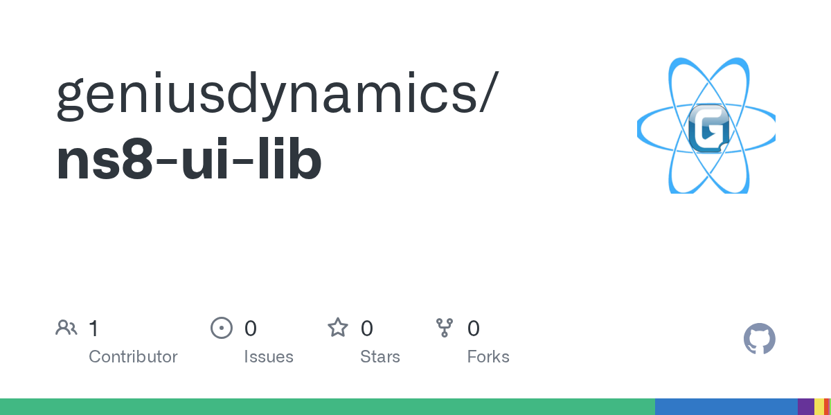

i have been porting the ns8-ui-lib to vue 3 still in alpha version hopefully will test this week on a module to check if it works
Finally ported the Ns8-ui to v3

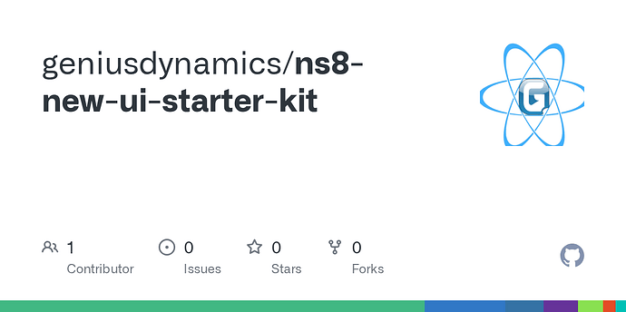

here is a starter kit to the new ui in vue3 i have been working on
Still not very clean and refined but will update it soon
