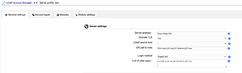

@stephdl I’m still trying to find the cause of the problems, but I can’t fix them because I’m not a developer.

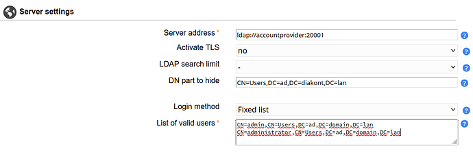

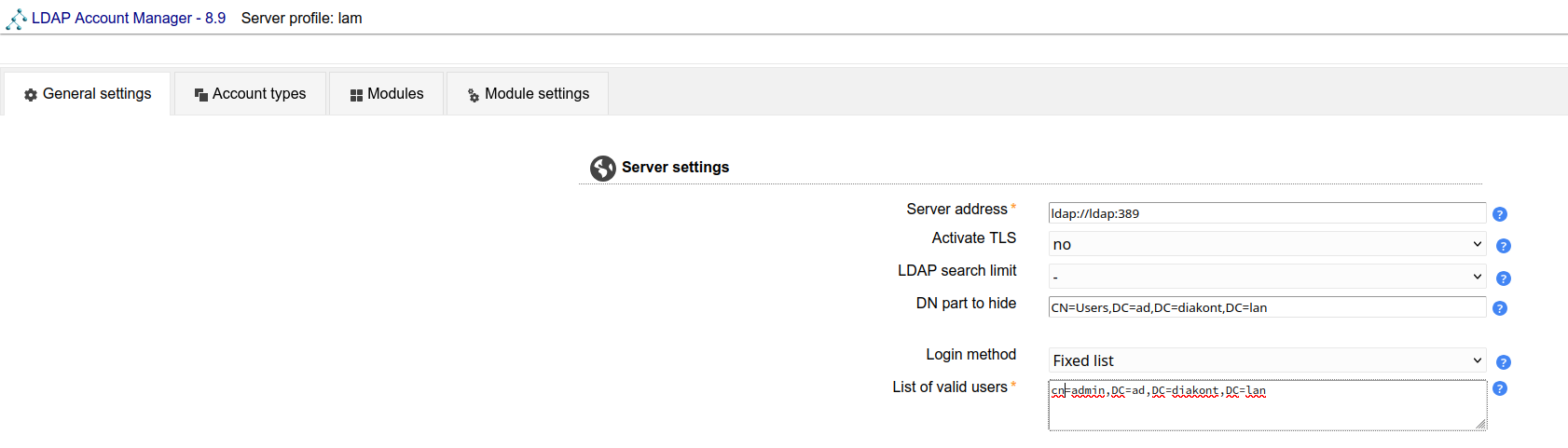

I experienced the following after the last LAM update: when entering LAM configuration, Edit server profiles, the LAM password was reset to the default “lam” and at the same time, after entering, I experienced the following change under Edit server profiles:
The image shows that the Server Address has changed during the update. The previous, correct entry was ldap://accountprovider:20001.
The List of valid users has also changed, the previously specified administrator user has disappeared. However, the entry is missing the CN=Users entry. The correct entry was the following:
By manually changing the settings, both the admin and administrator users can log in to LAM with the password set before the update. This setting and the default LAM password are reset every time the NS8 is restarted.
When I logged into the LDAP Account Manager and checked the domain users, the configured username and email address (ilus.bac@diakont.lan) did not change, but it is still not possible to log in to SOGo with the custom settings, but only with the default username (bacilus).
The reason for this is that the /home/sogo1/.config/templates/sogo.conf.local file was created during the updates to manage the custom configuration, but despite the changes made to this file, the contents of the /home/sogo1/.config/state/sogo.conf file are generated from the default /home/sogo1/.config/templates/sogo.conf and the settings in the /home/sogo1/.config/templates/sogo.conf.local file are ignored when SOGo or NS8 is restarted.
How can the above problems be solved? With such problems, Nethserver 8 cannot be reliably operated as a virtual server on a server farm…
Thanks for your help

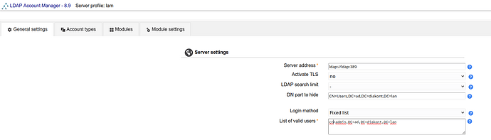

in January I installed a new NS8 based on Debian and running on Proxmox.
I configured LAM and SOGo so that the main users can log in with their email address.
It worked until now but today I updated SOGo and from now on no user can log in with either email address or username.
The LAM Server configuration has been overwritten as shown in the image.
Az eredeti beállítások az alábbiak voltak:
I changed the LAM Server settings and checked the LADP settings, but users still can’t log in.
Why is this setting being overwritten and will it ever be fixed or will it remain like this?
Thanks

I think the issue was that you had overwritten the sogo.conf file with cron.conf:
@mrmarkuz
Thank you for your answer. Unfortunately, this is not the problem. This was previously fixed by @stephdl and the sogo config files are in fine.

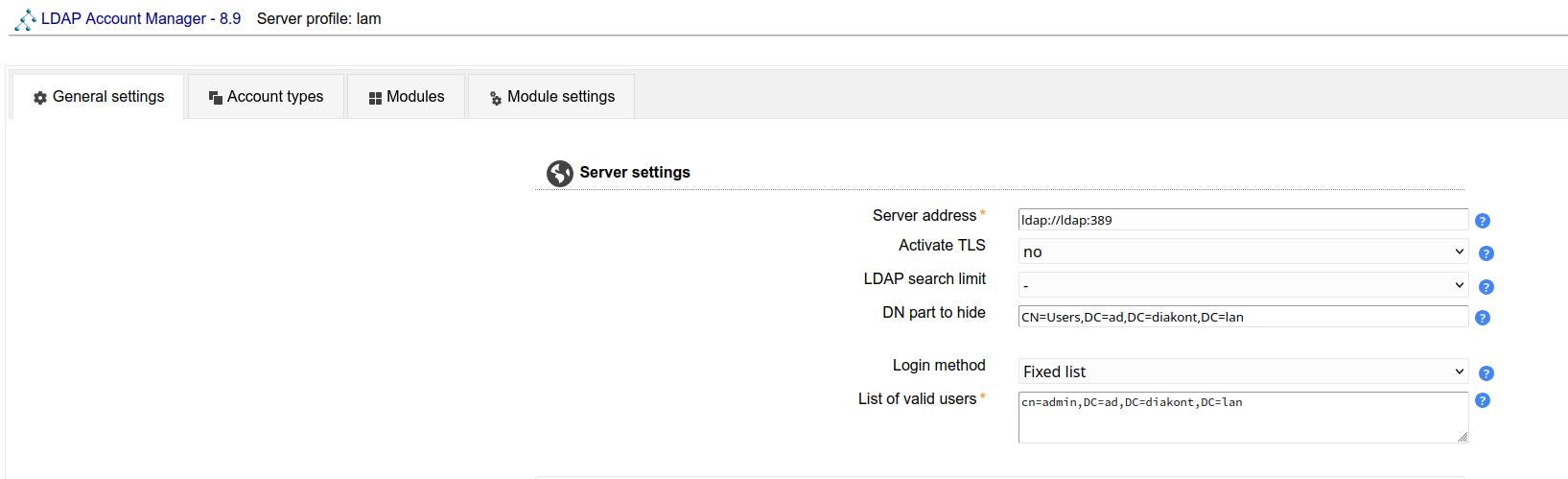

The current problem occurs after every SOGo update. After an update, the LAM module loses its LDAP settings and changes to some unknown default value. This can be seen in the image in the post above, and in the one below, the parameters I previously set.
The current problem occurs after every SOGo update. After the update, the LAM module loses the LDAP settings and changes to some unknown default value. This can be seen in the image in the post above, and in the one below with the parameters I previously set.
I don’t understand why after the SOGo update the Server address in the image is set to ldap://ldap:389, when in the case of NS8 it is Server address ldap://accountprovider:2001.
In this case, only uninstalling and reinstalling the LAM module helps, but then you have to reconfigure it.
Couldn’t this error be fixed? Thanks for the help, I hope someone can solve it…

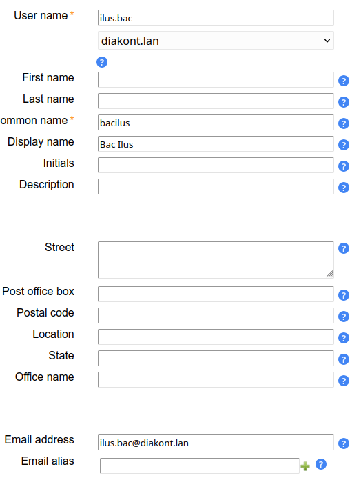

I uninstalled and reinstalled the LAM module from the command line. The LDAP settings are unchanged, but users are still unable to log in to SOGo or Roundcubemail with either their username or email address.
This is what an LDAP entry for one user looks like:

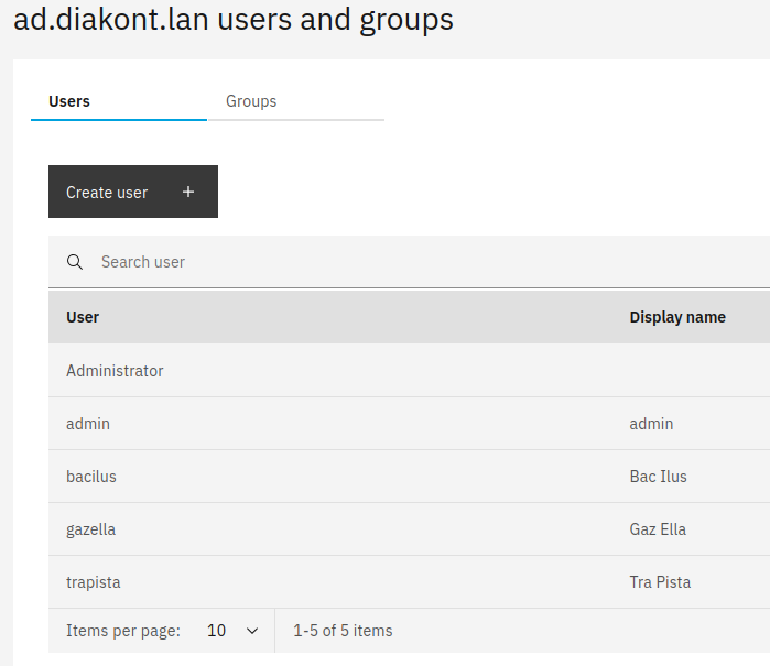

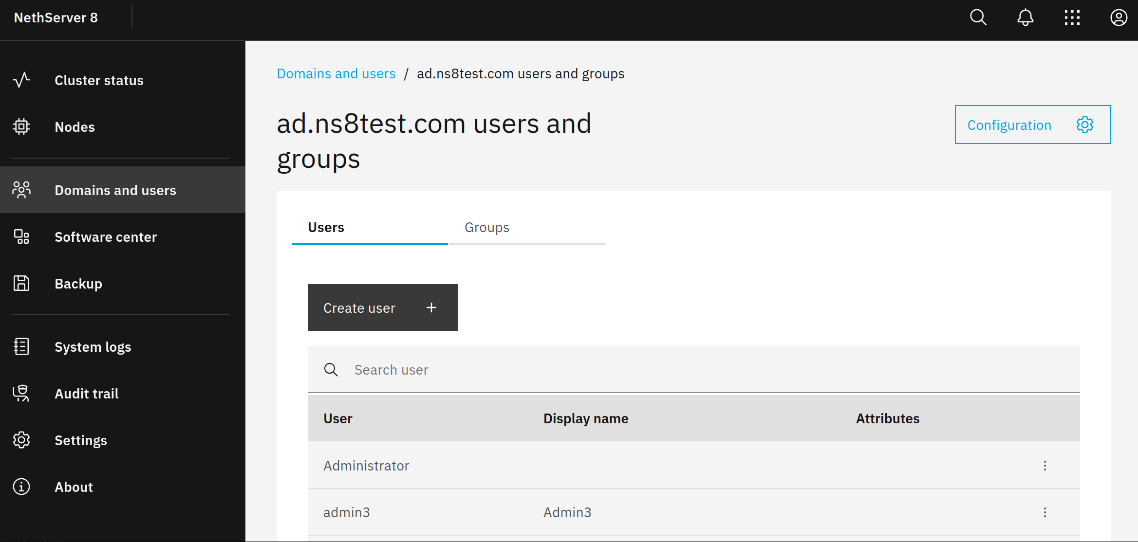

The users are listed under Domain and Users under Users and Groups as shown in the image.

I think you missed the samaccountname:
But this doesn’t explain the roundcube issues.
And it seems the password is expired:
@mrmarkuz
Unbelievable! The user’s password has expired. Fortunately, this is a test environment and does not cause any other problems…
The default password policy played a trick on me. I turned it off, it is no longer needed.
Unfortunately, the user cannot log in to Roundcubemail. Maybe Roundcubemail should be customized as well?
In principle, the samaccountname is not necessary, it was not there under NS7 either. I copied that config under NS8 SOGo. Is this necessary?
