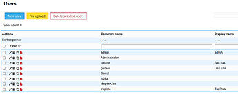

To my surprise, two or three new users appeared in the account list.
You have not shown these three users before. Has the lam config been changed and does it now display deactivated users?
Although I can’t find a setting for this. Is there a problem with the update? And will this be the problem next time?
How could this be found out?
Thank you for your help.
You are showing us an active directory ldap account provider
Previously it was an openldap provider I showed you IIRC
I’m sorry, but I don’t understand what you mean.
After installing ns8, I created a Samba AD/LDAP domain controller for testing and have been using it ever since.
Sorry, but maybe I was misunderstood?
Guest and krbtgt are default AD users, they are not there if OpenLDAP is used.
ldapservice is the NethServer default user to connect/join to OpenLDAP or Samba AD.
