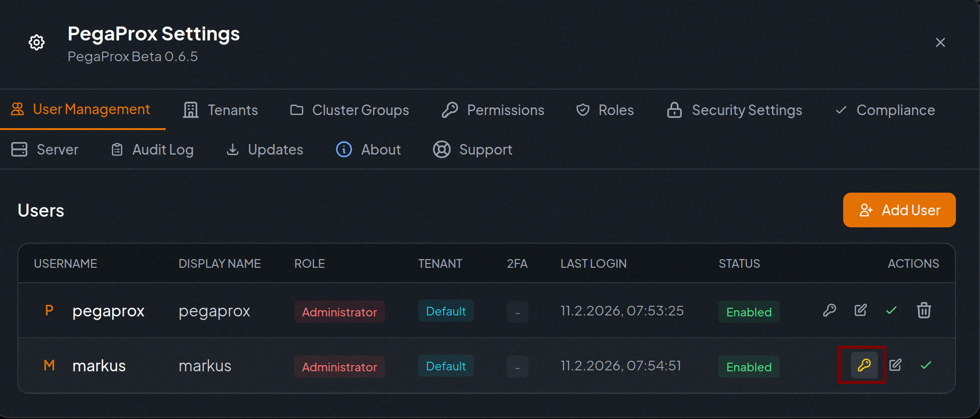

  1. Reset of the default user pegaprox is not possible. The new password has not been saved. There is no error message.
  2. new users in settinges --> unser management --> add user cannot be created.

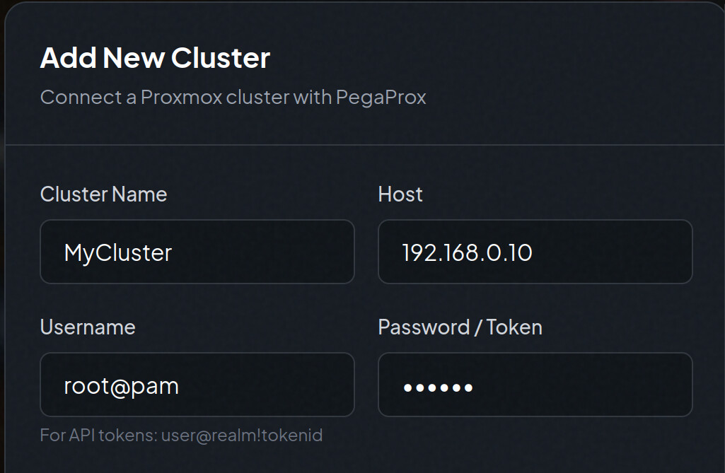

  3. Adding a cluster ist also not possible, because the root credentials are nor acepted. The error messsage is Unauthorized.
    I used the exisiting root user.

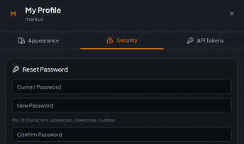

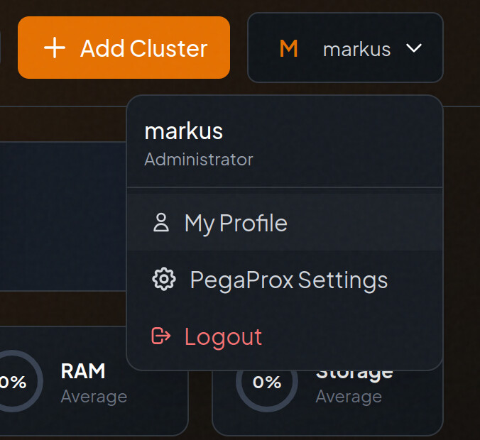

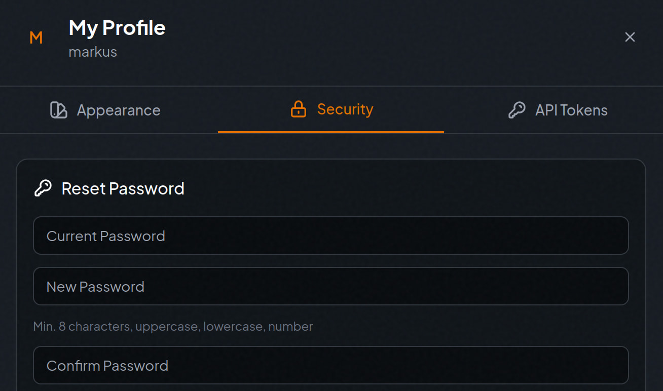

The password can be changed via “My profile”…
…or in the user settings:
The default username to connect to a node should be root@pam:
It has it’s own user account management.

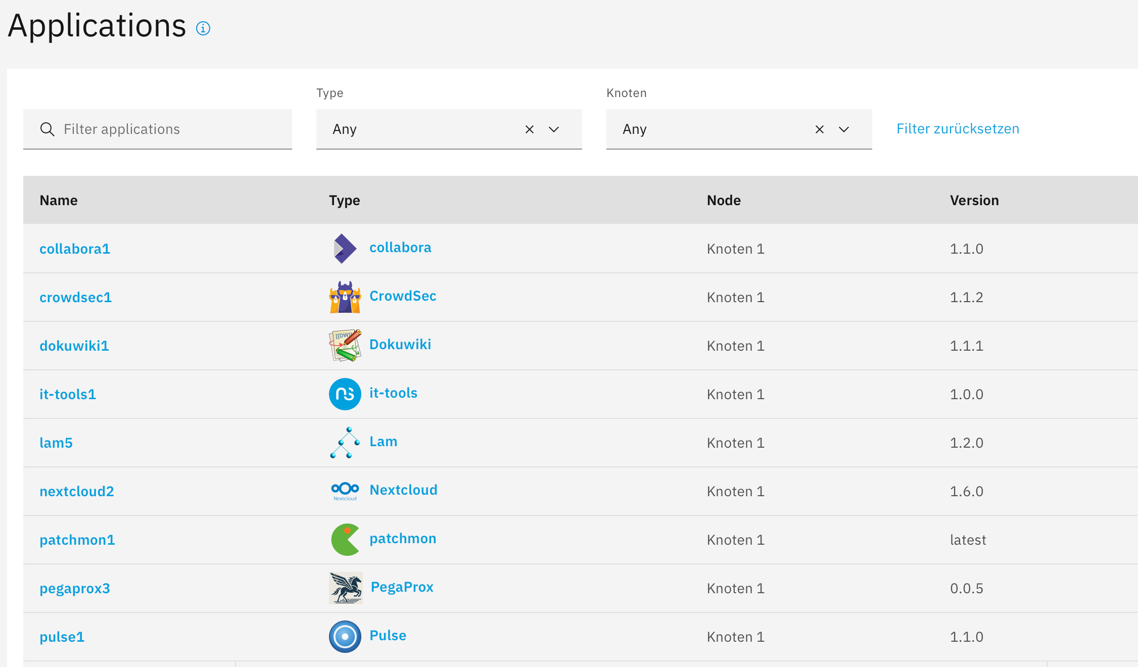

my installed moduls:
..and additional SAMBA, not shown in the applications list.

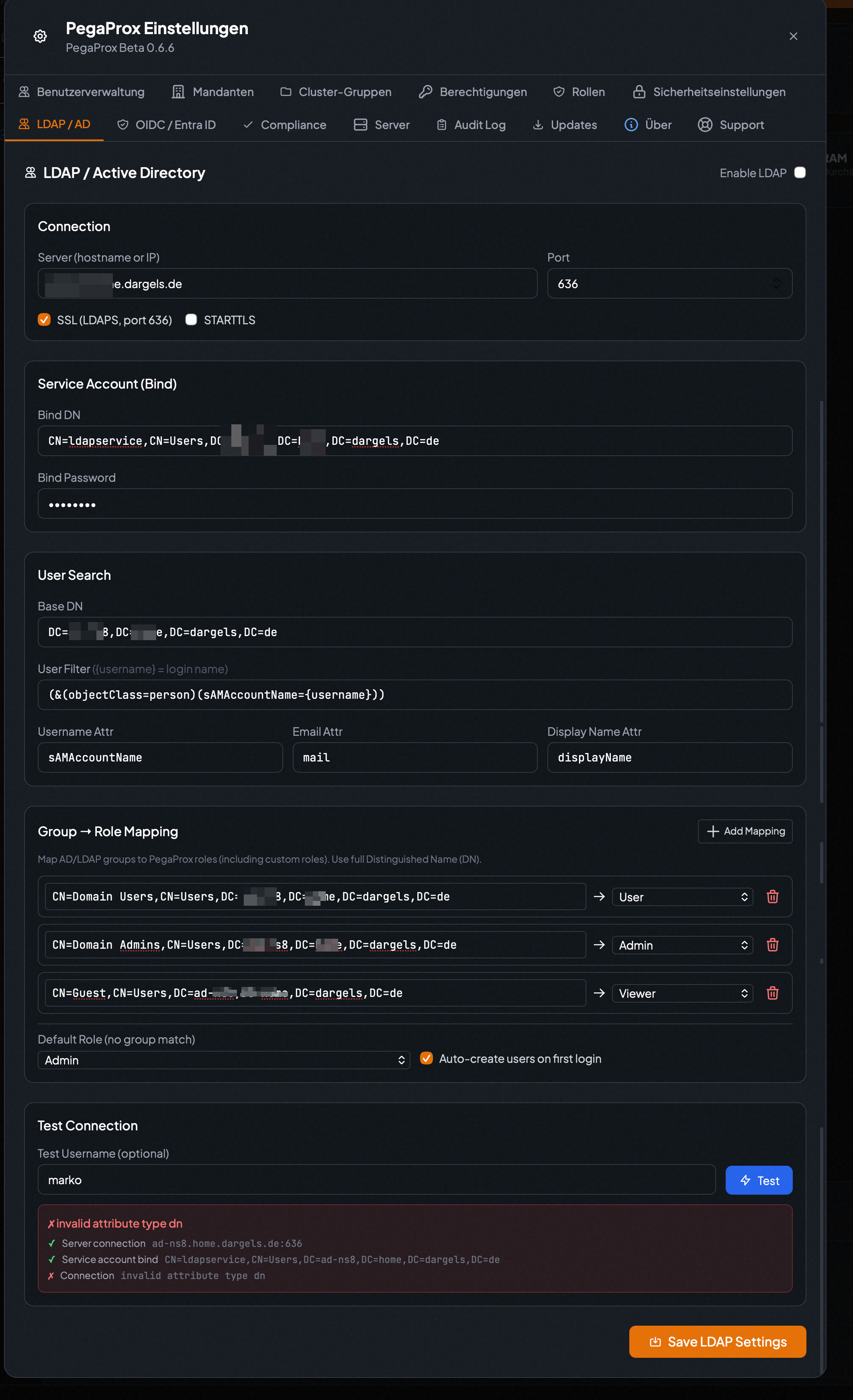

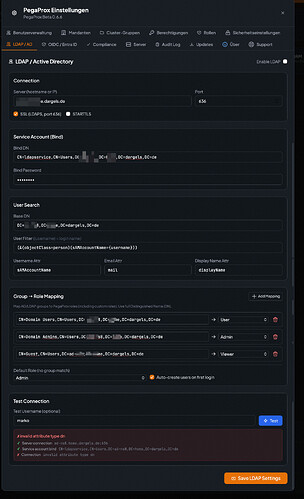

The AD/LDAP integration test results in an error that I cannot interpret.
Apparently, the ‘DN’ attribute cannot be found.
✗ invalid attribute type dn
✓ Server connection XYZ.dargels.de:636
✓ Service account bind CN=ldapservice,CN=Users,DC=XYZ,DC=XYZ,DC=dargels,DC=de
✗ Connection invalid attribute type dn
The change to the classic LDAP syntax for “Bind DN” instead of ldapservice@XYZ.XYZ.dargels.de has no effect.
How could I proceed now?
P.s:
The role mapping with DN for users, administrators and viewers has no effect on the error message.
@capote I also tested LDAP/AD auth and ran into the same issue as you.
Then I found this: LDAP Setup fails test with "invalid attribute type dn" · Issue #70 · PegaProx/project-pegaprox · GitHub
Looks like it’s a known issue, so I guess we’ll just wait for a fix :crossed_fingers:
@capote I tried to replicate the password change issue as well. Not sure if it was your case, but I found that it doesn’t work if you access Pegaprox over HTTP instead of HTTPS. Basically, the http2https option in the module configuration should always be enabled — and it will be by default for new installations.

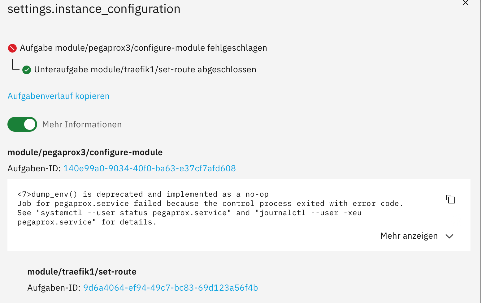

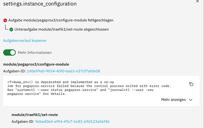

After update: “Bad Gateway”
Restarting does not resolve the issue.
If I tried to save the settings:
<7>dump_env() is deprecated and implemented as a no-op
Job for pegaprox.service failed because the control process exited with error code.
See "systemctl --user status pegaprox.service" and "journalctl --user -xeu pegaprox.service" for details.
026-03-02T09:14:34+01:00 [1:pegaprox3:systemd] pegaprox.service: Scheduled restart job, restart counter is at 4.
2026-03-02T09:14:34+01:00 [1:pegaprox3:systemd] Stopped pegaprox.service - Podman pegaprox.service.
2026-03-02T09:14:34+01:00 [1:pegaprox3:systemd] Starting pegaprox.service - Podman pegaprox.service...
2026-03-02T09:14:34+01:00 [1:pegaprox3:systemd] Created slice user-libpod_pod_8f335b2e313578d79e8f5e8c0873e44f3e41d308bf84463ac165b834a2a3ef09.slice - cgroup user-libpod_pod_8f335b2e313578d79e8f5e8c0873e44f3e41d308bf84463ac165b834a2a3ef09.slice.
2026-03-02T09:14:34+01:00 [1:pegaprox3:podman]
2026-03-02T09:14:34+01:00 [1:pegaprox3:podman] 2026-03-02 09:14:34.331136319 +0100 CET m=+0.100711361 container create e7bd77863e61a95a05af01b791d14dd136d30d9cf063341fd34a2ad06f557d71 (image=localhost/podman-pause:4.3.1-0, name=8f335b2e3135-infra, pod_id=8f335b2e313578d79e8f5e8c0873e44f3e41d308bf84463ac165b834a2a3ef09, io.buildah.version=1.28.2, PODMAN_SYSTEMD_UNIT=pegaprox.service)
2026-03-02T09:14:34+01:00 [1:pegaprox3:podman] 2026-03-02 09:14:34.338667351 +0100 CET m=+0.108242395 pod create 8f335b2e313578d79e8f5e8c0873e44f3e41d308bf84463ac165b834a2a3ef09 (image=, name=pegaprox)
2026-03-02T09:14:34+01:00 [1:pegaprox3:podman] 8f335b2e313578d79e8f5e8c0873e44f3e41d308bf84463ac165b834a2a3ef09
2026-03-02T09:14:37+01:00 [1:pegaprox3:podman] Error: starting container e7bd77863e61a95a05af01b791d14dd136d30d9cf063341fd34a2ad06f557d71: rootlessport listen tcp 0.0.0.0:445: bind: address already in use
2026-03-02T09:14:37+01:00 [1:pegaprox3:systemd] pegaprox.service: Control process exited, code=exited, status=125/n/a
2026-03-02T09:14:37+01:00 [1:pegaprox3:podman] 2026-03-02 09:14:37.647266228 +0100 CET m=+0.123648736 container remove e7bd77863e61a95a05af01b791d14dd136d30d9cf063341fd34a2ad06f557d71 (image=localhost/podman-pause:4.3.1-0, name=8f335b2e3135-infra, pod_id=8f335b2e313578d79e8f5e8c0873e44f3e41d308bf84463ac165b834a2a3ef09, PODMAN_SYSTEMD_UNIT=pegaprox.service, io.buildah.version=1.28.2)
2026-03-02T09:14:37+01:00 [1:pegaprox3:systemd] Removed slice user-libpod_pod_8f335b2e313578d79e8f5e8c0873e44f3e41d308bf84463ac165b834a2a3ef09.slice - cgroup user-libpod_pod_8f335b2e313578d79e8f5e8c0873e44f3e41d308bf84463ac165b834a2a3ef09.slice.
2026-03-02T09:14:37+01:00 [1:pegaprox3:podman] 2026-03-02 09:14:37.663939597 +0100 CET m=+0.140322115 pod remove 8f335b2e313578d79e8f5e8c0873e44f3e41d308bf84463ac165b834a2a3ef09 (image=, name=pegaprox)
2026-03-02T09:14:37+01:00 [1:pegaprox3:podman] 8f335b2e313578d79e8f5e8c0873e44f3e41d308bf84463ac165b834a2a3ef09
2026-03-02T09:14:37+01:00 [1:pegaprox3:systemd] pegaprox.service: Failed with result 'exit-code'.
2026-03-02T09:14:37+01:00 [1:pegaprox3:systemd] Failed to start pegaprox.service - Podman pegaprox.service.
2026-03-02T09:14:37+01:00 [1:pegaprox3:systemd] Dependency failed for pegaprox-app.service - Podman  pegaprox-app.service.
2026-03-02T09:14:37+01:00 [1:pegaprox3:systemd] pegaprox-app.service: Job pegaprox-app.service/start failed with result 'dependency'.
