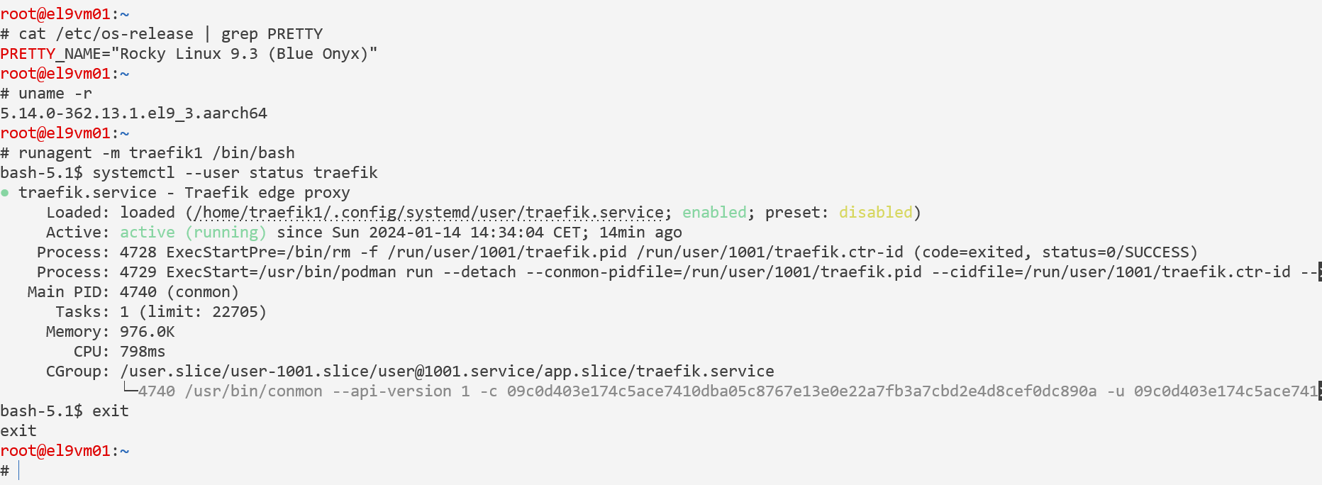

in a test venv it succsed:
(311) root@el9vm01:/opt/venv/311

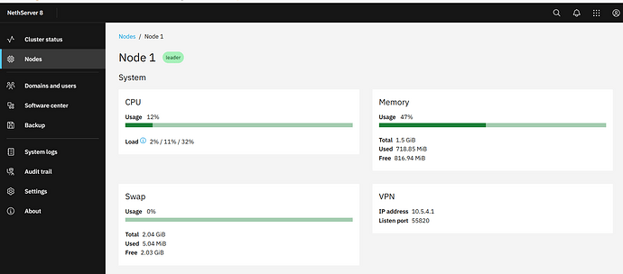

Success on rocky el9 after installing gcc and python3.11-devel.
patched line 59 of install.sh preventing using ns-mirrors:
ns8-core with 1 (leader) node is up:
kudos @Tbaile and @davidep
