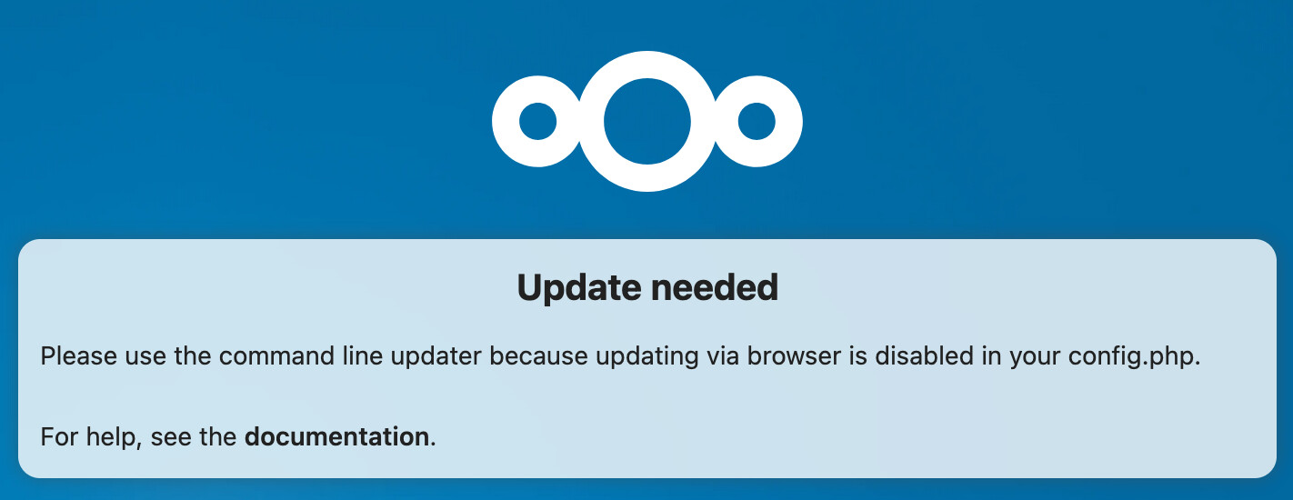

Today while logged into Nextcloud as Admin, I saw that two apps needed updating (Contacts, Libresign). So I did the update and ended with this result:
Huh?? What’s this about?

Nextcloud or one of the apps require upgrade - only a limited number of commands are available
You may use your browser or the occ upgrade command to do the upgrade
OK but there aren’t any apps needing updating ???
Could it be that the Nextcloud contain needs an update? Nope it is at 1.4.3
So perhaps Nextcloud itself?
occ --version
Cloud 30.0.10
As far as I know this is right also. So totally confused.

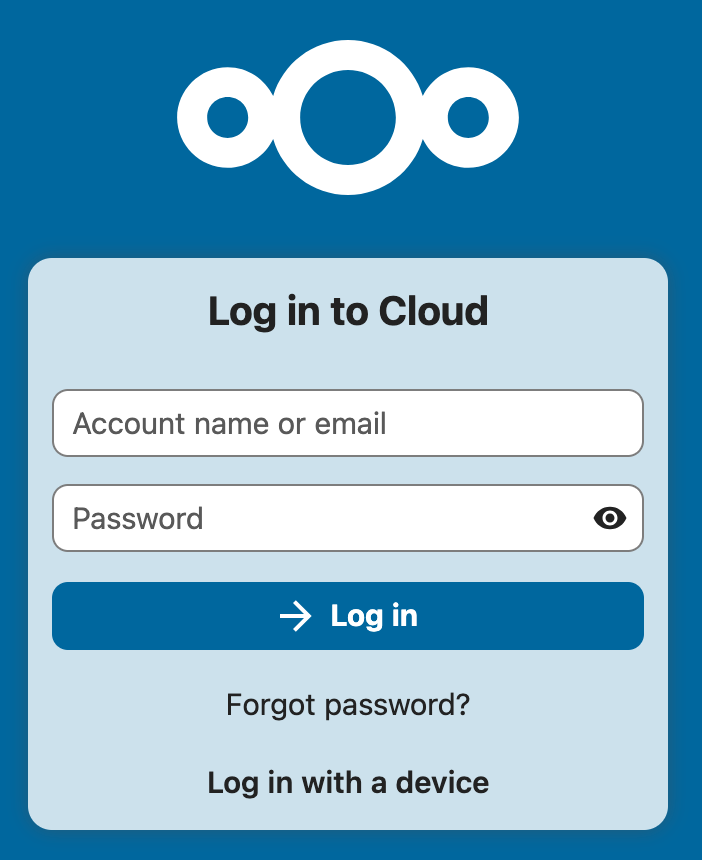

occ maintenance:mode --off
Wow, back to normal.
