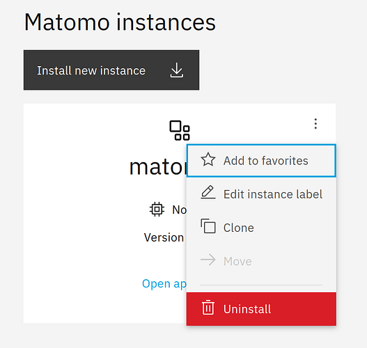

Must be possible to remove the app instance from UI (3-dots menu → uninstall, at least it was possible few months back) or command line:
Ah, yes–specifically, pull up the “instances” page of the app in question, then you get the kebab menu. I hadn’t seen it previously because I’d expected to see with app settings and such.
But in this case, since this module doesn’t show up in the software center, it would need to be at the CLI–but good to know there’s a way to do that as well.
AFAIK it should show up when clicking ‘the dots matrix’ in the upper right corner next to the bell of software center.
The module does show up there. But I don’t see a way to get to an “instances” page like this one:
…where I can click on the kebab menu for the instance in question and delete it (or clone it, if I wanted to do that).
I noticed that the repo URL https://forge.genius.ke/ns8/updates/ is not reachable.
The app repo needs to be available to show the apps in the Software Center and to be able to uninstall them from there.
After adding a new repo using the URL https://raw.githubusercontent.com/geniusdynamics/ns8-genforge/repomd/ns8/updates/ it should be possible to uninstall Matomo via Software Center:
The repo URLs are documented in the Wiki: ns8:geniusdynamics_repository [NethServer & NethSecurity]
Interesting, and thanks for the wiki pointer–I probably need to spend some time digging around there. Once I add the repo, I see the app as available, but it doesn’t seem to recognize that it’s already installed–I get an “Install” button for it, not an “instances” button.
Yeah, thanks to @LayLow the wiki got refreshed and provides a list of NS8 apps and much more.
Maybe it’s seen as a different repo. It could help to remove the app from CLI and reinstall it via Software Center.
