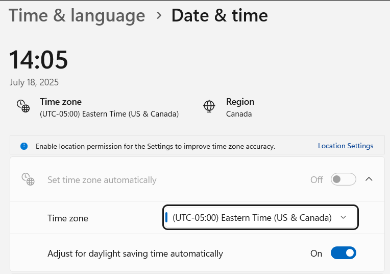

Yes, that makes sense because I’ve seen this “Reykjavik” show up before on Windows. But in this case the time, date and timezone are correct on the device.

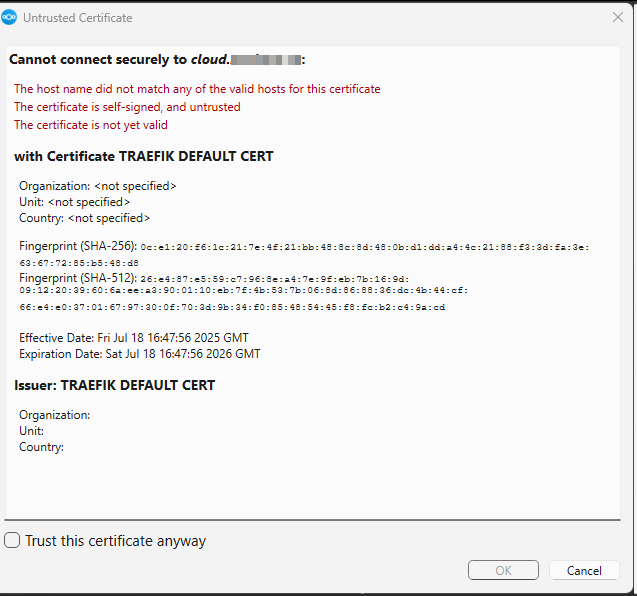

When I went to cloud.domain.tld it pushed this:

Now I have to look into why the certificate is acting up.
