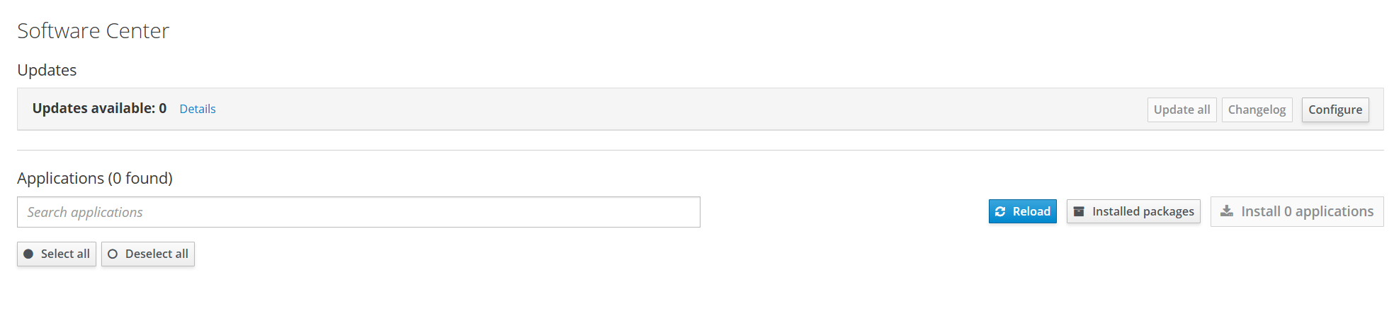

So I uninstalled the NS8 Migration tool from my NS7 server, and nothing shows up in my Software Center to be able to reinstall. Do I have to do it manually?

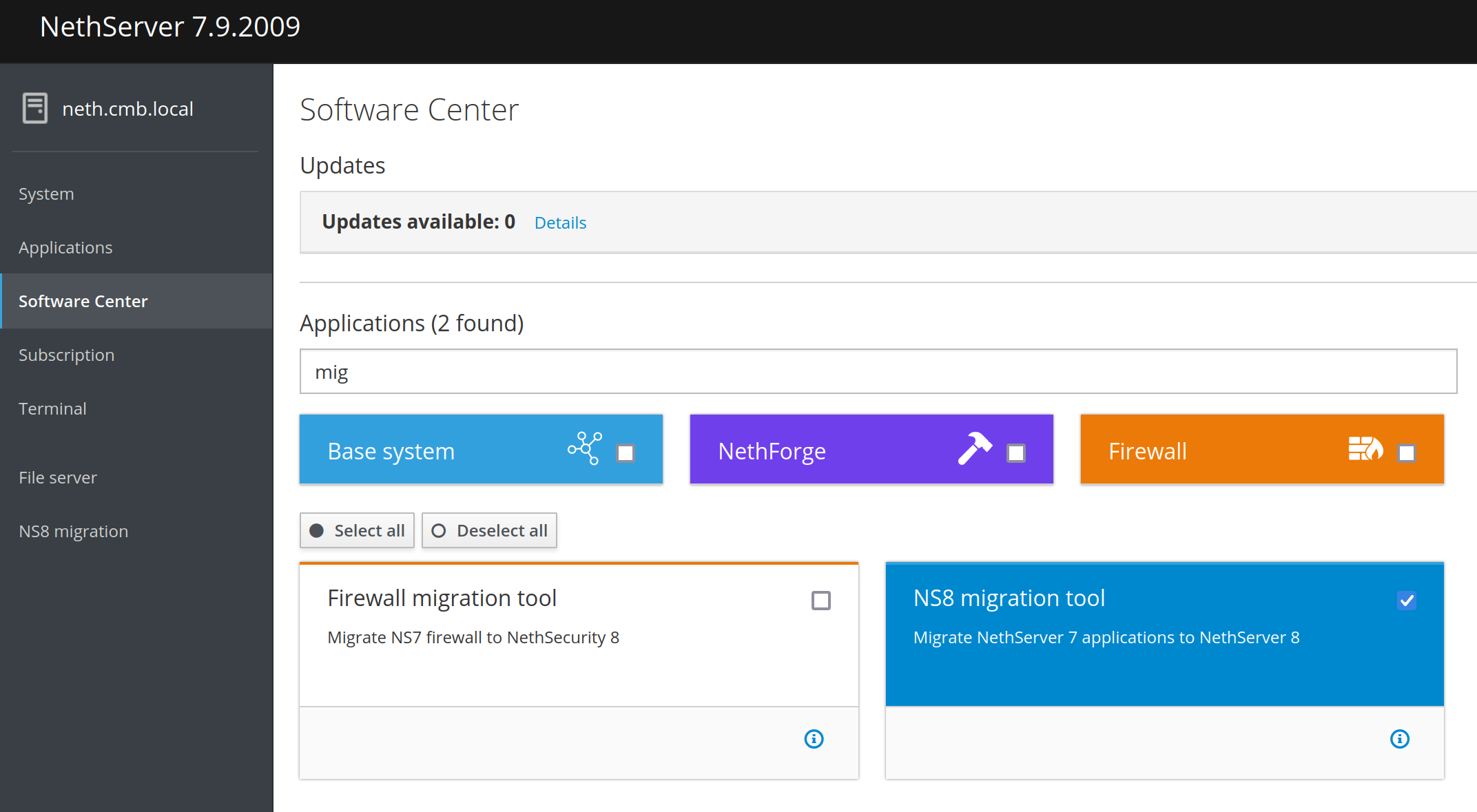

It should be shown as available app in Software Center:
Maybe you need to reload the Software Center page or remove the migration tool on CLI:

Weird, I don’t see the selection boxes for the repos. How do I get them back?
