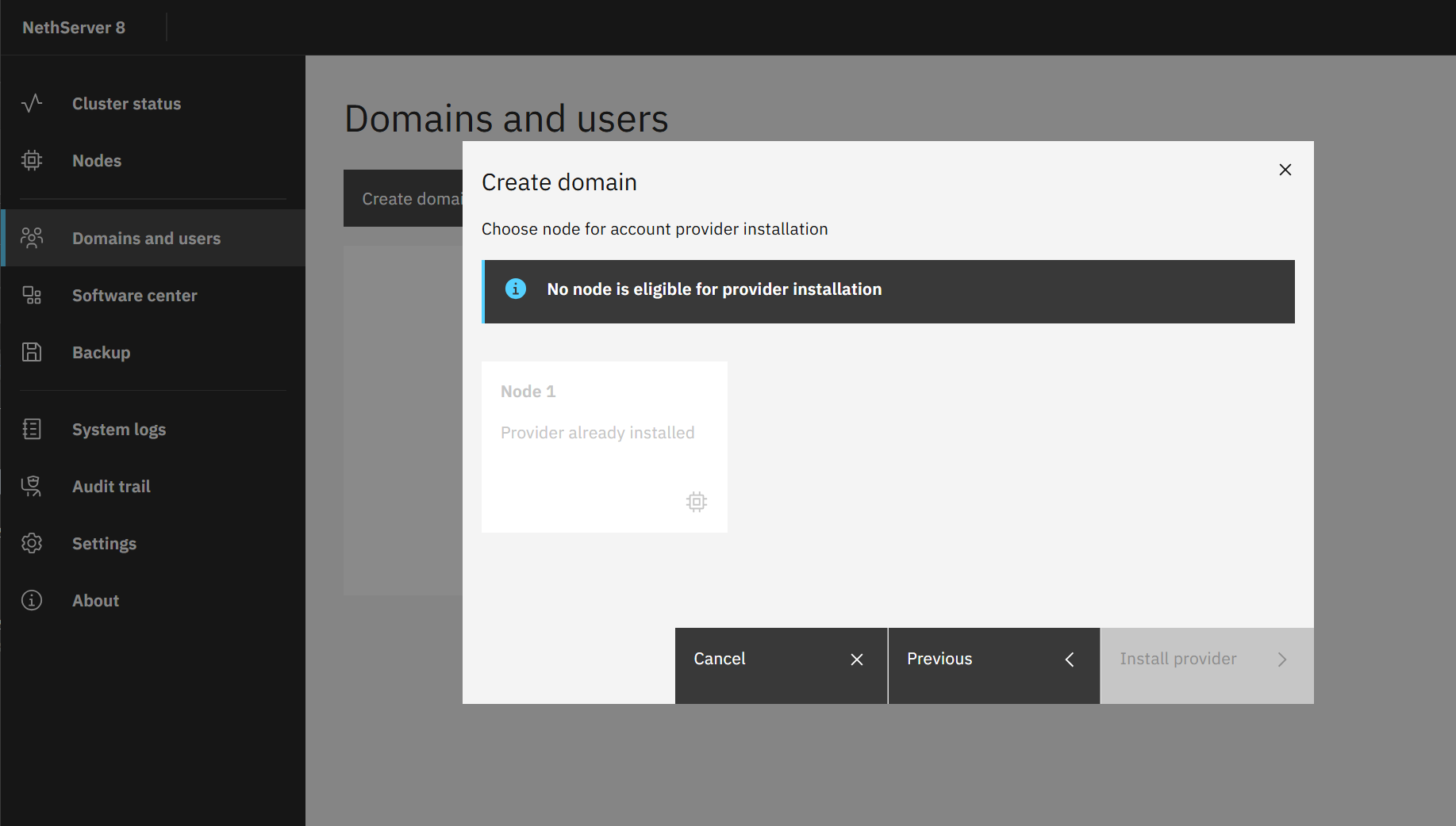

First issue found - adding a second provider (for a new samba service) error, “No node eligible for provider installation”

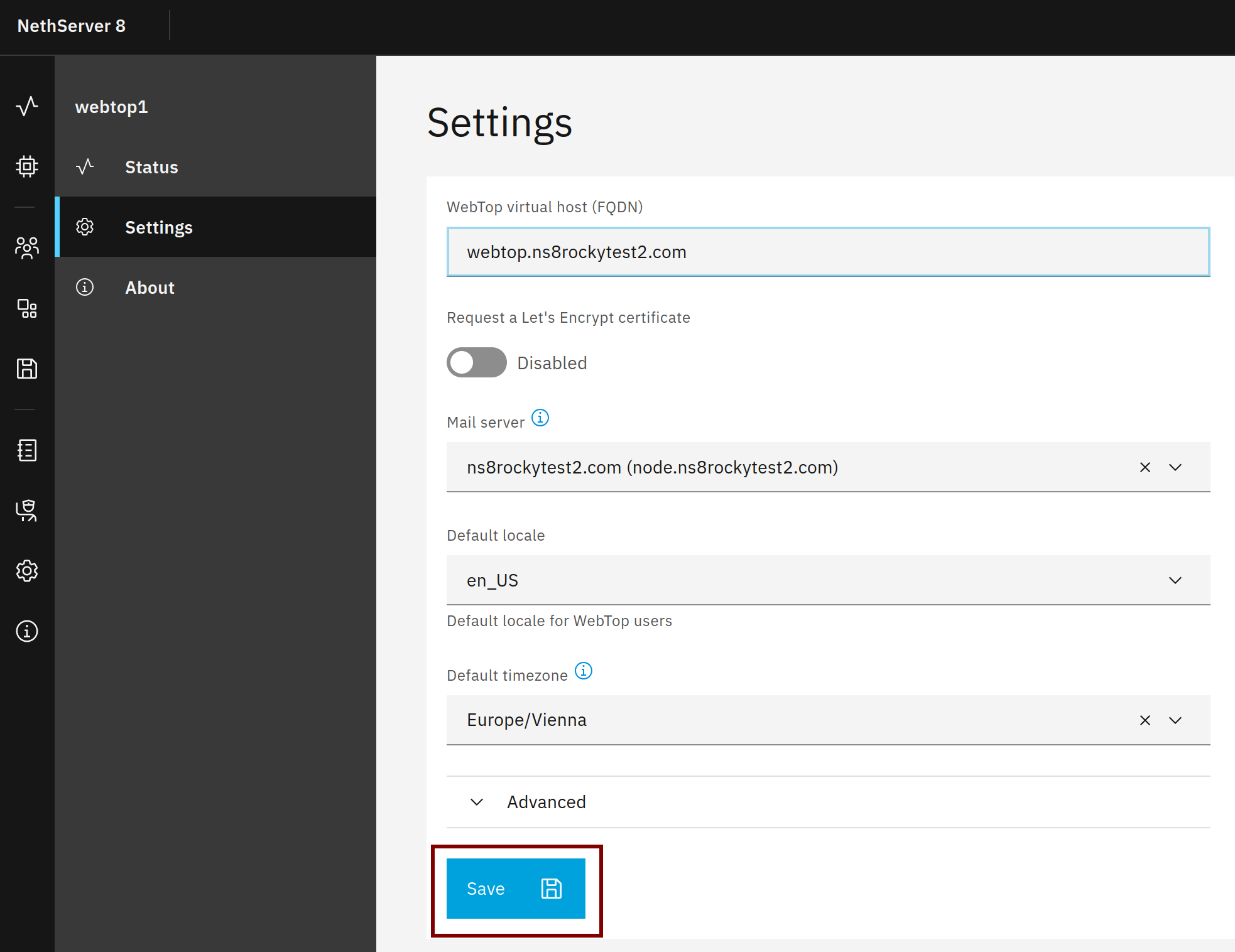

Did you try to save the Webtop app settings in the cluster-admin to reconfigure the app?

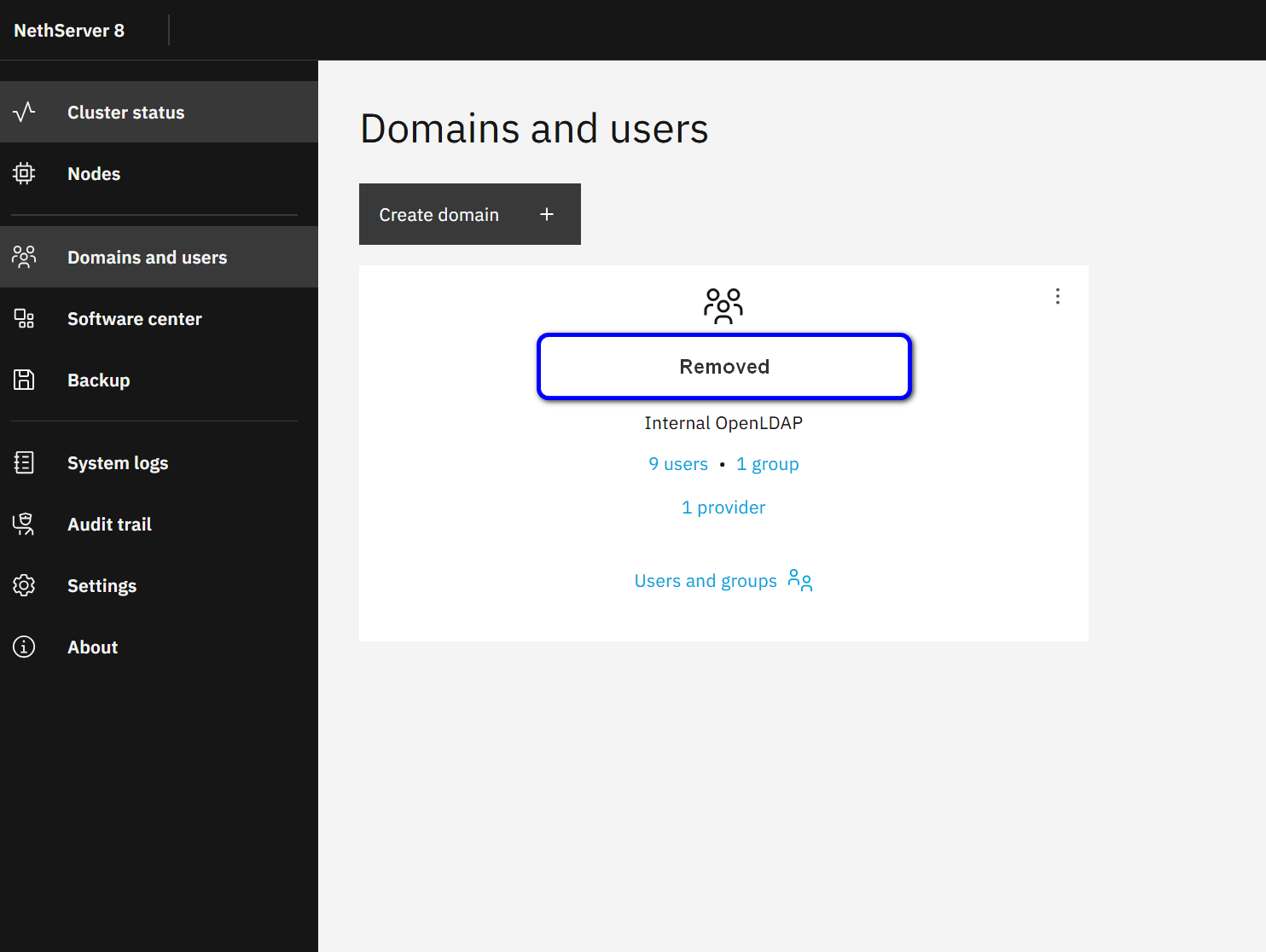

I am just trying to add what would be the node’s only samba instance, like I have on other sites. The node has one OpenLDAP service, or have I messed something up?
Below is a picture before starting installation of samba ad -
Error after attempt to install the node’s only samba ad -

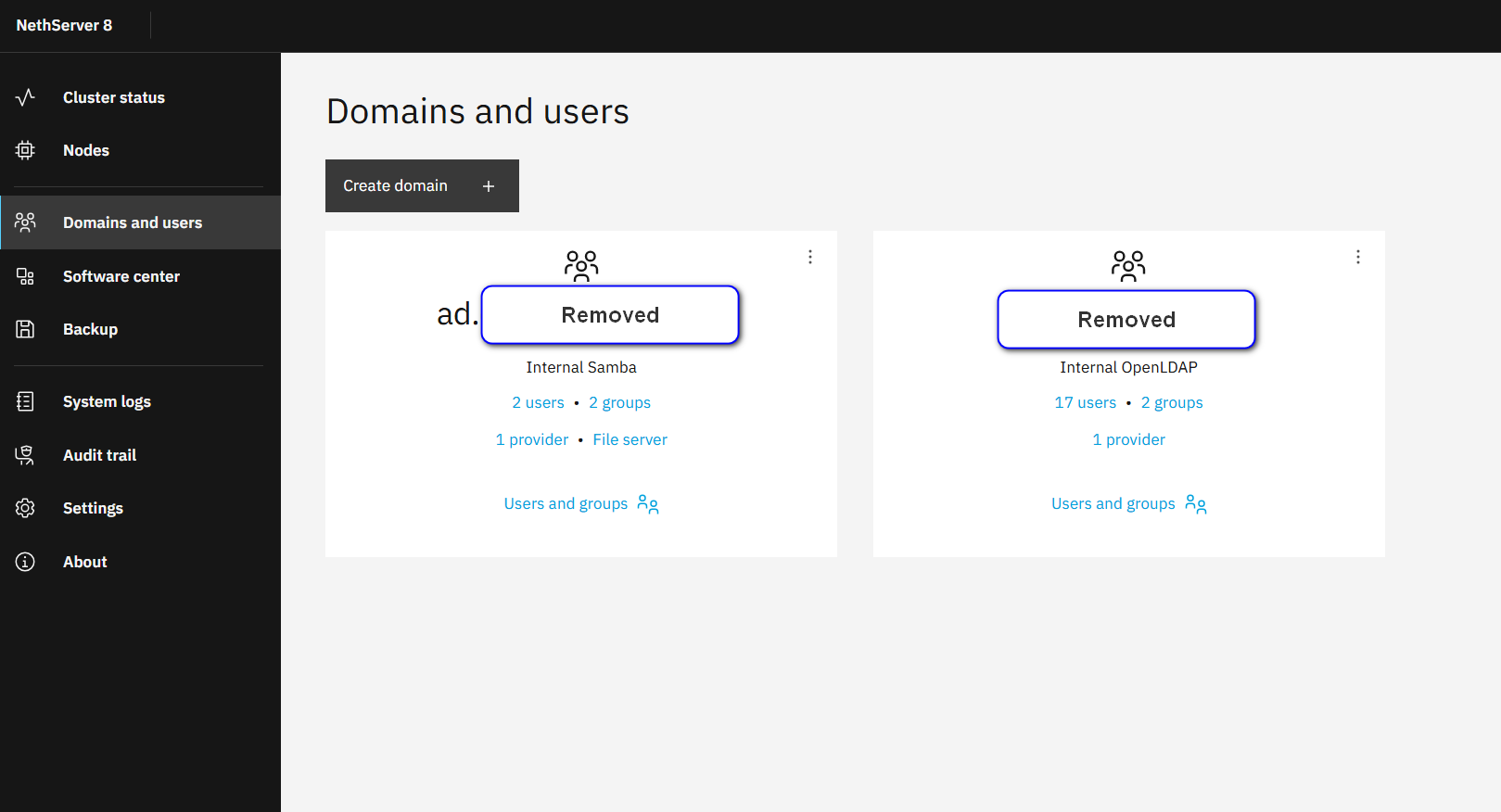

E.g. Reference from another side I have set this up on.

No, just try to check the NS8 Webtop app settings (probably there’s a typo in FQDN) and save the settings once to reconfigure the app.
