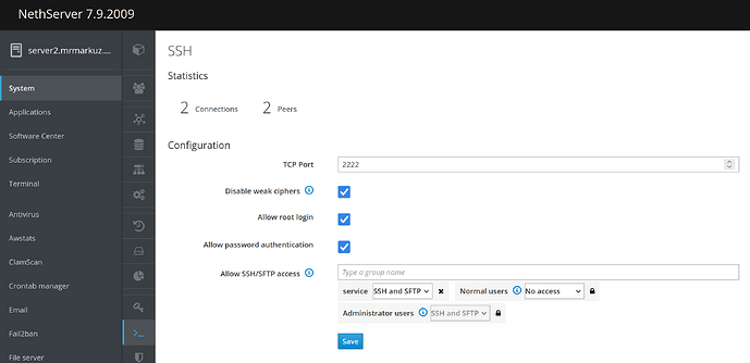

I tested now with an NS7 that has SSH enabled on port 2222 and it works to connect from my mobile from public via 5G using ConnectBot (Android).

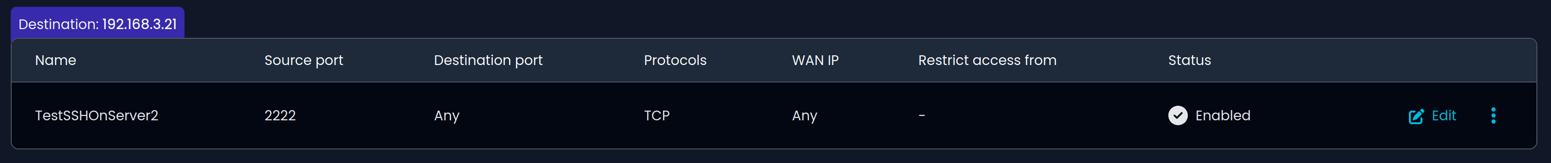

Port forwarding on firewall: (NethSec)

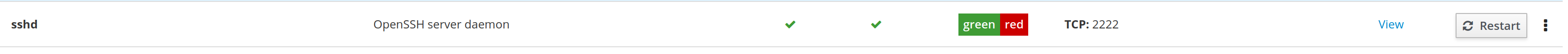

NS7 Services:

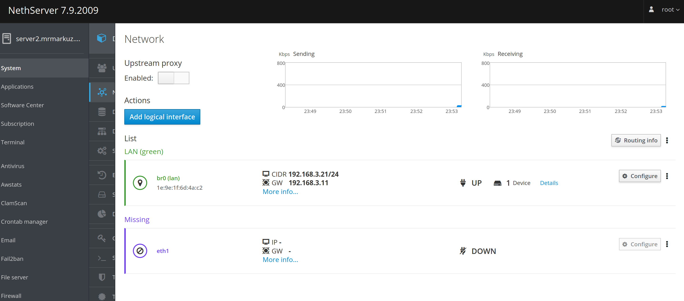

NS7 Network interfaces: (I have a bridge br0 because of samba but that shouldn’t matter)

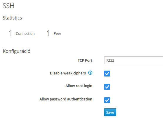

My ssh setup on NS7 looks like this:
sshd config:

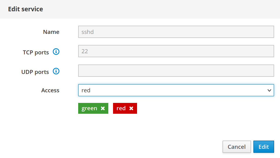

You didn’t enable the access from red in your SSH service.
Instead of access=green it should be access=green,red.
Please enable it…
…so it looks like this:
@mrmarkuz There is no RED interface, so I restricted access to GREEN interface because that was the logical thing to do. I also enabled sshd on RED interface. Now the sshd config looks like this:
