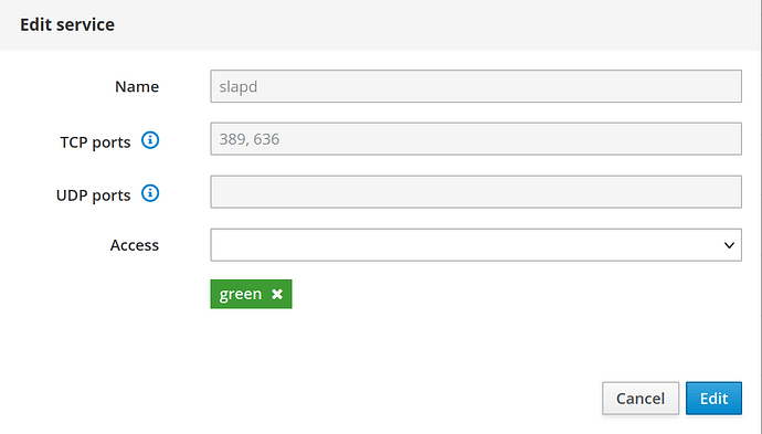

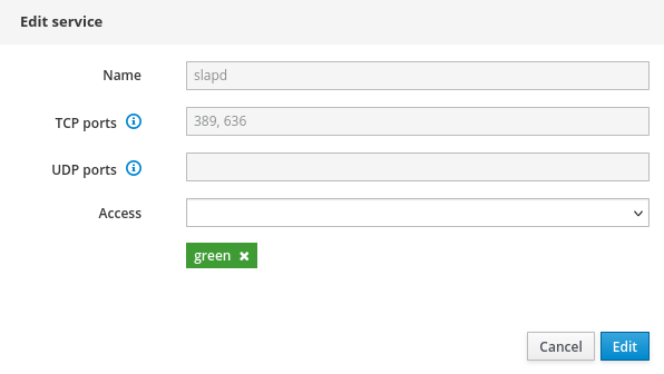

My slapd service only had TCP port 389. I started with Nethserver a long time ago and upgraded along the way. Maybe early versions didn’t include TCP port 636 for slapd?
I looked at the link you provided but it’s not clear to me what I need to do but I’ll try a few things this morning. My slapd edit box looks like below:

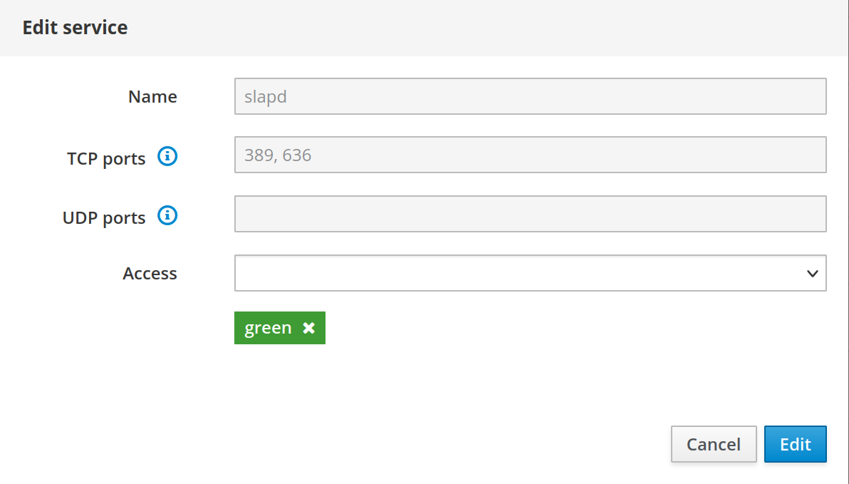

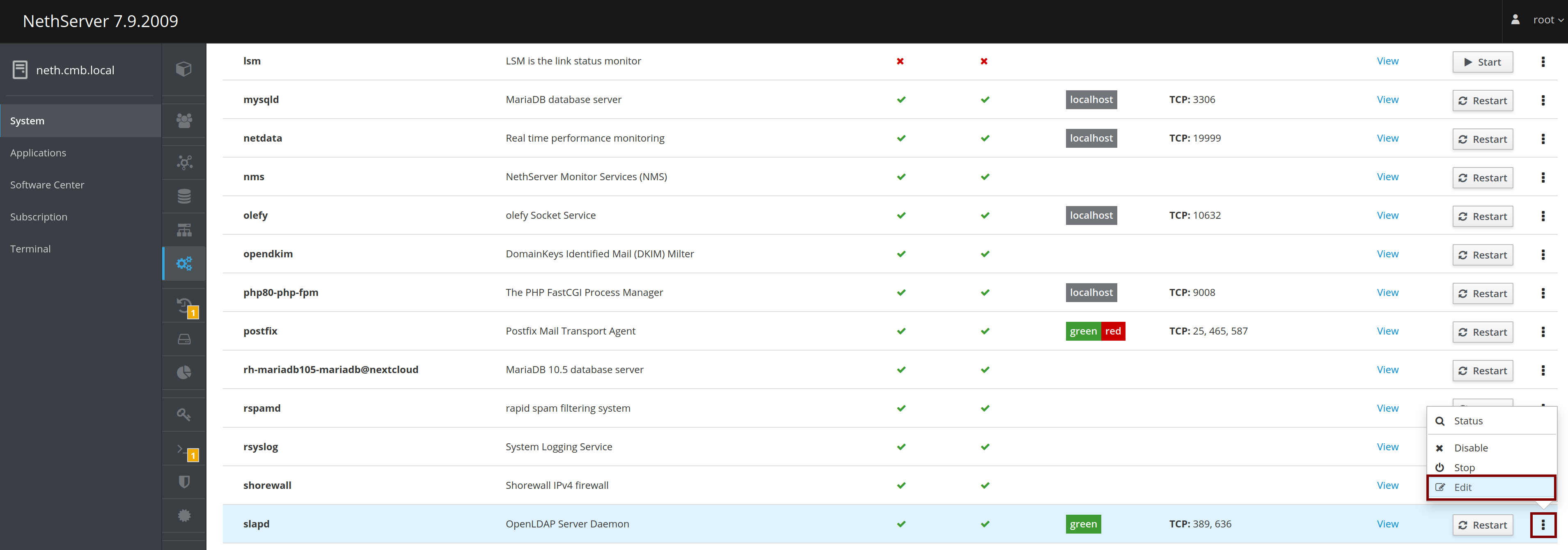

I searched and found some commands which I executed:
config set slapd service status enabled TCPPorts 389,636 access green
signal-event firewall-adjust
Now I have this and I can telnet port 636 so I’ll try migration again:
